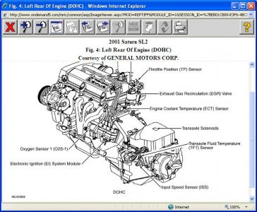

https://images.2carpros.com/forum/automotive_pictures/416332_2001_sl2_coolant_temp_sensor_location_1.jpg
As far as your 2000 SL2 sounds like you need a new coolant temp sensor.When the coolant temp sensor goes bad it alway's read's too cold so when they go bad the temp gauge still work's it just never turn's the fan on when it should and the car over heat's.Replace the coolant temp make sure you get a brass tipped one the plastic tipped one's crack.You will loose coolant also inspect the connector to it if it's corroded you will have to replace that as well.They usually turn green or blue when they corrod.As far the coolant leak goes replace the coolant cap when they over heat they blow the cap.Also see if you can rent a coolant pressure tester so you can find the leak by your intake manifold.Also on that model it's pretty common for the intake manifold gasket to leak coolant around the number 4 cylinder close to where the egr valve is.So what's going on with your 1998 SL2 you never got back to me on the question's I asked you about it.
