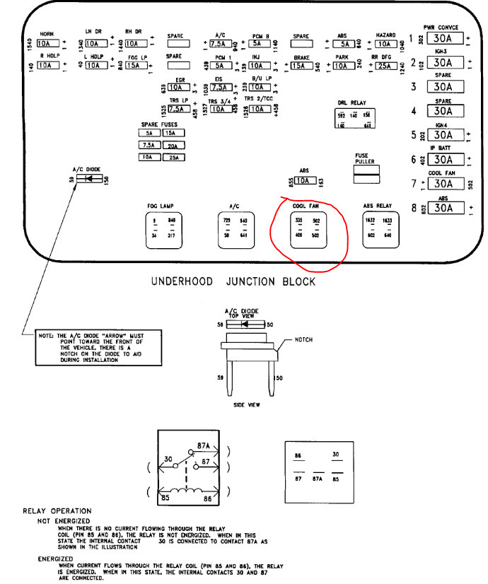

I installed a new fan motor and it still does not come on
Mar 25, 2010 at 8:02 AM
SQM
  • 6,383 POSTS

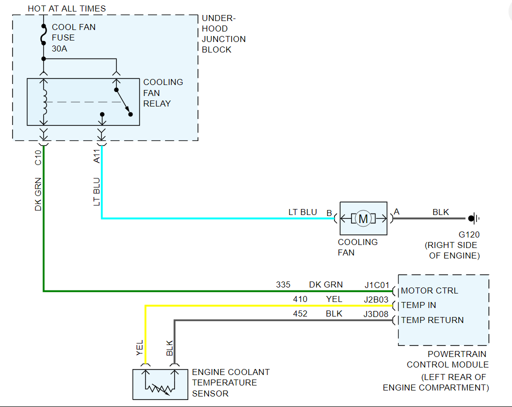

Since you have already replaced the motor. You could have a faulty fan relay or defective wiring.
First you want to check the relay. The relay is located under the hood in the battery junction box (see diagram below).
Here is a article on how to test the relay:

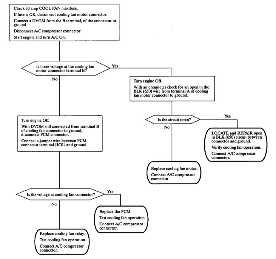

Then you want to check to see if you are getting power to the fan.

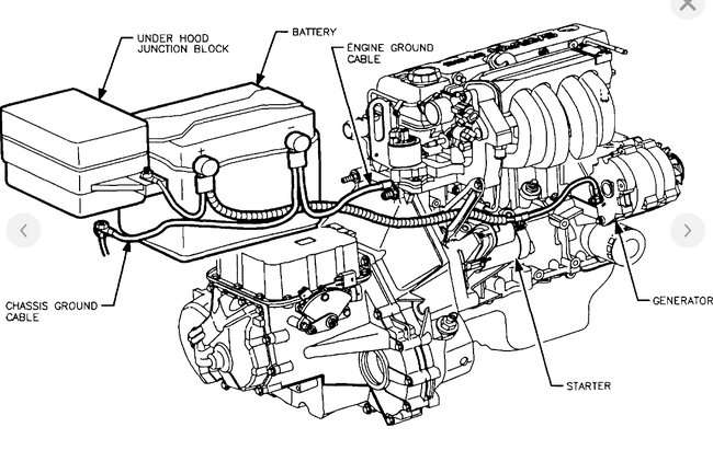

I have attached diagnostics as well as wiring diagrams for your reference.
