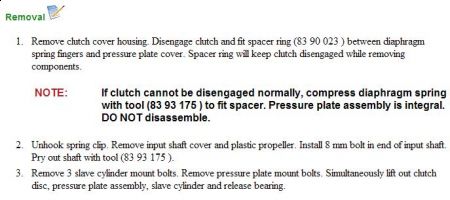

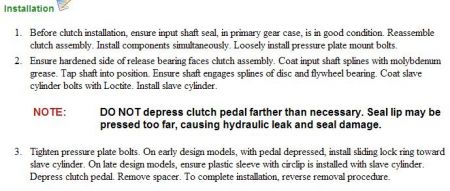

Could you please tell me how to change the cluth slave cylinder and do I need any special tools? I have done and am capable of doing many car repairs. I have replaced head gaskets, clutches, (Not on this car) other components and I own a fair (for an amature) amount of tools.
Jun 4, 2009 at 10:02 PM
BLUELIGHTNIN6
  • 16,542 POSTS
Perform the following operations to replace your vehicle's clutch slave cylinder.
