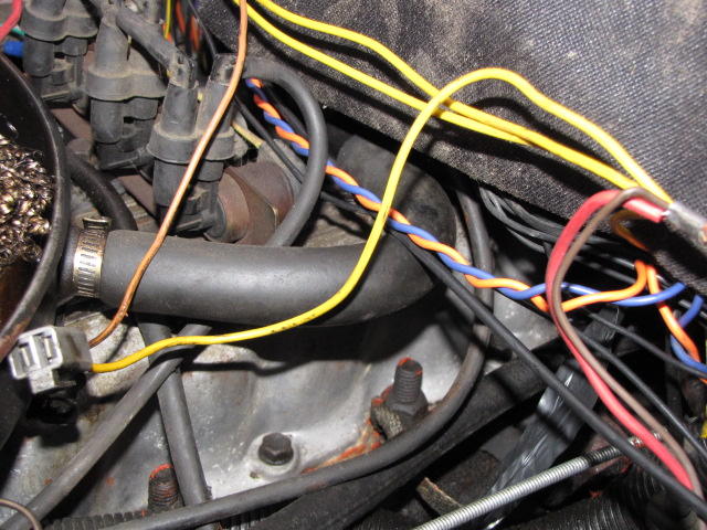

Will try to do pics not to computer savy
Sunday, July 7th, 2013 AT 4:05 PM
DANINROY
  • 24 POSTS

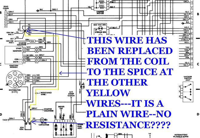

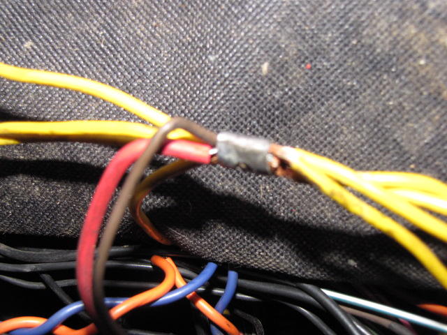

The new wires you see on first pic are from the coil, apperently a mouse chewed the old one and these were a temp fix, until I solder and heat wrap

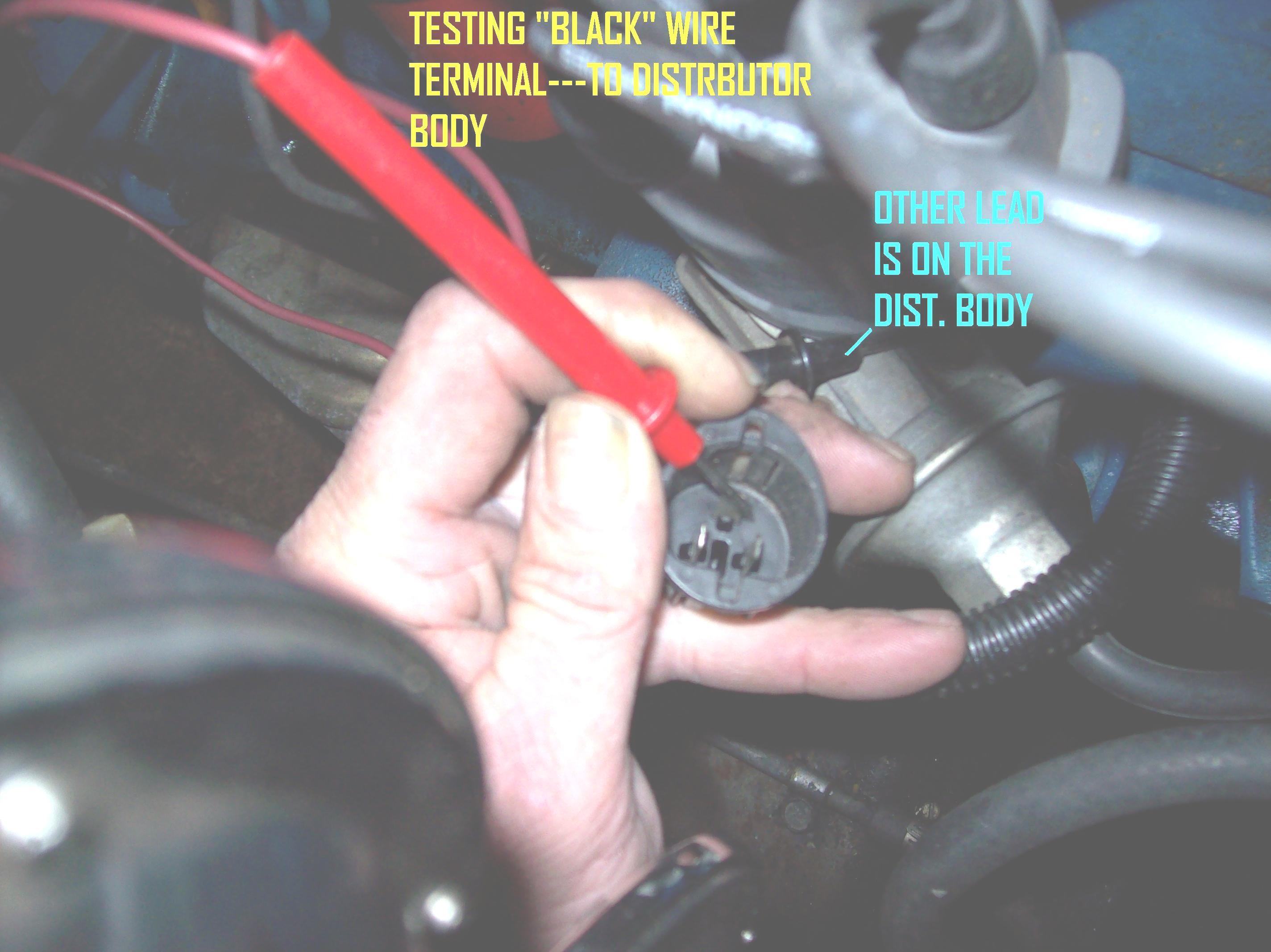

I HAVE A FEW TESTS FOR YOU TO TRY
I WANNA KNOW IF WE LOSE "SPARK" OR "FUEL" DURING THE TIME HE GETS SICK AND WON'T BUST OFF
LETS' LOAD UP A LARGE WET TOWEL AND A FIRE EXTINGUISHERTOWEL IS 1ST LINE OF DEFENSE IN CASE OF A FIRE
NORMALLY, THE FUEL TEST WILL POINT US IN THE RIGHT DIRECTION
PUT A FEW OUNCES OF GAS INTO A SQUIRT BOTTLE
DRIVE AROUND TILL IT DIES
REMOVE THE BREATHER TOPDO YOU SMELL GAS REALLY BAD?
---IS THE CHOKE BUTTERFLY WIDE OPEN. IT SHOULD BE (REPORT THIS TO ME)
IF YOU SMELLED A LOT GAS, LET'S STOP HERE WITH THE FUEL TESTYOU GOTTA BE FLOODED FOR SOME REASON. NO PROBLEM!
IF NO GAS SMELL. GIVE THE CARB 5 OR FIVE SQUIRTS OF FUEL FROM THE BOTTLE
DOES IT START. DOES IT TRY. IS IT LIKE IT WAS BEFORE, WITH NO CHANGE
LET'S TAKE THAT BREATHER OFF AND SET IT ON THE GROUNDI WANT A WELL DAYLIGHT LIT PIC OF BOTH SIDES OF THE ENGINE FROM THE RADIATOR TO THE FIREWALLI WANNA SEE IT ALL AN OVERHEAD SHOT (HOOD ON WINDSHIELD) STANDING ON THE BUMPER WOULD BE NICE TOO!

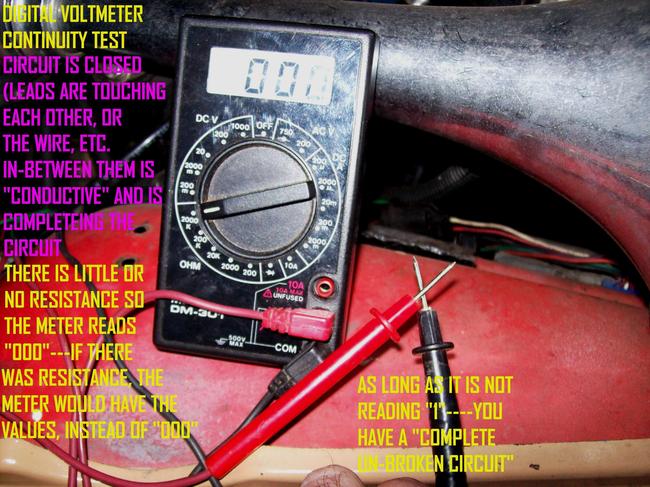

DO YOU HAVE A VOLTMETER, KNOW HOW TO WORK IT MUCH AT ALL?

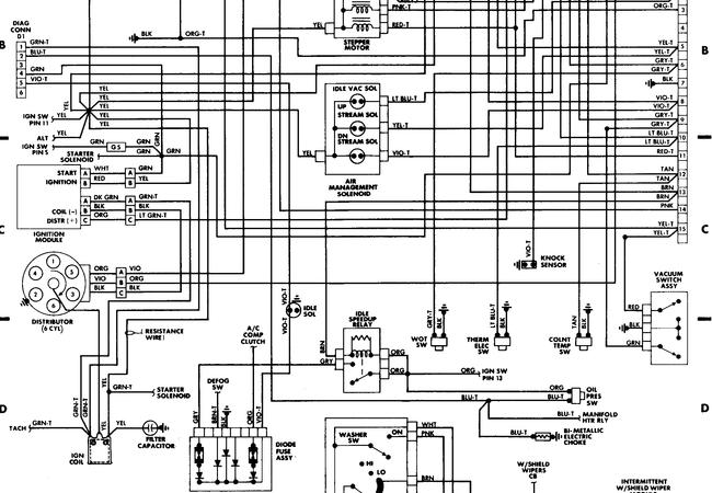

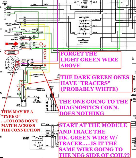

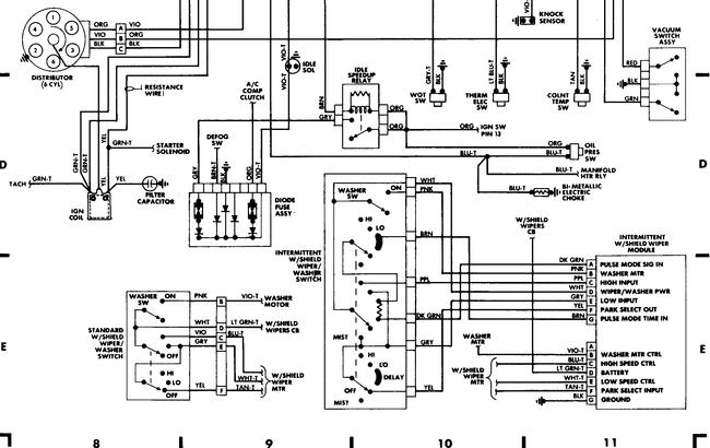

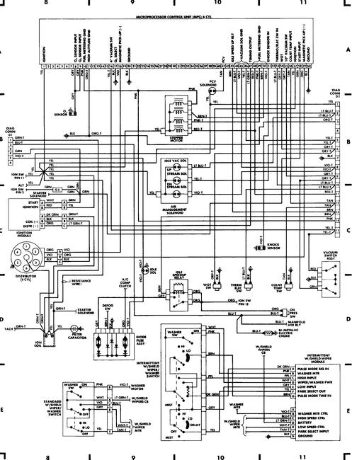

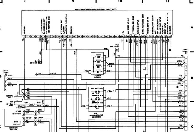

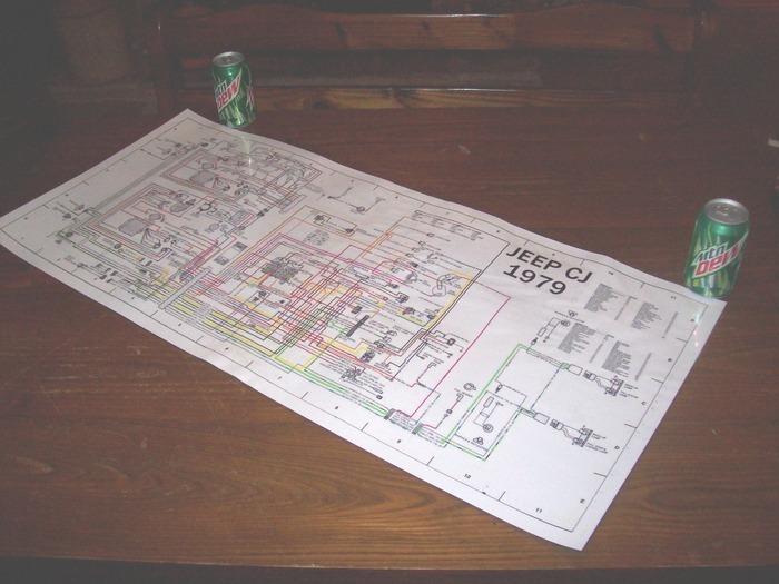

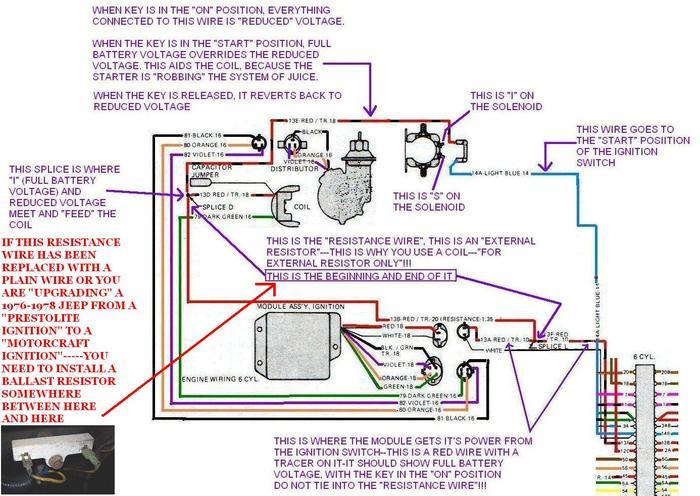

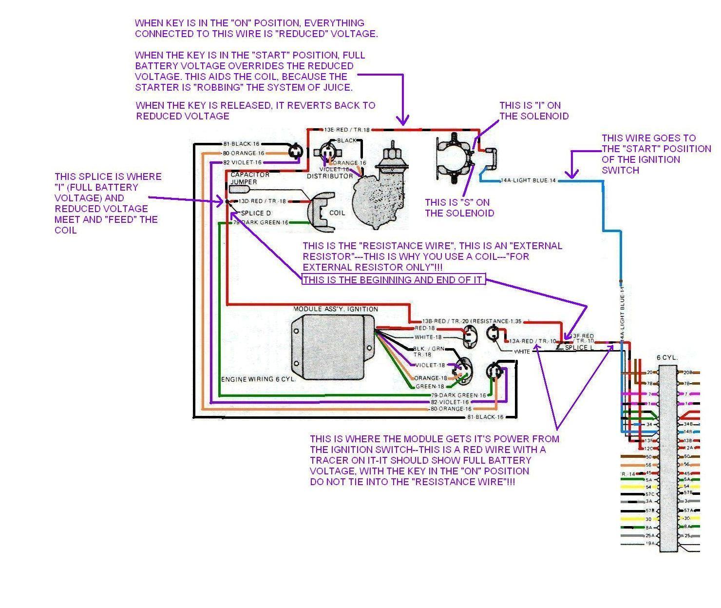

I SCANNED A WIRE DIAGRAM OUT OF A BOOK.I TOOK IT OVER TO "MICROSOFT PAINT" AND I COLORED EACH WIRE THE BEST I COULD, I SORTA HAD TO COMPROMISE ON WIRES WITH TRACER STRIPES (THE TRACER COLORS WERE UNKNOWN). THIS TOOK ME QUITE A WHILE, I THEN EMAILED THE 2 HALVES TO THE OFFICE PLACE AND HAD THEM BLOWN UP.I THEN MATED THE TWO, AND HAD THEM LAMINATE IT. THESE OLDER DIAGRAMS ARE BASICALLY ROAD MAPS FROM ONE END OF THE JEEP TO THE OTHER.
THE NEWER JEEP DIAGRAMS ARE SORTA LIKE FLOW CHARTS. THEY DO NOT WIND THEIR WAY AROUND TO THE NEXT CONNECTION. IT'S A "BLOCK" ON TOP OF A "BLOCK" ON TOP OF A "BLOCK" WITH LINES BETWEEN THEM. DESTINATIONS ARE FOUND FAST. BUT THEY CONFUSE ME SOMETIMES
I HAVE SCANNED SOME WRANGLER DIAGRAMS (I DON'T REMEMBER THE YEAR) BUT I HAVE NOT ATTEMPTED TO DO ANY COLORING OR TRIED TO PUT THE PIECES TOGETHER FOR A WRANGLER. YET
A BETTER PIC OF THOSE WIRES YOU ARE MENTIONING MIGHT HELP ME
I'M GONNA THROW YOU AN EXCERPT OF A 1979 CJ DIAGRAM. REMEMBER IT DID NOT HAVE A COMPUTER
THE '79 HAD 4 WIRES FROM THE IGNITION MODULE HEADING FOR THE COIL AND DISTRIBUTOR. ON A WRANGLER THE BLACK WIRE GOES THRU THE COMPUTER. TO MAKE THINGS (IGNITION) "NON-COMPUTER CONTROLLED". THE "NUTTER BY-PASS" IS PERFORMED. LET'S NOT GO THERE YET!.A SITUATION LIKE YOURS IS THE WHOLE REASON FOR DOING THE NUTTER. TO TAKE MR. COMPUTER OUT OF THE EQUATION COMPLETELY
DISREGARD THE "RESISTANCE WIRE". AND THE BLACK WIRE.I JUST WANT YOU TO SEE SORTA WHERE STUFF GOES INTO THE COIL, ETC
LEMME KNOW IF YOU SPOT A PROBLEM

Okay, just bought it for my son ran fine for test, also on way home around 20 min drive. He took to work another 20 min ran fan next day started to die then would start after 20 min. No nothing at all only wires he said he touched were neg to coil and pos wire comes off connects to capicator and red wire to ICM and green to solenoid. Pics comming. Did test results are.361 lead to lead on cap then OL when I touch center and dist base, it is brand new just put in, but tested old same way got lead to lead.345 and center touched base 0.

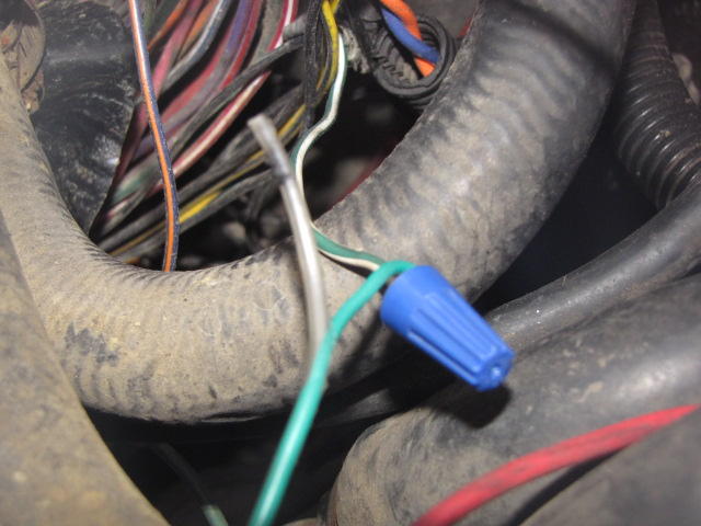

I also probably jumped ahead and took all wires out of cable sheath and followed from coil to ICM, checked for visual defects none, keep help comming all is helpful and at least work in progress
Tuesday, July 9th, 2013 AT 4:45 PM
DANINROY
  • 24 POSTS

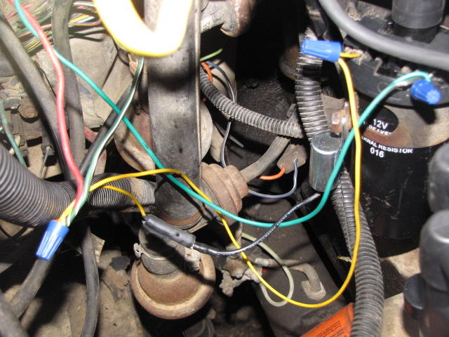

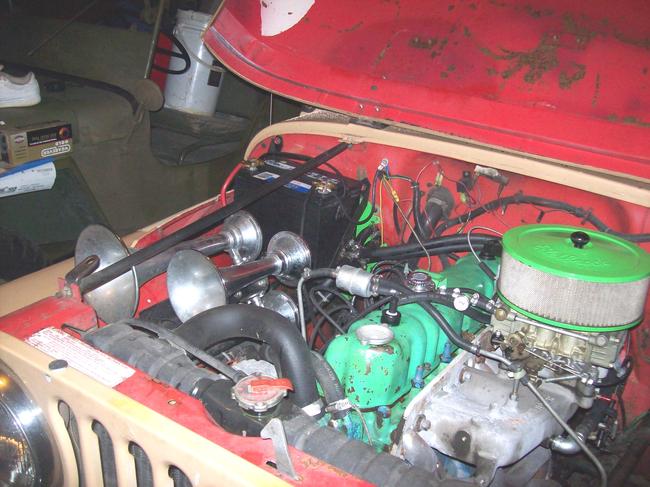

1 st pic of solenoid, 2 nd coil with doctored wires 3 rd uncovered wires, top of carb, battery and 2 relays, 6 pic doct wires and where they come out

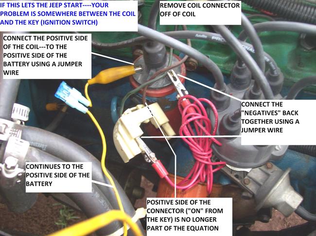

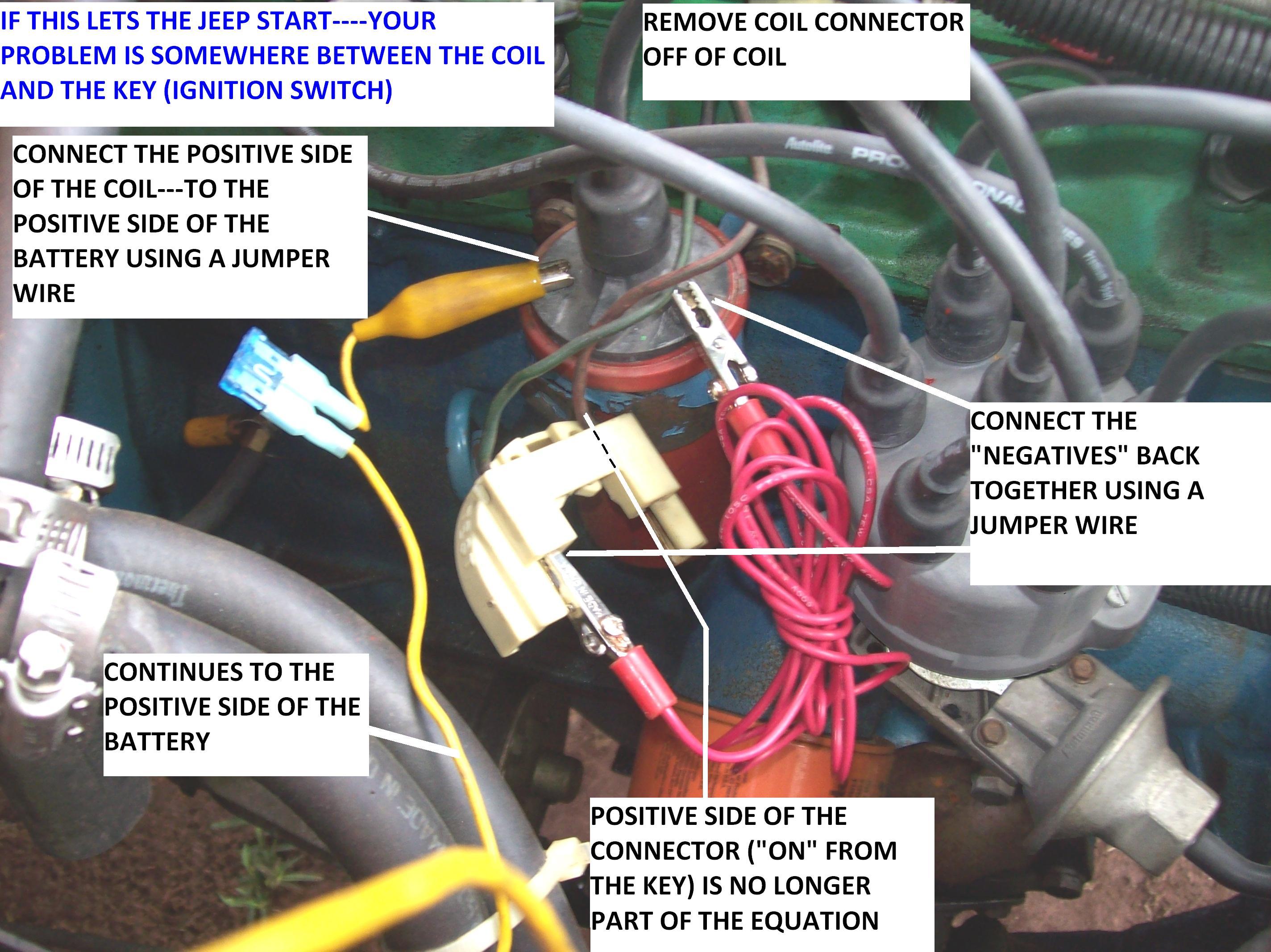

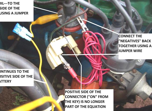

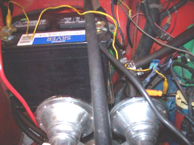

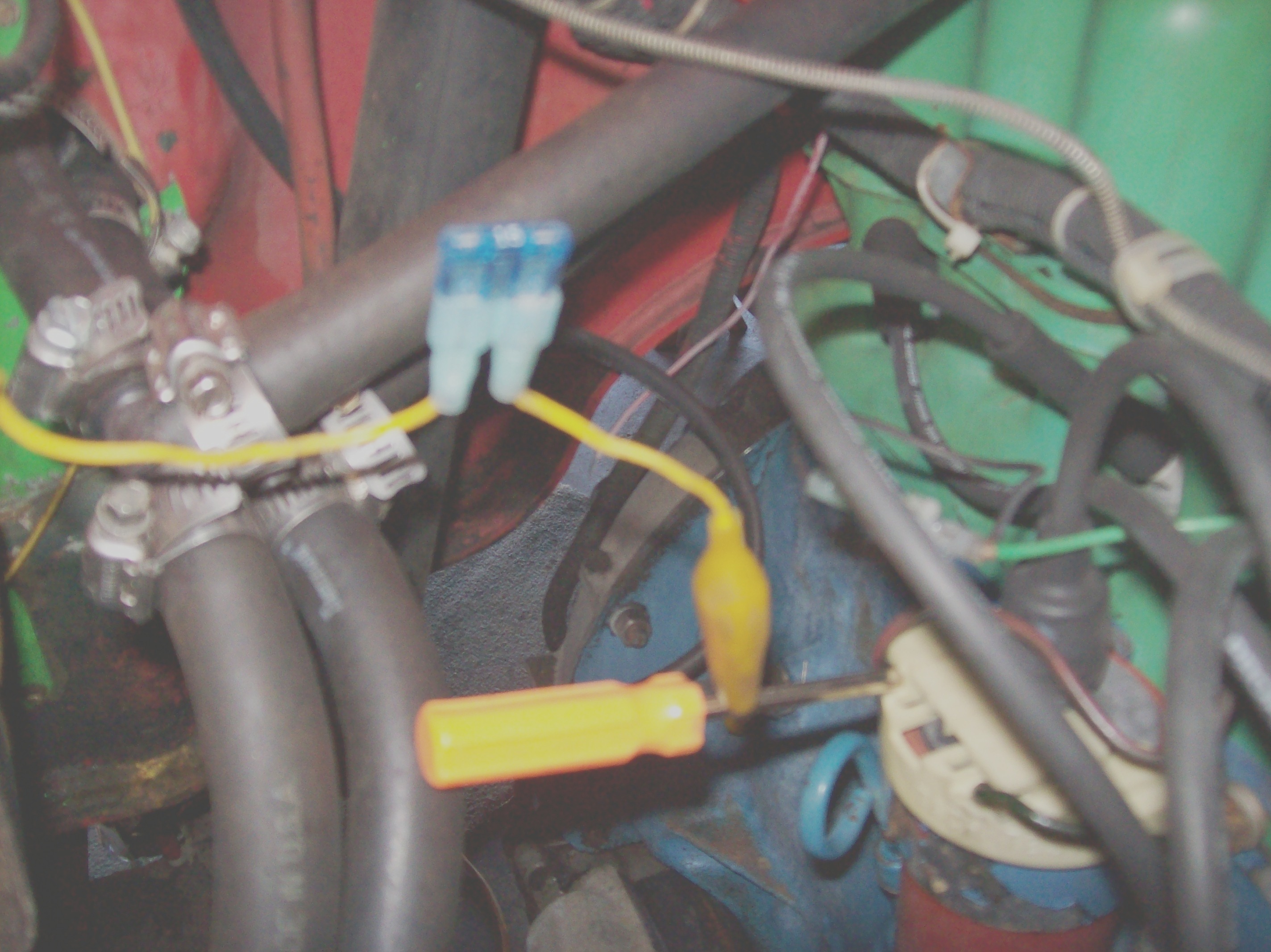

WE ARE NOW GONNA "BYPASS" THE IGNITION SYSTEM
............THIS WILL TELL US IF IT WILL RUN......AND WILL TELL US IF IT'S IN THE WIRING (OR COMPONENTS ALONG THE WAY)
SO.........IF ALL THE OTHER STUFF UNDER THE HOOD IS OK.....THIS WILL MAKE IT RUN
...........HOWEVER, TO MAKE IT STOP, YOU WILL HAVE TO DISCONNECT THE JUMPER AT THE BATTERY
YOU WILL STILL TURN THE KEY TO MAKE IT TURN OVER!

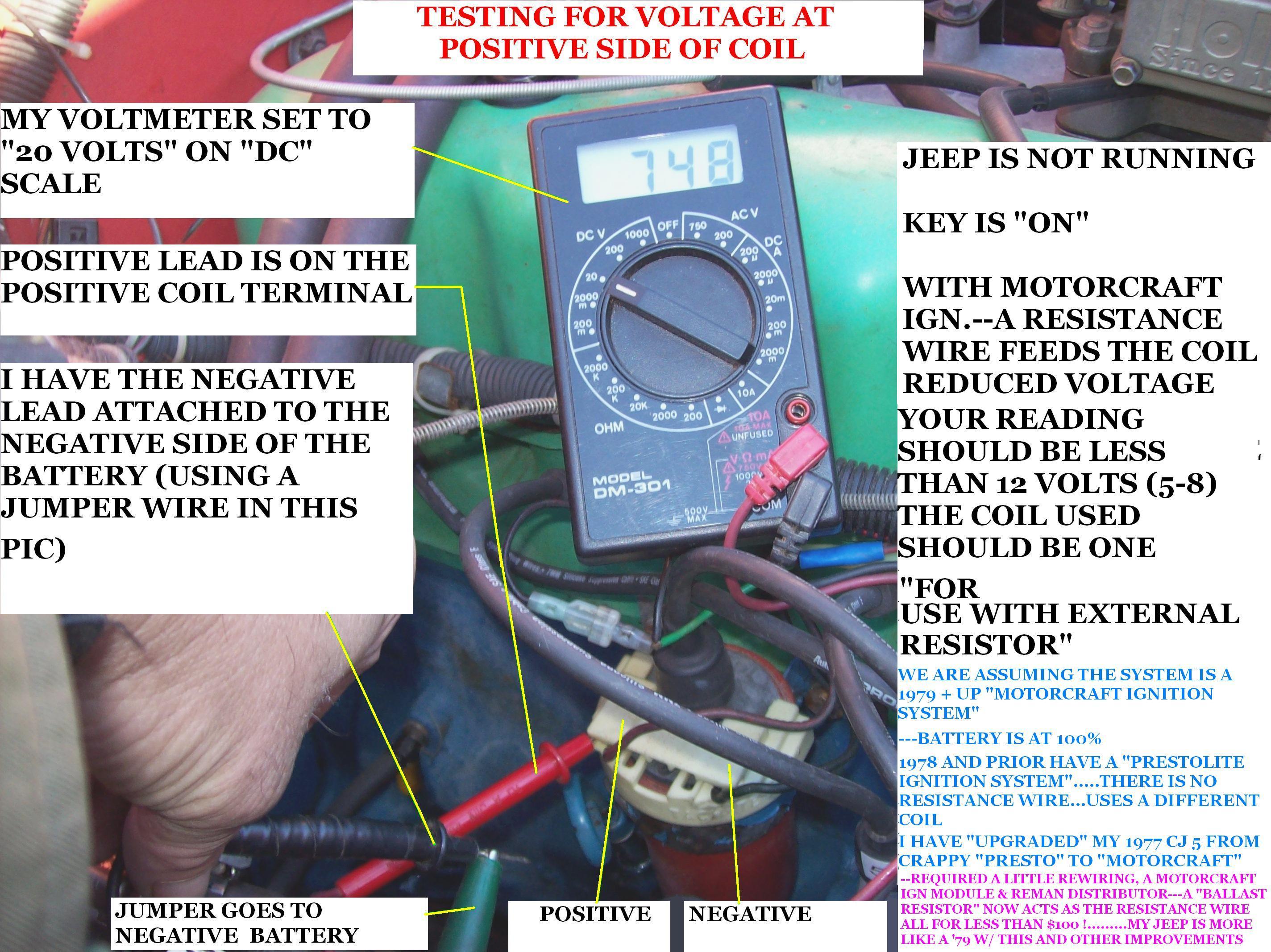

DO PIC 1
THE FUSE IN MY JUMPER IS "SHORT PROTECTION"........I LIKE TO PLAY IT SAFE!
THE REASON I COMPLETELY REMOVE THE COIL CAP IS TO GET RID OF ANY PROBLEM BACK TOWARDS THE KEY
WE WILL BE RUNNING OFF OF THE BATTERY/ COIL/ DISTRIBUTOR/ AND IGNITION MODULE (IF IT IS GOOD-IF IT GETS IT'S OWN POWER)
DON'T FRET IF THIS DON'T WORK----I CAN KEEP DIAGNOSING FOREVER!
LET'S TRY THIS IF WE DON'T HAVE POSITIVE RESULTS WITH THE IGNITION BYPASS

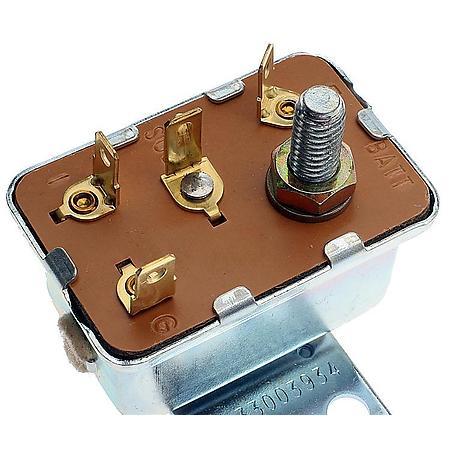

...............................OFF TO A POPULAR AUTO PARTS STORE, YOU GO....THEY USUALLY WILL TEST THESE FOR FREE
LETS WATCH AND SEE IF THEY HOOK UP RIGHT (IF YOU KINDA CAN READ THE CHART THEY ARE READING)
THEN HAVE THEM TEST IT 5-8 TIMES (THIS WILL WARM IT UP) SHOULD IT FAIL THE LAST FEW TESTS.....('COURSE THEY'LL SAY ONE TIME IS FINE....IT'S NOT!!!!)....AND YOU MIGHT SUFFER...NOT THEM!......SO MAKE 'EM DO IT!
WHAT IF IT FAILS?.............YES, REPLACE IT!
AS YOU PUT YOU HAND ON THEIR DOOR HANDLE TO LEAVE, WITH YOUR NEW ONE............
TURN YOUR BUTT RIGHT AROUND, GO BACK TO THE COUNTER, AND HAVE THEM TEST "THEIR" NEW ONE 5-8 TIMES.

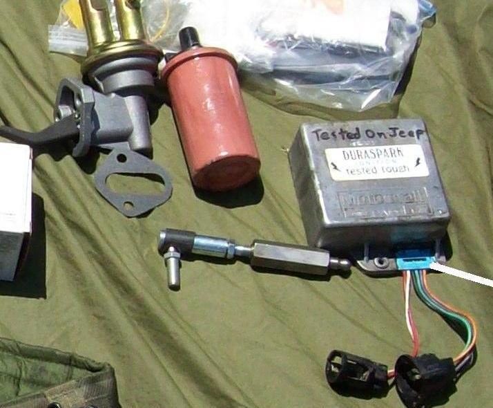

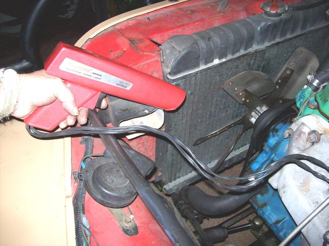

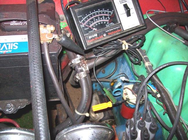

BELOW IS A PIC OF THE TESTER AT ADVANCE AUTO......THE CORRECT PIG-TAIL(S) TO TEST YOURS IS RIGHT BESIDE THE MACHINE (I PUT THEM THERE!)

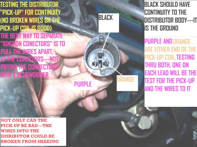

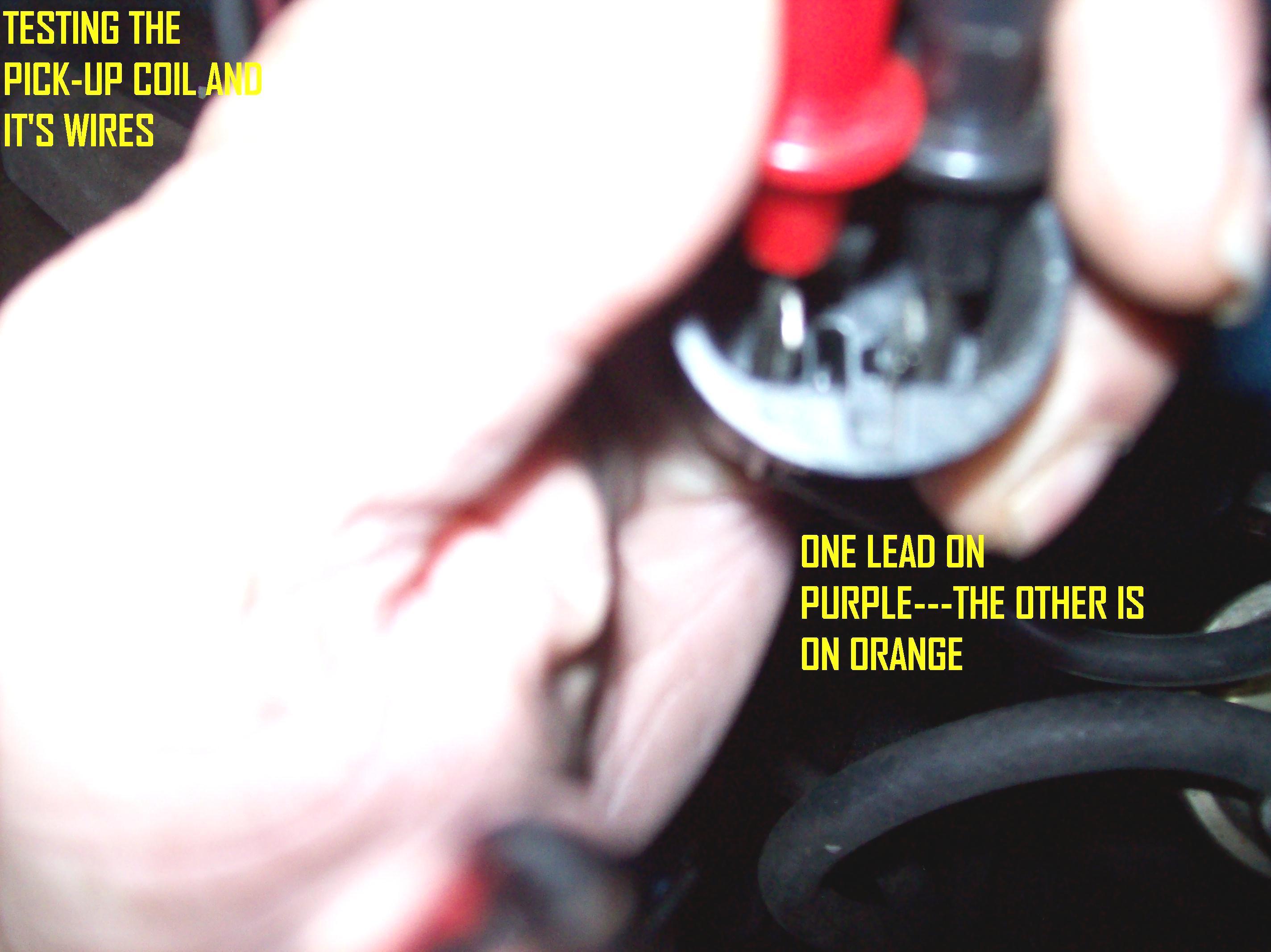

PIC 1) TEST THIS WAY
PICS 2 AND 3) THIS WAY LEAVES THE WIRES TO THE IGNITION SWITCH "IN" THE EQUATION....IF THERE IS A DEAD SHORT ALONG THE WAY.....IT'LL GROUND OUT OUR BYPASS ATTEMPT TOO....SO DO IT THE OTHER WAY (PIC 1).............................DOING IT THIS WAY (PICS 2 AND 3) YOU SHOULD BE USING THE FUSE IN THE JUMPER, FOR SURE!
PICS 4 AND 5) THIS IS THE MODULE TESTER AT ADVANCE AUTO PARTS........IS THIS A STORE NEAR YOU?

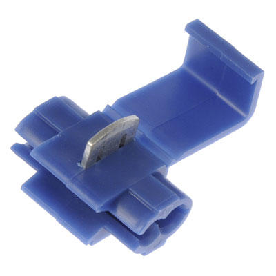

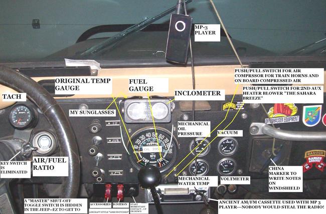

PIC 6) SOME OF MY CJ MANUALS

PICS 4 AND 5 WERE TAKEN WITH MY CANON EOS REBEL. THEY JUST WON'T POST IN THIS "NEWLY REMODELLED" 2CARPROS SITE (THEY WORKED BEFORE).I TRIED 4 TIMES. GONNA HAVE TO EMAIL "HIGHER UP" TO SEE WHAT'S WRONG
I'M POSTING PIC 6. SEEMS THE KODAK EZ SHARE CHEAP CAMERA PICS WORK JUST FINE!

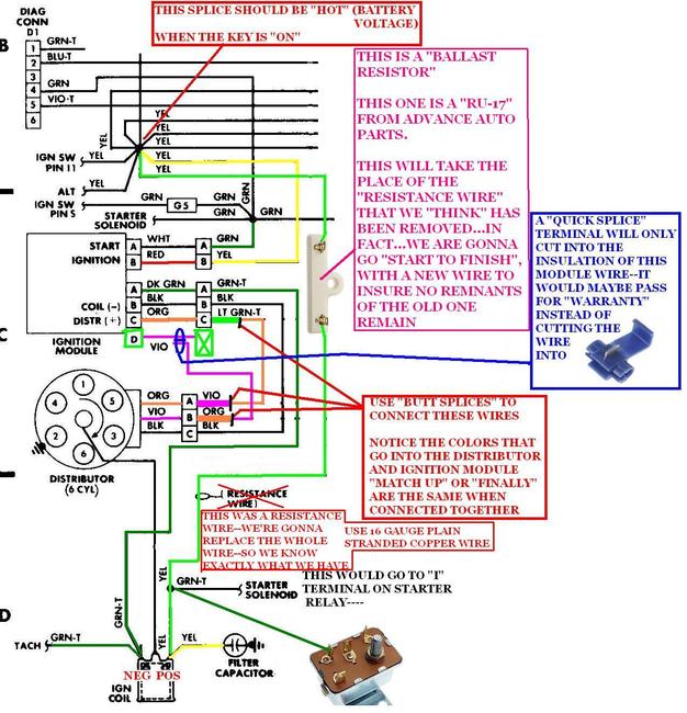

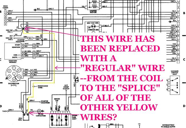

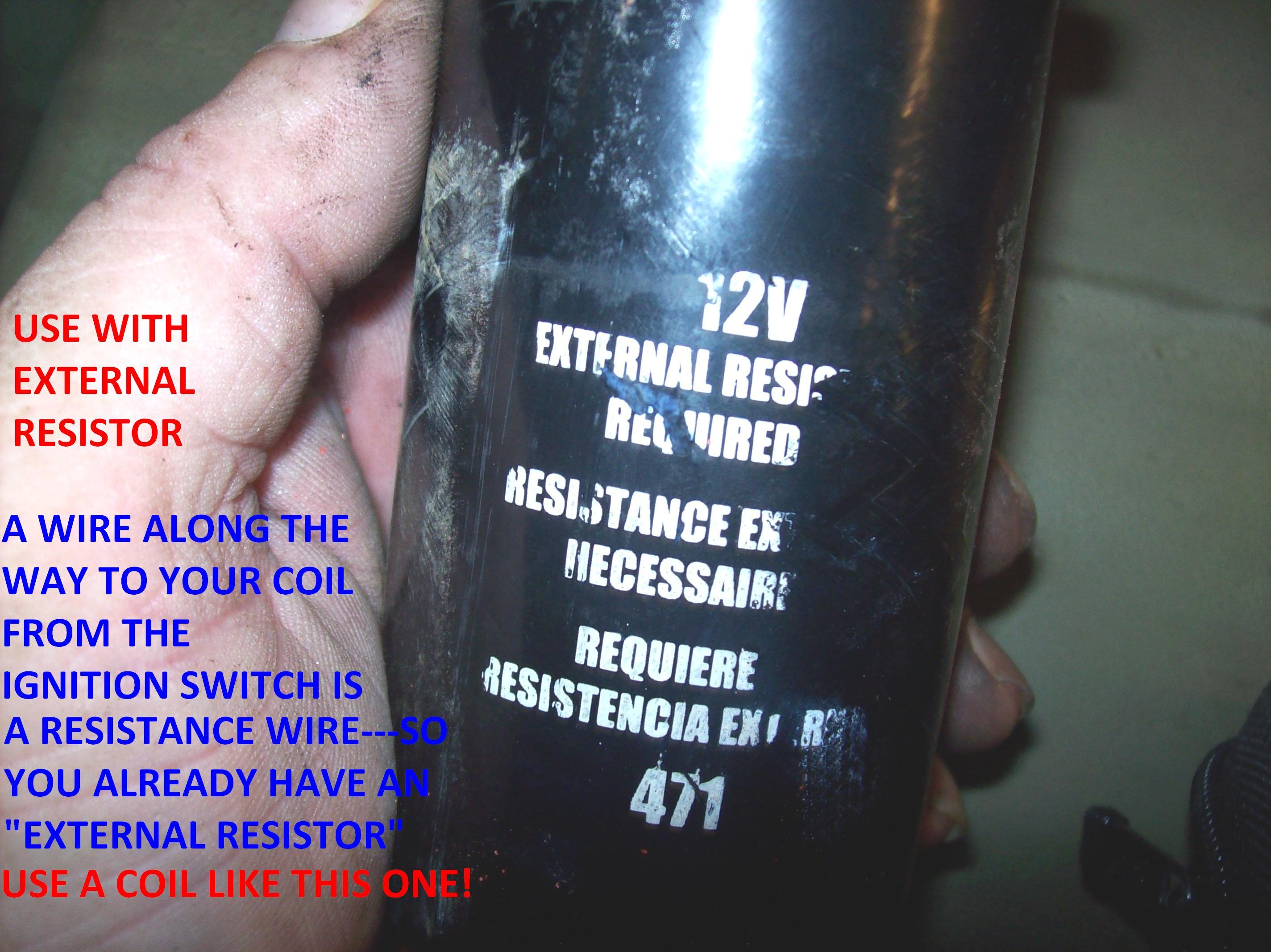

MAYBE THIS IS YOUR PROBLEM. RESISTANCE WIRE IN YOUR SYSTEM. NEED COIL WITHOUT INTERNAL RESISTOR
IN OTHER WORDS, YOU MAY NOW HAVE "DOUBLE THE RESISTANCE" IF YOU HAVE THE WRONG COIL
WITH YOUR KEY "ON". YOU SHOULD NOT HAVE BATTERY VOLTAGE AT THE COIL. IT SHOULD BE REDUCED. LIKE 6-8 VOLTS
DIFFERENT SYSTEMS (IN JEEPS TOO) REDUCE THE VOLTS TO THE COIL
1) MY 1946 WILLYS HAS POINTS. IT USES A BALLAST RESISTOR. AND A COIL LIKE IN MY PIC (NO INTERNAL RESISTOR (THE BALLAST RESISTOR IS THE REDUCTION
2) MY 1977 C 5 (CURRENT EVERYDAY DRIVER) "HAD" PRESTO-LITE IGNITION THE COIL HAD A RESISTOR MADE INTO IT
2a) I HAVE SINCE GOTTEN RID OF THE CRAPPY PRESTO-LITE SYSTEM. WHICH MEANT I HAD TO REPLACE THE DISTRIBUTOR AND IGN MODULE AND DO SOME SIMPLE RE-WIRING. IT NOW HAS A "MOTORCRAFT" (LIKE IN A 1979-YOURS). SINCE IT ORIGINALLY DID NOT HAVE A "RESISTANCE WIRE" (LIKE 1979 0N UP).I ADDED A "BALLAST RESISTOR" (TO TAKE THE RESISTANCE WIRES PLACE).I DID THIS SO THAT ALL 1979 IGNITION PARTS WOULD BE EZ TO OBTAIN WHEN THEY NEED REPLACING (NO-MIS MATCHING COILS. IT'D BE LIKE AN OEM 1979). THE ONLY THING DIFFERENT FROM THE 1979 AND THAN THE '77 IS THE BALLAST RESISTOR I ADDED
3) 1979 ON UP HAS A WIRE (A WIRE WITH RESISTANCE) (SEE DIAGRAM. THIS IS HOW I UPGRADED MY '77) THE COIL DOES NOT HAVE A RESISTOR IN IT. IF IT DID (LIKE USING A '77 OEM COIL) THE RESISTANCE WOULD SORTA DOUBLE OR EXPONENTIALLY MULTIPLY (I'M NOT AN ELECTRONICS WHIZ) SO. BASICALLY, YOU WOULD HAVE TOO LOW OF VOLTAGE TO RUN THE COIL
. WELL, I JUMPED OUTTA BED TO WRITE THIS (IT JUST SORTA "HIT ME").I RECKON I SHOULDA CHECKED OUT YOUR COIL NUMBERS 1ST. BEFORE SHOWING YOU ALL OF THE BYPASS STUFF

Tried test no start and checked coil no spark, also checked coil it does say external resistor.

'JU TAKE MR. MODULE TO AN AUTO PARTS STORE FOR MULTIPLE TEST RUNS?
I'D LIKE TO KNOW HOW THAT IS GOING. BEFORE WE ATTEMPT SOME PROBING INTO THE WIRING TO SEE WHAT WORKS. AND WHAT DON'T (I DON'T LIKE BACK-TRACKING)
IF YOU DID THE BYPASS TEST CORRECTLY
THEN. THIS STUFF IS WHAT MUST BE CHECKED OUT. THE BATTERY/ COIL/ DISTRIBUTOR/ AND IGNITION MODULE (IF IT IS GOOD-IF IT GETS IT'S OWN POWER). BECAUSE IT SHOULDA RUN, IF THESE ITEMS WERE WORKING
WE WILL GET TO DOING MORE TESTING WHEN WE GET RESULTS ABOUT THE IGNITION MODULE.I'VE BOUGHT, AND SEEN OTHERS WHO HAVE. GET A BAD ONE RIGHT OUT OF THE BOX
