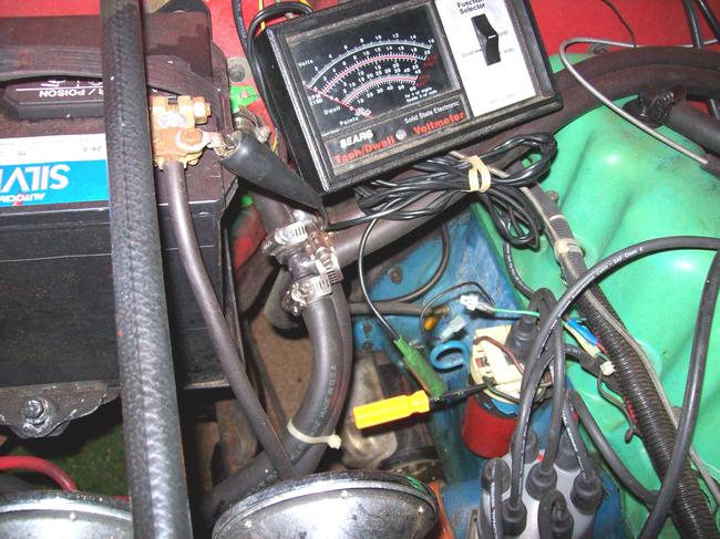

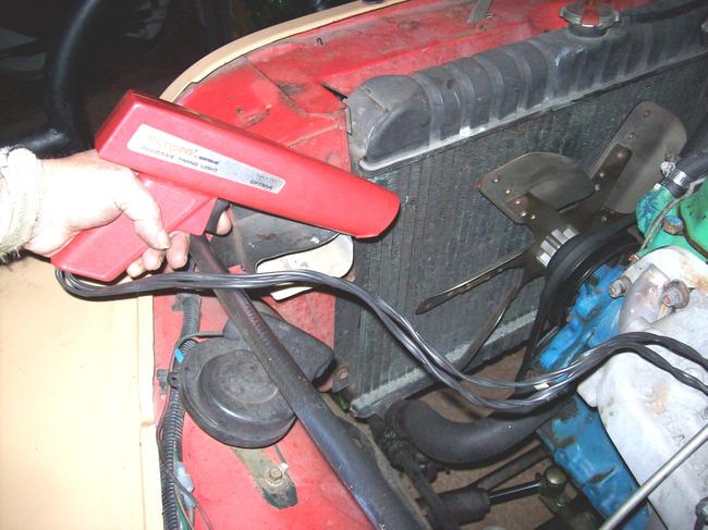

ONCE YOU ARE RUNNING.......I'LL GO INTO TUNING!
YOU WILL NEED A "TACH/ DWELL METER" AND A "PLAIN JANE" TIMING LIGHT
NOW-A-DAYS........YOU CAN FIND THEM CHEAP AT PAWN SHOPS.....SOME HAVE NO CLUE AS TO WHAT THEY ARE!
MY PAL GOT THIS WHOLE "LITTLE SET" (WORKS FINE) A FEW YEARS BACK AT "HARBOR FREIGHT", IT WAS ABOUT $40, USING THE PART NUMBER, YOU MAY BE ABLE TO FIND IT ON THE NET

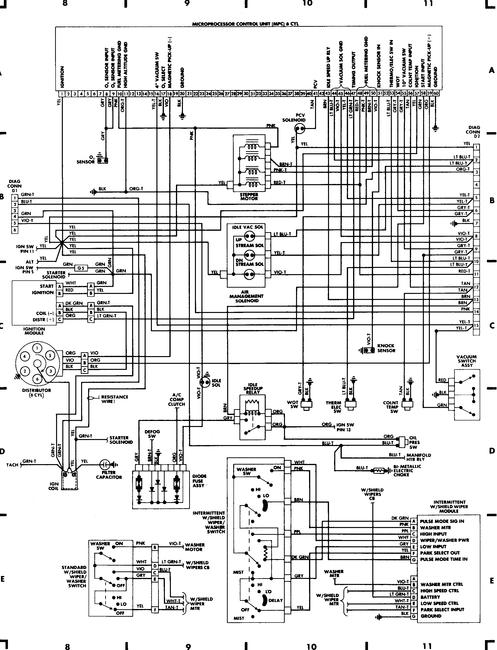

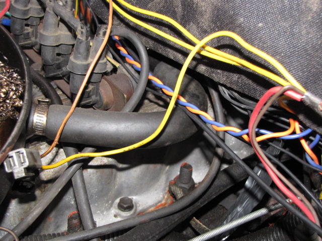

Question looked at your diagram from last message the wire one sorry, and notticed the orange, purple, green and black that connect to the Ignition controll module mine only has light green, black and dark green the module has black green orange and purple the purple slot out is blank no wire, the green wire which would be the orange from the module has another wire connected to it
seems something is a miss or is this normal, sending a pic let me know if it seem like someone moved something on me and one more thing, could my ignition switch be causing my module to short? Or am my that lucky. Put old modulein started ran rough then shut down an would not start after that. Your turn

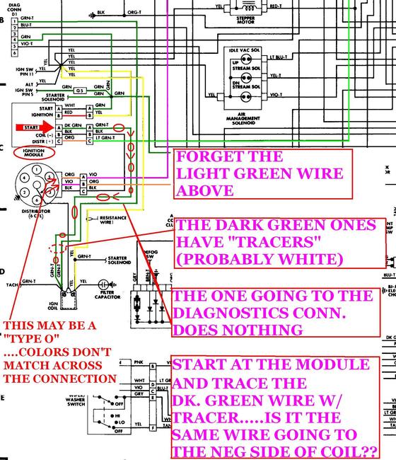

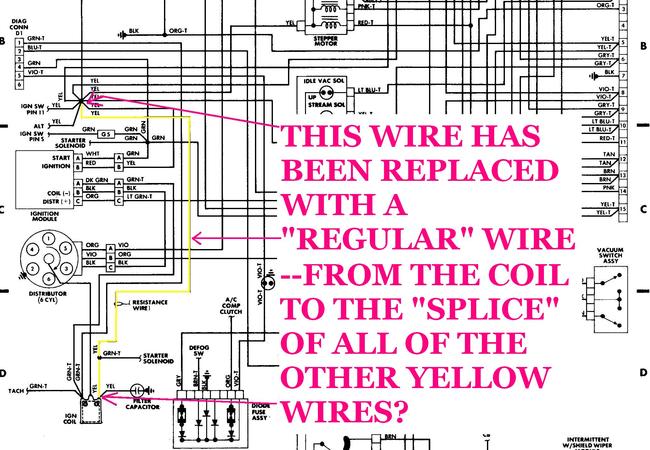

ALL RIGHTY THEN
'MEMBER I SAID THAT WAS FOR A '79 IT HAS A "RESISTANCE WIRE" FOR THE MOTORCRAFT IGN SYSTEM
MY '77 DID NOT HAVE THE RESISTANCE WIRE WITH A "PRSTOLITE IGN SYSTEM", WHEN I "UPGRADED" TO MOTORCRAFT, I HAD TO ADD RESISTANCE.I DID THIS BY ADDING A BALLAST RESISTOR TO TAKE THE PLACE OF THE "NON-EXISTENT" RESISTANCE WIRE

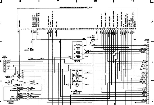

THE 1ST DIAGRAM I THREW YOU IS SORTA WHAT THE "NUTTER BYPASS" DOES---IT TAKES THE IGNITION OUT OF THE COMPUTER (SO THE COMPUTER CANNOT AFFECT IT) AND MAKES THE IGN SYSTEM "MORE BACK" TO AN EARLIER COMPUTER-LESS SYSTEM. MUCH LIKE THE 1979

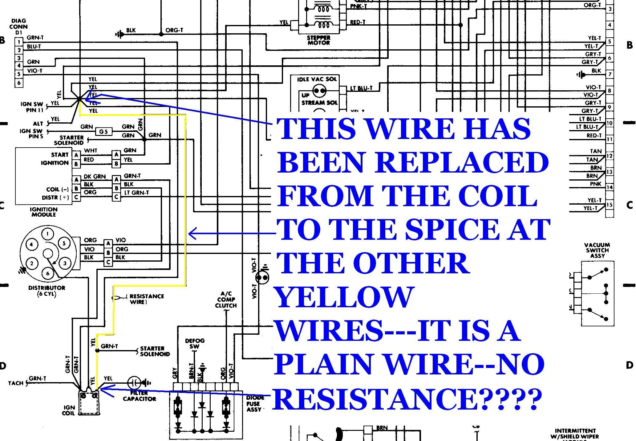

THIS DIAGRAM BELOW IS THE WIRING DIAGRAM FOR A "PLAIN JANE" '88 WRANGLER. LEMME KNOW IF YOURS IS A "LARADO", "S", OR A "SAHARA". THE DIAGRAMS MAY BE THE SAME, OR THEY COULD DIFFER
NOTICE OVER NEXT TO THE DISTRIBUTOR. YOU WILL SEE THE RESISTANCE WIRE
IF IT HAS NOT BEEN TAMPERED WITH OR REPLACED WITH A REGULAR WIRE, WITH THE "KEY ON", VOLTAGE TO THE POSITIVE SIDE OF THE COIL WILL BE REDUCED. IT WILL NOT BE EQUAL TO THE BATTERY VOLTAGE
SINCE I HAVE NO OTHER WAY TO SEND YOU THESE DIAGRAMS
I KNOW IT MUST BE HARD TO READ (I'M USING A 32" FLATSCREEN AS A MONITOR, IT IS NOT AS EZ ON 2CAR, AS THE DOWNLOAD IN "MY PICTURES"). IF YOU WANT ME TO, I CAN "CROP" THE DIAGRAM 2 WAYS AND SUBMIT BOTH HALVES ON 2 CAR TO MAKE THEM BIGGER
DOES THIS DIAGRAM HELP?
WIRE COLORS ARE LABELED
IT'S NAMED "COMPUTER ENGINE (6 CYL)", IN MITCHELL I

LOOK AT THE DIAGRAMS. RESISTANCE WIRE GOES TO THE COIL
HAS THAT WIRE BEEN CUT/ SPLICED/ REPLACED?

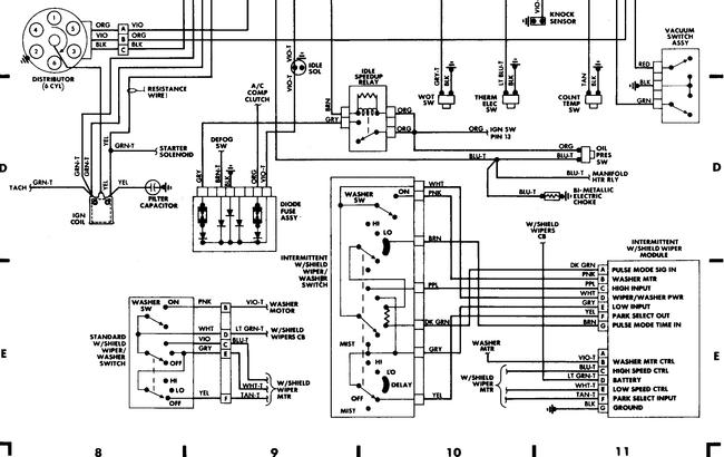

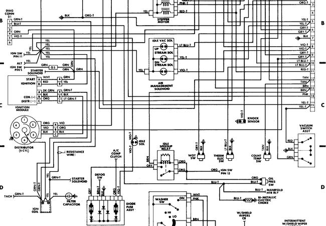

I CROPPED THE SAME DIAGRAM 3 WAYS. TOP HALF. BOTTOM HALF. AND THE MIDDLE

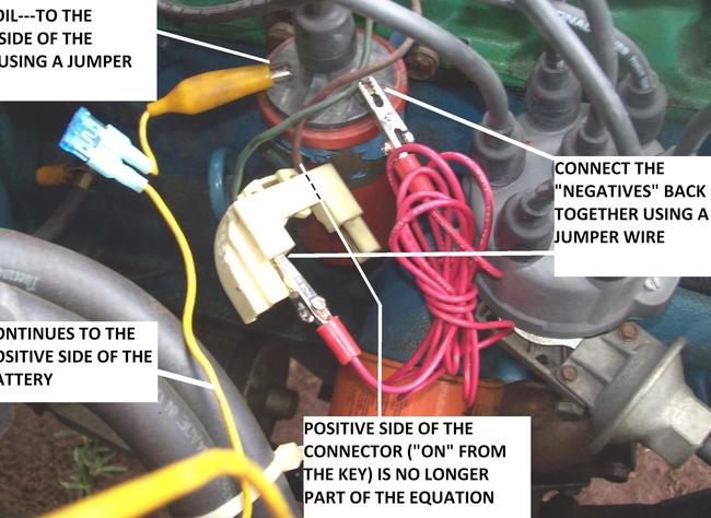

IF THE IGNITION SWITCH WAS THE PROBLEM. PAGE 2, JULY 10, TEST AT COIL WOULDA MADE IT RUN
ARE YOU SURE YOU PERFORMED THE TEST RIGHT. DID YOU HAVE GOOD CONNECTIONS WITH THE JUMPER WIRES?
POS BATTERY TO POSITIVE COIL STUD. NEGATIVE ON COIL CAP WENT TO NEG ON COIL
DOING THIS BYPASSES THE IGNITION SWITCH
. YOU DID THIS TEST WITH A "BAD" IGNITION MODULE INSTALLED?
LET'S DO IT AGAIN !

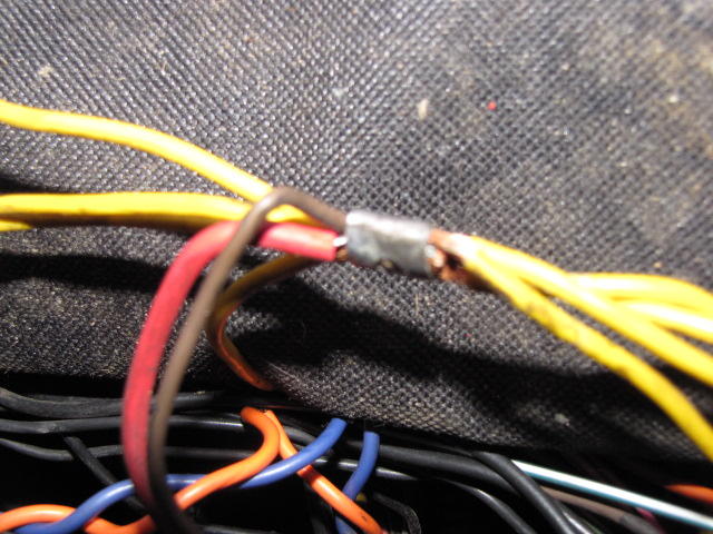

Yes the the wires have a splice on them, the capacitor/ condensor whatever its call is not cut though still has a plug. Not sure if ICM was bad will try test again.

Ok re tested no luck battery starting to die going to put on charger, wire out of harness followed it, it comes from pos term on dist connects to capacitor, then to a wire that goes to soleniod, is red at this piont goes up firewall and connects to about 4 yellow wires and a olive colored wire which goes back toward soleniod the yellow wires 2 to a plug which is not plugged and other too didnt follow back. I got ahold of previous owner he said when had vehicle only trouble he had was would run then shut off by its self and would let set and start up and do it all over, ended up being the capacitor he said, I have one but battery is low so cant try it.

SOUNDS LIKE SOMEONE HAS PLAYED MUSICAL WIRES WITH THIS POOR BABY!
YOU ARE GONNA HATE ME!
LET'S GET THIS "NEW" IGN MODULE TESTED.....AGAIN
IF IT IS NOW BAD, WE ARE GONNA ASSUME THAT THE "MIS-WIRING" IS KILLING IT

DO YOU KNOW HOW TO USE "MICROSOFT PAINT"?
IF SO, CAN YOU DRAW IN THE "ADDED"/ "CHANGED" WIRES ON ONE OF THE DIAGRAMS I SENT?

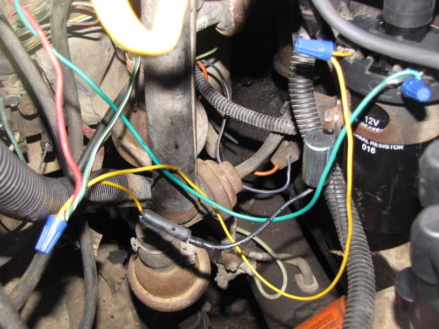

Sorry met pos side of coil lol, just getting frustrated, and yes can do on paint will have wifey help. We do have emmissions but usually its exempt because of the mileage on it. Tried test on coil again too with key on 12 volts when I crank engine 11 volts. As far as the ICM can do never mentioned having wire trouble so they think its on there end also can go to different store.
Wednesday, July 17th, 2013 AT 5:30 PM
DANINROY
  • 24 POSTS
First pic of coil with jerry wire connects, second pic of the grnd side of coil wire goes to harness and is attached there 3 rd pic is where pos side of coil wire goes after connecting to soleniod up fire wall center of engine connecs to these yellow wires and one yellow goes to CM other to comp and another to a plug as seen in 4 th pic not used

YES....I'VE GOT ABOUT 2.5 HOURS IN THIS ANSWER......I SEE YOU HAVE BEEN ANSWERING BEFORE I SUBMITTED THIS
IS THIS WHAT YOUR IGNITION MODULE LOOKS LIKE?
BE SURE TO LOOK AT THE OTHER VIEWS UNDER THE IMAGE
http://shop.advanceautoparts.com/webapp/wcs/stores/servlet/product_ignition-control-module-bwd_3051277-p?searchTerm=ignition+module%2Fcontrol#
YOU ALSO SAID THE "MYSTERY WIRE" RAN TO THE SOLENOID........WHERE ON THE SOLENOID?......IS THIS THE SOLENOID YOU ARE TALKING ABOUT?
http://shop.advanceautoparts.com/webapp/wcs/stores/servlet/product_starter-solenoid-bwd_3993949-p?searchTerm=solenoid
IF YOU "HAVE" TO BUY PARTS, REMEMBER PAGE 2 AND "A124"
I REALLY WANNA SEE WHAT YOU CHANGE ON THE WIRING DIAGRAM IN "PAINT"
.................BEFORE I START TELLING YOU WHAT TO CHANGE
HERE'S THE FULL DIAGRAM AGAIN, SAVE IT IN YOUR PICS, TAKE IT TO PAINT...........I JUST CHANGED IT FROM "GIF" TO "JPEG" FORMAT IN MY "PAINT"
IF WE GET 'ER DONE CORRECTLY.....IT WILL BE WORTH THE WAIT!
YOUR INFO IS MOST HELPFUL!

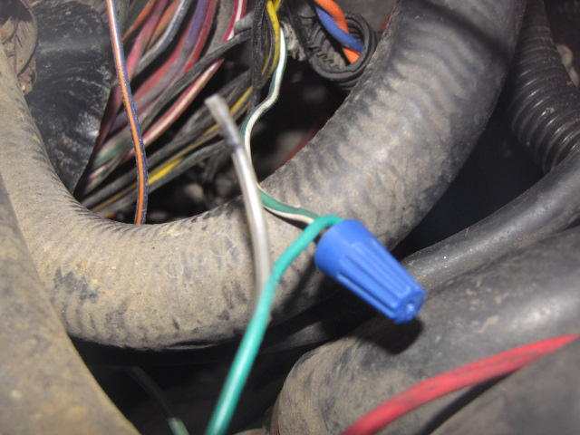

I'M STILL COLLECTING INFO ON WHAT WE ARE STARTING OUT WITH.......TRACE THIS GREEN WIRE FOR ME IN THE PIC BELOW......INSURE YOU BEGIN AT THE "CORRECT" GREEN ONE AT THE MODULE........I WANNA KNOW WHERE IT ENDS UP ON THE JEEP (NOT NECESSARILY THE WAY IT IS IN MY DIAGRAM)
I FEEL THAT WE WILL END UP DOING THE COMPUTER BYPASS AND MAKING THIS MUCH LIKE A 1979

Yes that is the same ICM and no the thing I have been calling a soleniod is mounted on the firewall by the battery bet its really called the starter relay

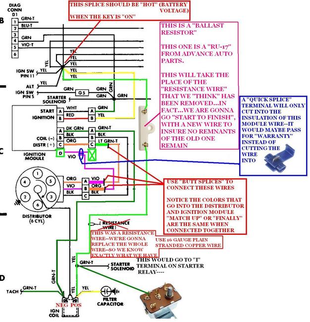

HOW'S ABOUT A LITTLE "REWIRING"?

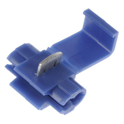

DO YOU KNOW HOW TO "BUTT-SPLICE" WIRES AND ELIMINATE THOSE CRAPPY LOOKING WIRE NUTS. HAVE THE NECESSARY TOOLS?
. NOT YET. WE MAY BE DOING SOME REWIRING
I'VE SPENT SOME TIME WORKIN' ON A DIAGRAM FOR YOU
IT WILL REQUIRE SOME TRACING OF WIRES AND YOU MUST GET IT RIGHT.I'LL SEND IT IF/ WHEN YOU ARE READY.I WANT YOU TO LOOK IT OVER GOOD AND RESPOND BACK, BEFORE YOU JUMP ON IT!
ASK QUESTIONS. IF NEED-BE!
THIS WILL ELIMINATE THE COMPUTER CONTROLLING THE IGNITION. COMPUTER WILL BASICALLY BECOME A "BRICK" IN YOU JEEP
SEND ANSWERS BACK TO MY QUESTIONS

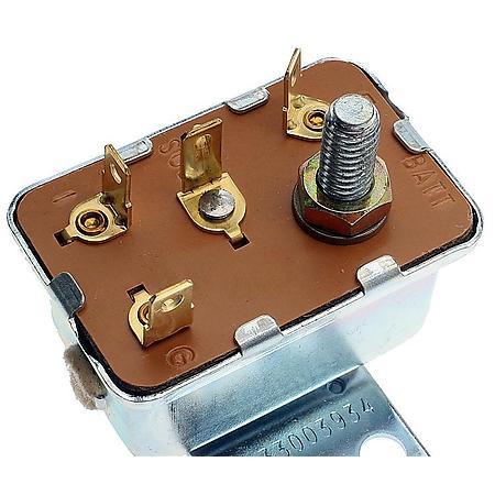

DO YOU KNOW WHAT THIS THING IS IN THE PIC BELOW. DO YOU KNOW HOW TO INSTALL ONE?

THIS IS A "STARTER RELAY". IS THIS THE ONE YOU HAVE?

Yes have some of those wire clips, and yes that is exactly the one I have, will start on fixing wires first and wait for your next input.

I LOOKED THIS OVER SEVERAL TIMES.I'LL SUBMIT IT NOW
BE SURE OF THIS BEFORE YOU DO IT. ASK QUESTIONS 1ST. CUT LATER!
IT LOOKS GOOD IN "MY PICTURES" AND ON MY 32" MONITOR/ FLAT-SCREEN TV
IT MAY BE HARD TO READ ON 2 CAR---LEMME KNOW---I MAY CAN BUST IT IN HALF OR QUARTERS. TOO BAD I JUST CAN'T EMAIL IT TO YA. WE USED TO BE ABLE TO 'MESSAGE" OUR QUESTION ASKERS AND KEEP EMAIL ADDRESSES CONFIDENTIAL
LOOK OVER THE DISTRIBUTOR AND IGNITION MODULE
THE WIRE COLORS COMING OUT OF EACH ONE SHOULD EVENTUALLY END UP BEING THE SAME GOING INTO THE OTHER
. SO I DON'T CARE WHAT COLOR IS IN BETWEEN AS LONG AS THE END UP THE SAME!
CASE IN POINT
THE ORANGE WIRE COMING COMING OUT OF THE IGN MODULE IS "ORANGE" (C)---IT GOES INTO THE CONNECTOR (C) AND THE SAME WIRE TURNS "GREEN".I THEN PUT IN A ORANGE ONE.(IT DON'T MATTER WHAT YOU DO. AS LONG AS IT ENDS UP "ORANGE" AT THE DISTRIBUTOR [A]). UNDERSTAND?
WIRING TO THIS CONFIGURATION MAKES IT MUCH LIKE A SIMPLE 1979. THE COMPUTER IS NO LONGER IN THE MIX!
