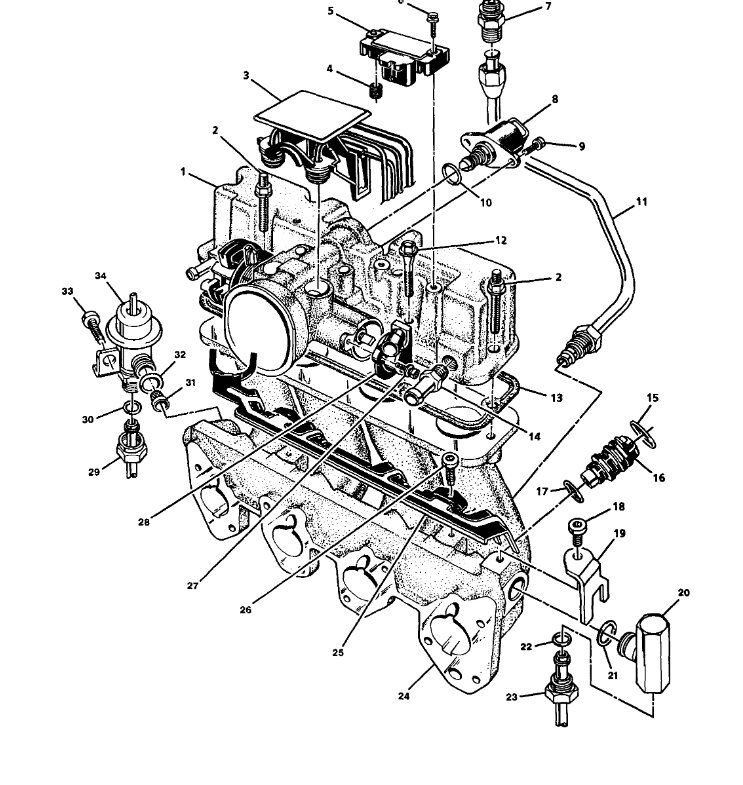

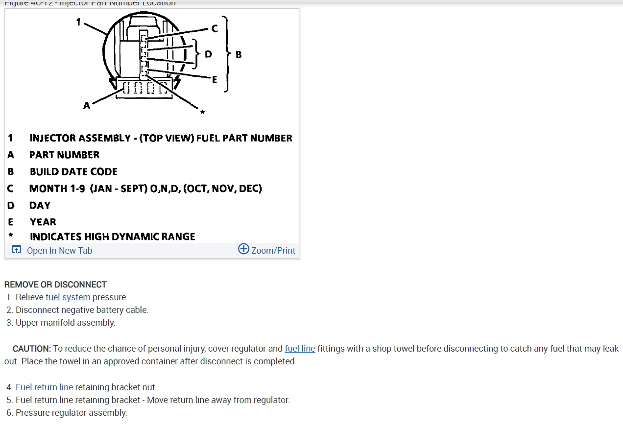

When I first crank my truck it runs fine, say I go to the store and shut it off, and then crank it when I'm ready to leave it runs horribly and drinks a ton of gas. Any ideas?
Dec 9, 2023 at 12:20 AM
  • 55,455 POSTS

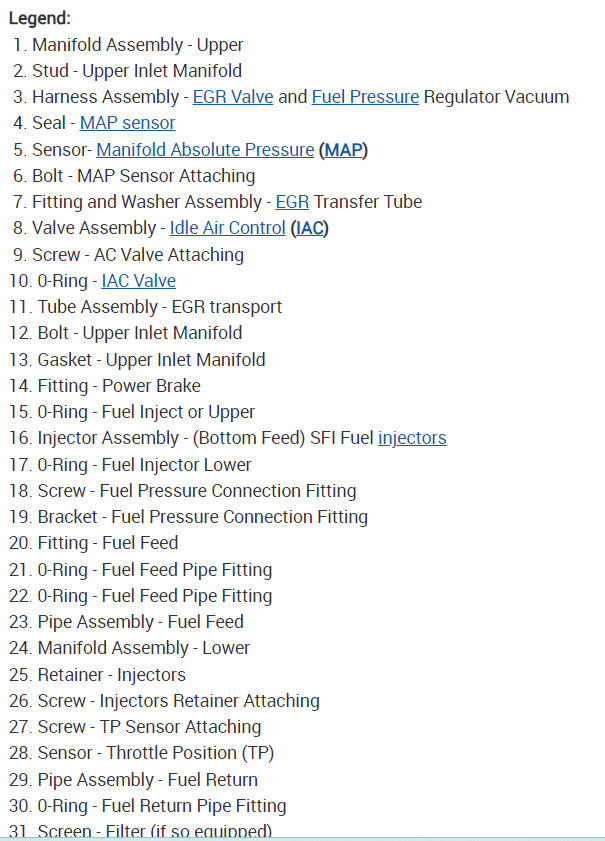

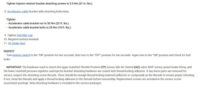

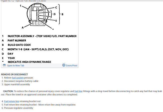

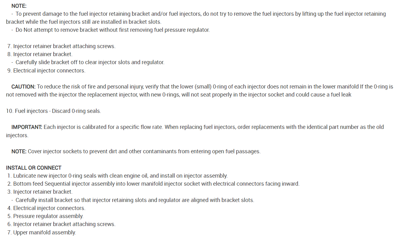

It sounds like one of the fuel injectors is sticking open, to find out which one lets remove the spark plugs and look for the one that is darker than the rest (black). I would then change the spark plugs and replace that injector, if you want to keep the vehicle I would change all of the injectors out because they can wear and you will have the same problem again soon.
Also we should run the codes to see if any are stored.
and
https://www.2carpros.com/articles/how-to-change-spark-plugs
Check out the images (below). Please upload pictures or videos of the problem so we can see what's going on.

We've recently changed all 4 injectors plugs wires coils o2 sensors crank and cam sensor also the running temperature is staying under 140 if that.
Dec 9, 2023 at 4:08 AM
  • 55,455 POSTS
It sounds like the engine cooling system thermostat is stuck open; I would remove it to help confirm the failure. Did you run the codes? Also, you may have a defective fuel injector which leaks which can cause poor running for a short sit. I would remove the spark plug to see if there is a dark one which will be the cylinder that is having a problem. Here is how to change the thermostat.
