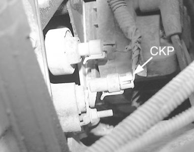

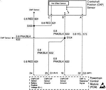

Hello Sooper Skool I wish I could have codes about misfire and cat. the engine did not start when you shoot starting fluid in the intake, that tell me the problem is not the fuel pump but spark or compression. Right now the engine is flooded. you must start the engine with the gas pedal down. Keep cranking, the engine may start. if it does not start, remove the spark plugs ,if they are wet ,mean there is no spark, check the crankshaft position sensor. here is what you need to do. # Turn the ignition key OFF . # Unplug the sensor electrical harness and check the terminals for corrosion and damage. # Check the sensor wiring harness wires for continuity and repair as necessary. # Attach the sensor harness making sure it is firmly engaged. # Using a Digital Volt Ohm Meter (DVOM) set on the DC scale, backprobe the sensor signal terminal (terminal A) with the positive lead of the meter and backprobe the sensor ground terminal (terminal B) with the negative lead of the meter. # Have an assistant crank the engine and observe the meter. # You should have approximately a 5 volt reference signal pulse. If not the sensor may be defective.

I went ahead and pulled the plugs on it. Everything looks good...no fouling. Plugged everything back in and it cranked up. It was a little hard at first but it eventually fired after about the 3rd try. I then drove back to autozone and had them check the codes on it. It still read the same. They asked if I had disconnected the battery to reset the computer after replacing the TPS. I had done this so they reset it from the scanner and the check engine light went out. I drove it to work and the light hasn't come on yet. I haven't checked the crank sensor yet as I am at work now where I am able to check the forum and emails. I will see what its going to do when I get off and check the sensor. I'll let ya know how it goes.
