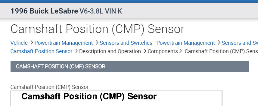

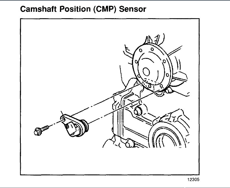

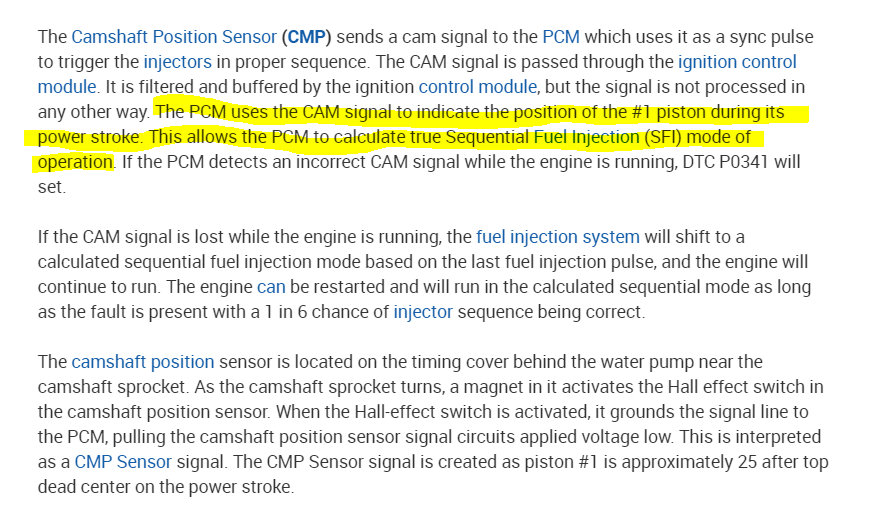

SCGRANTURISMO
  • 4,897 POSTS

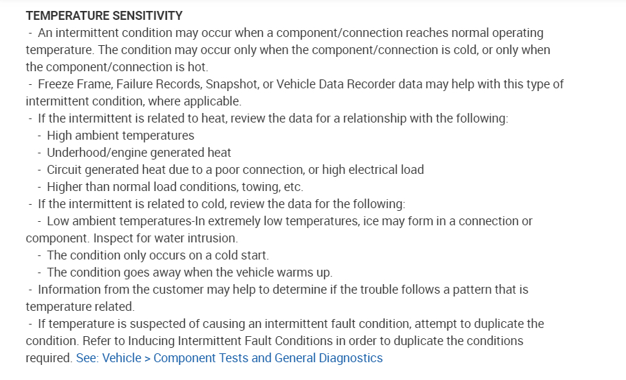

The EGR Valve would cause a vacuum leak if the valve was stuck open and cause a rough idle, but it would also cause low speed driveability concerns, and I don't think it is your problem. Believe it or not, your vehicle's Engine Coolant Temperature [ECT] Sensor can cause erratic idle and driveability concerns. However, the one sensor that you guys failed to replace is the Camshaft Position Sensor [CMP] which the Power-train Control Module [PCM], or "computer" uses to synchronize the fuel injectors so it can fire them when they need to be fired. Without this signal your vehicle will not start. In the diagrams down below I have included a description of the operation and location of the CMP. Here is a generic guide on how to replace one, if needed, below:
https://www.2carpros.com/articles/camshaft-angle-sensor-replacement
Please go through these guides and get back to us with how everything turns out.
Thanks,
Alex
2CarPros

SCGRANTURISMO
  • 4,897 POSTS
Hello again,
I'm sorry if I got that reply a little mixed up. I was trying to say that the CMP is used by the PCM to synchronize and signal the fuel injectors when to fire. The ECT is used in the formula by the PCM as to how long to hold open the fuel injectors which is how the PCM makes the Air:Fuel mixture either rich or lean. The PCM also will retard the ignition timing if the temperature reading it get's from the ECT is hot to keep the engine away from detonation, or "knock", which is the pre detonation of the air:fuel mixture without the spark plug igniting it. This usually happens when the piston is still traveling upward on the compression stroke, and can have catastrophic effects on your engine's internal parts. Please get back to us with how everything turns out.
Thanks,
Alex
2CarPros
Tuesday, October 29th, 2019 AT 12:41 AM

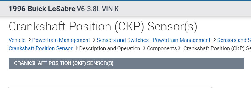

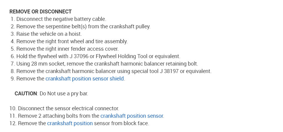

SCGRANTURISMO
  • 4,897 POSTS
Hello again,

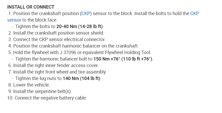

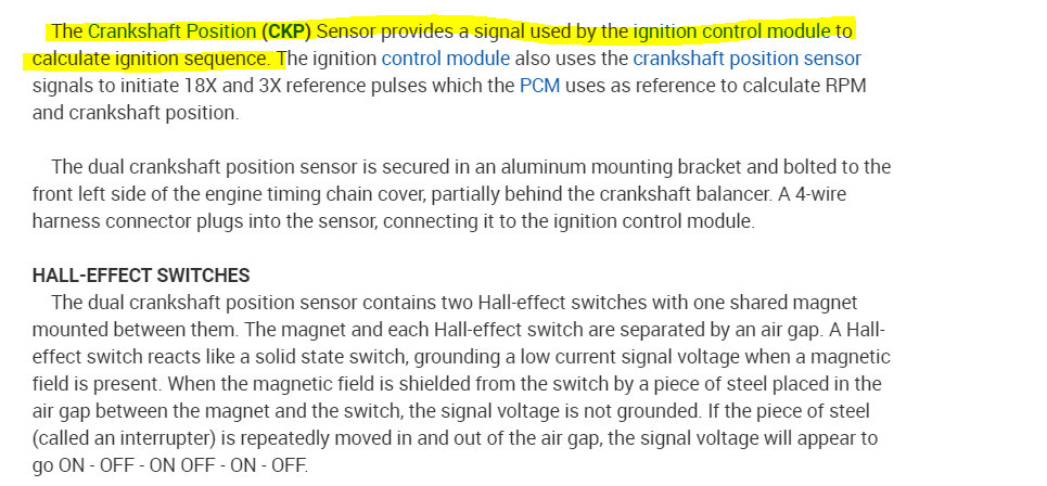

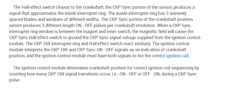

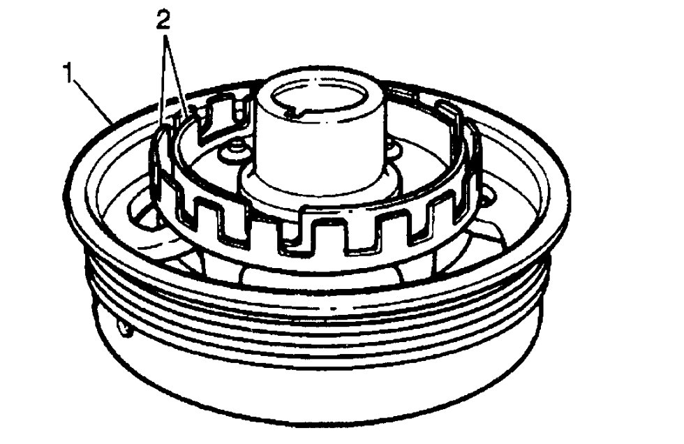

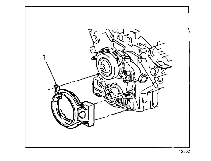

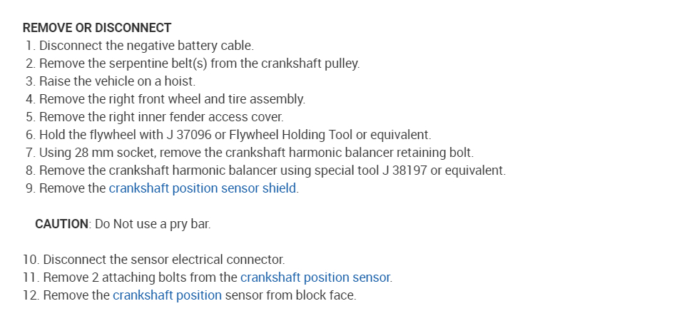

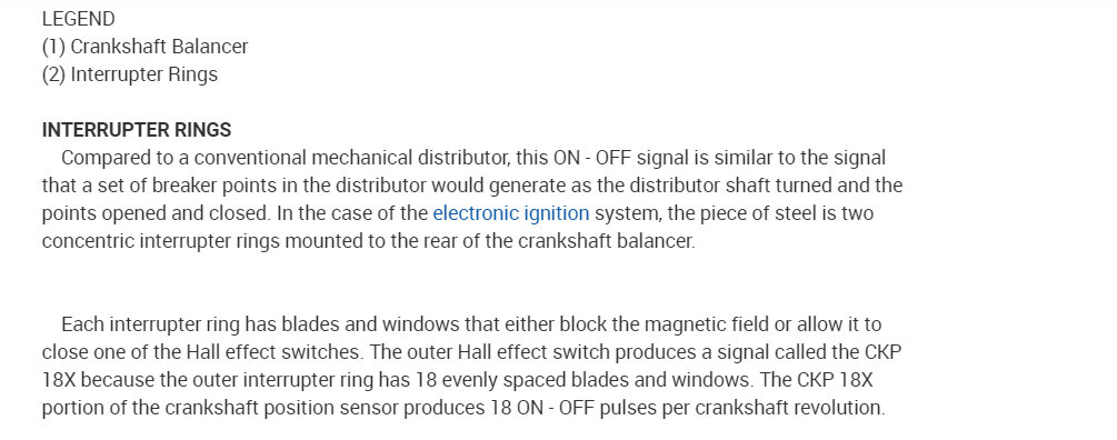

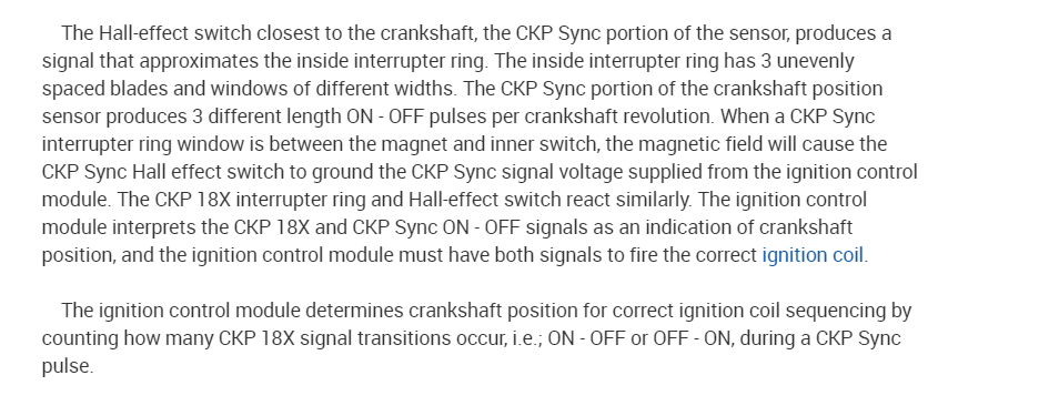

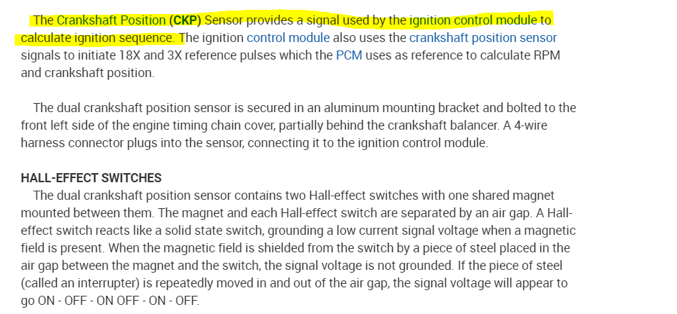

Okay, so let's go ahead and replace the other sensor used for ignition timing synchronization, the Crankshaft Position Sensor[CKP]. In the diagrams down below I have included a description and the instructions for the removal and installation of the CKP on your vehicle from the vehicle manufacturer. Please go through these guides and get back to us with what you are able to find out.
Thanks,
Alex
2CarPros
Monday, November 11th, 2019 AT 5:14 PM

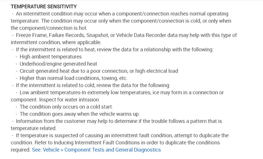

If I can jump in here is sounds like to me the engine coolant temperature sensor needs to be replaced. Here is a guide to walk you through the repair with instructions in the diagrams below to show you how on your car:

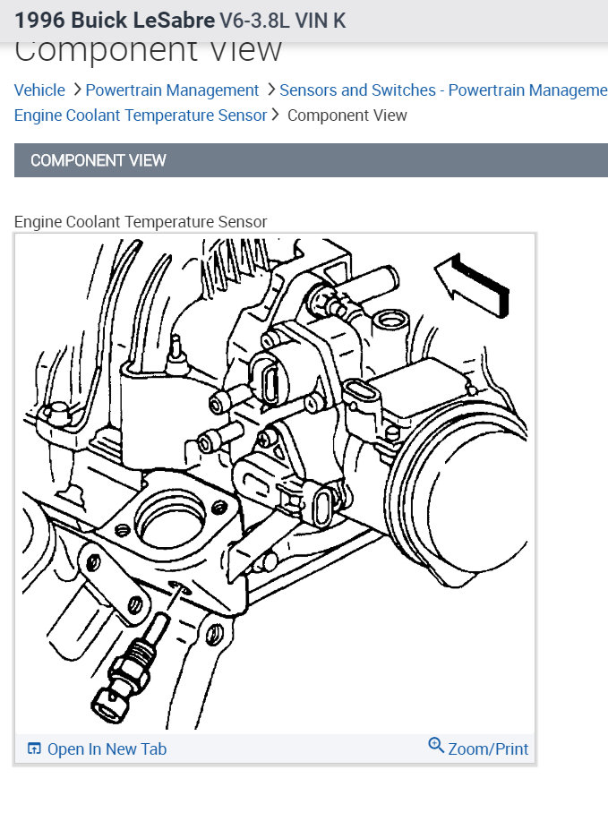

SCGRANTURISMO
  • 4,897 POSTS
Hello again,

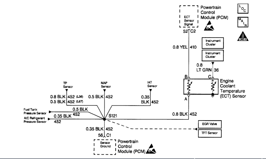

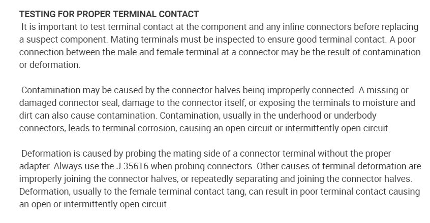

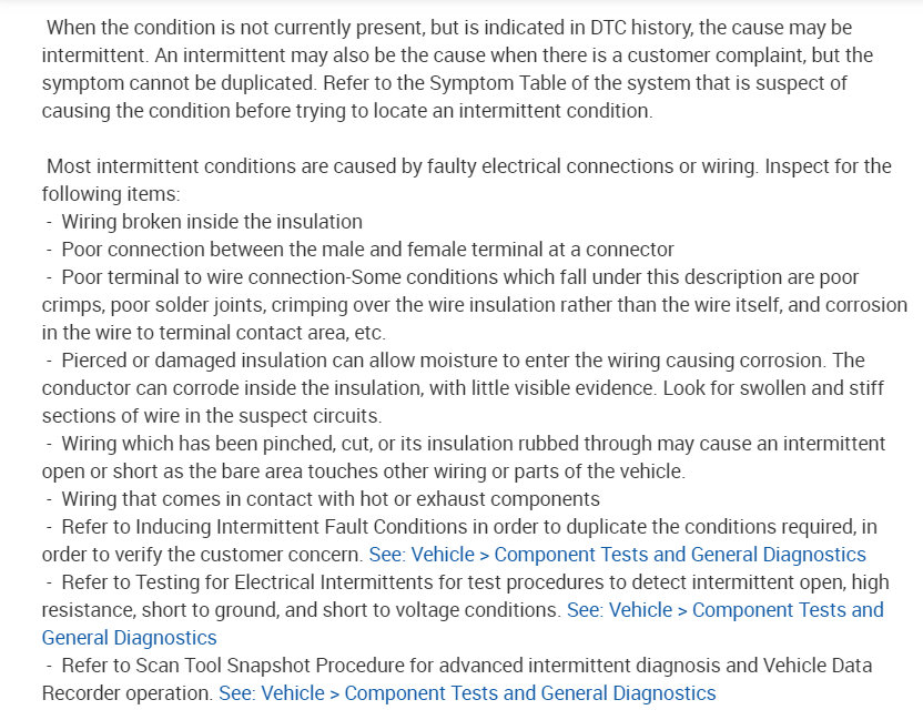

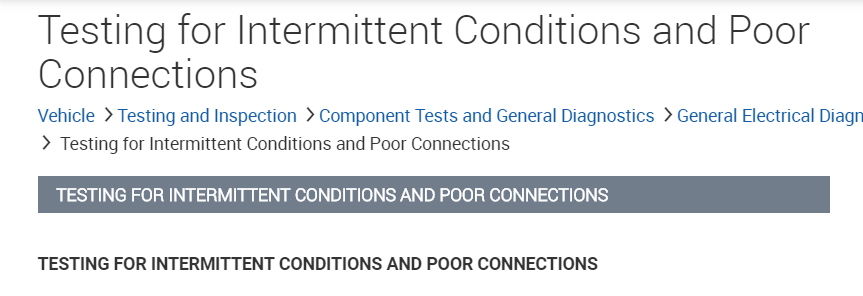

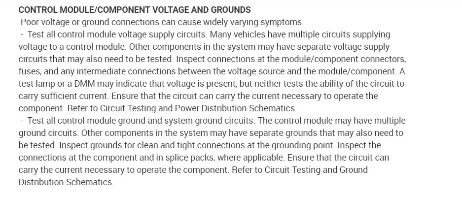

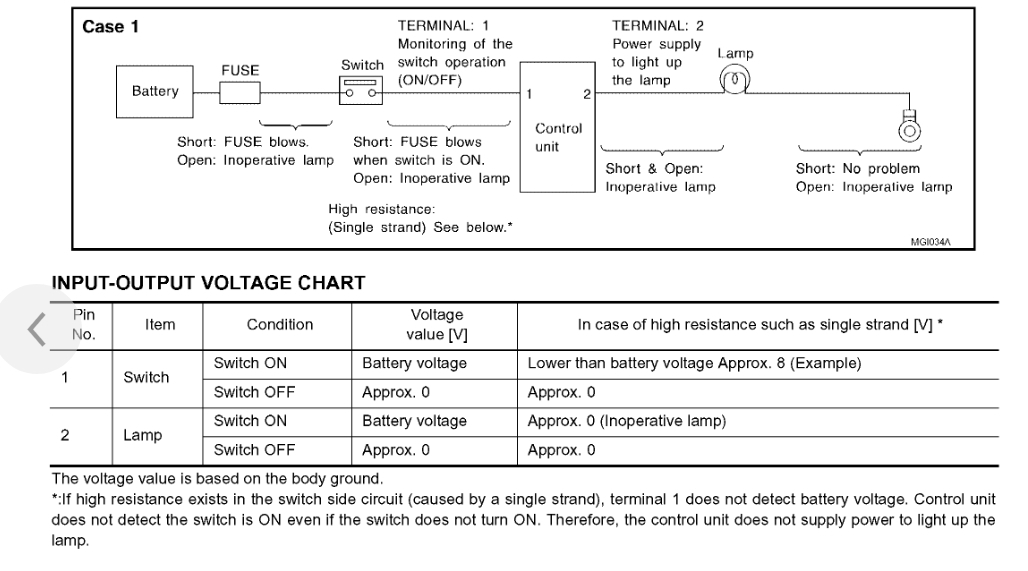

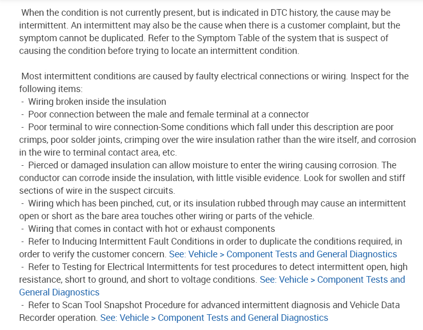

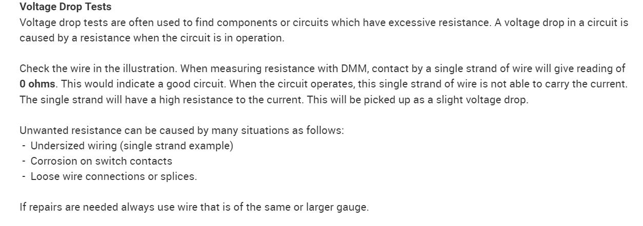

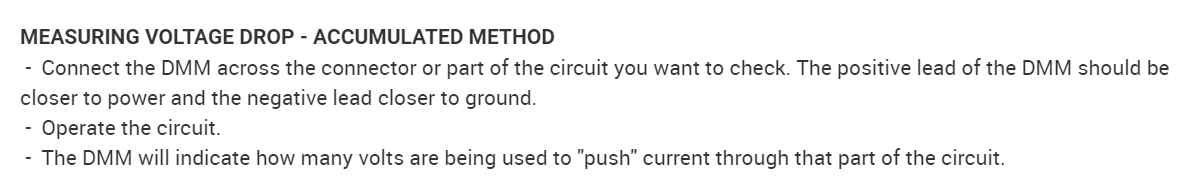

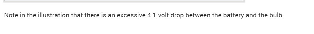

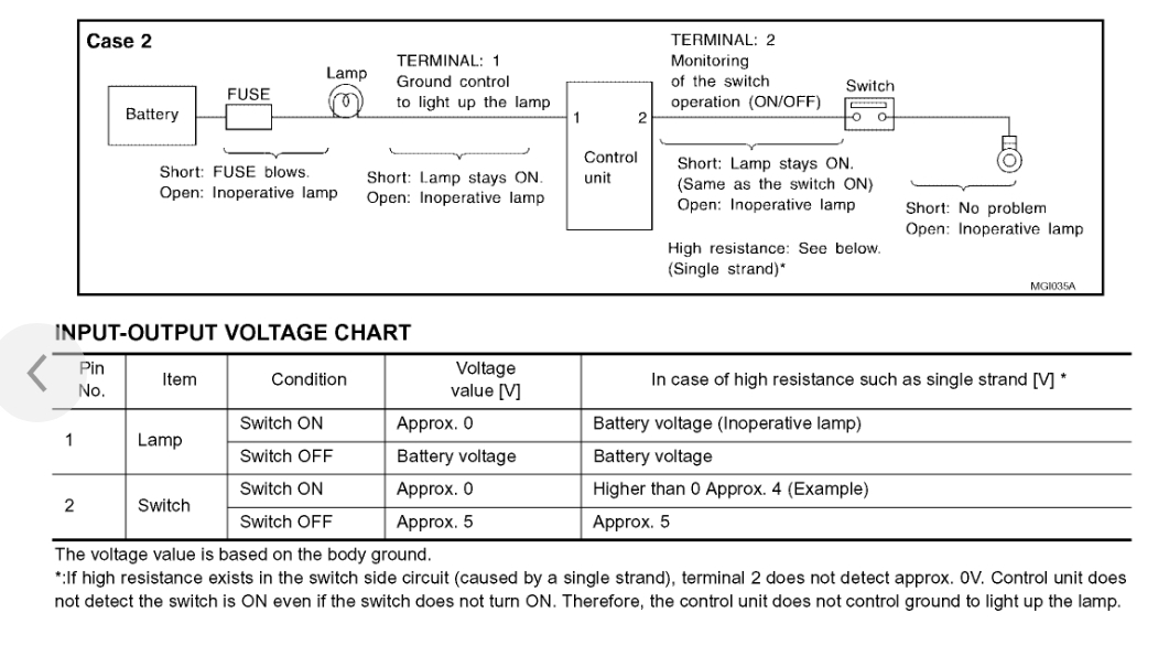

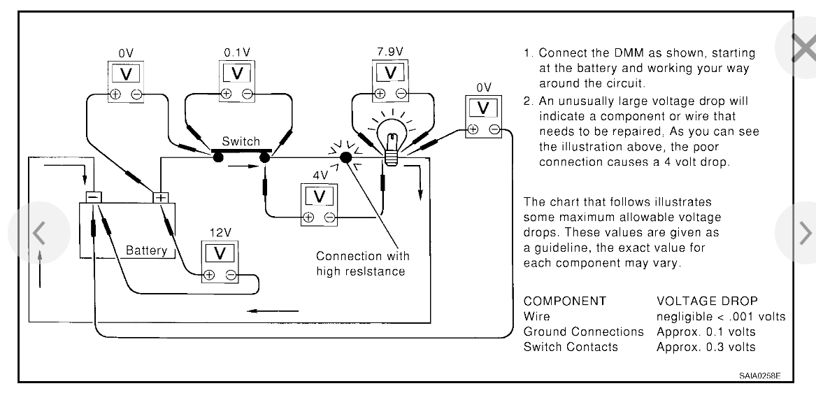

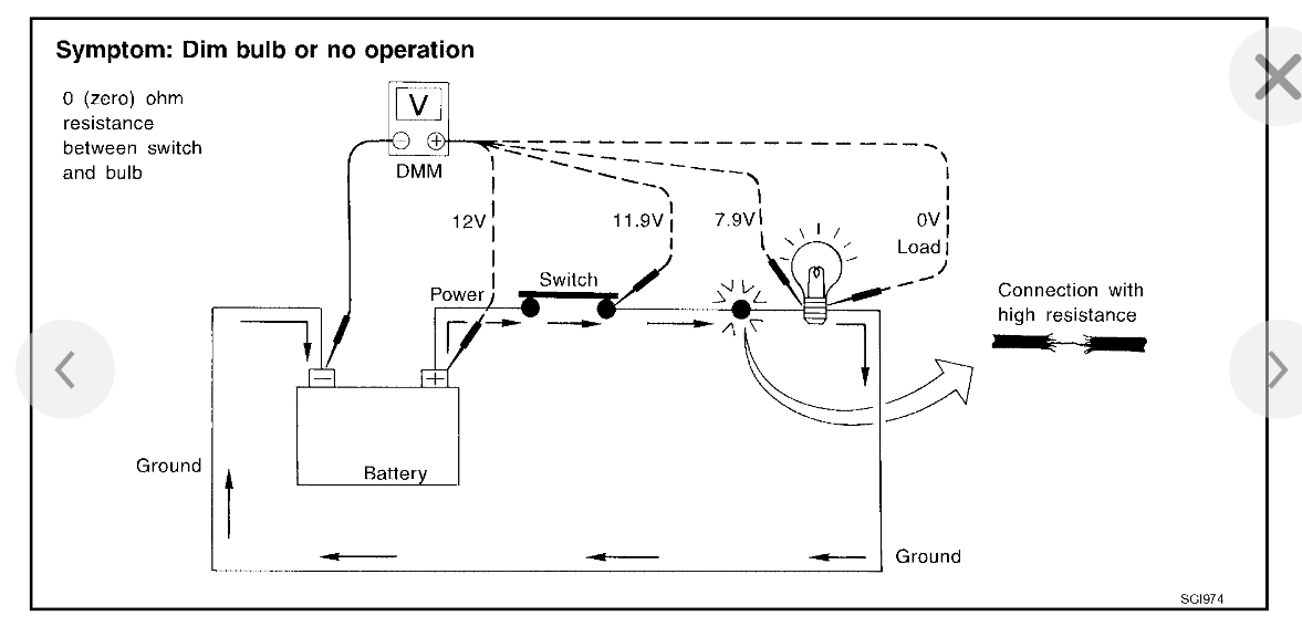

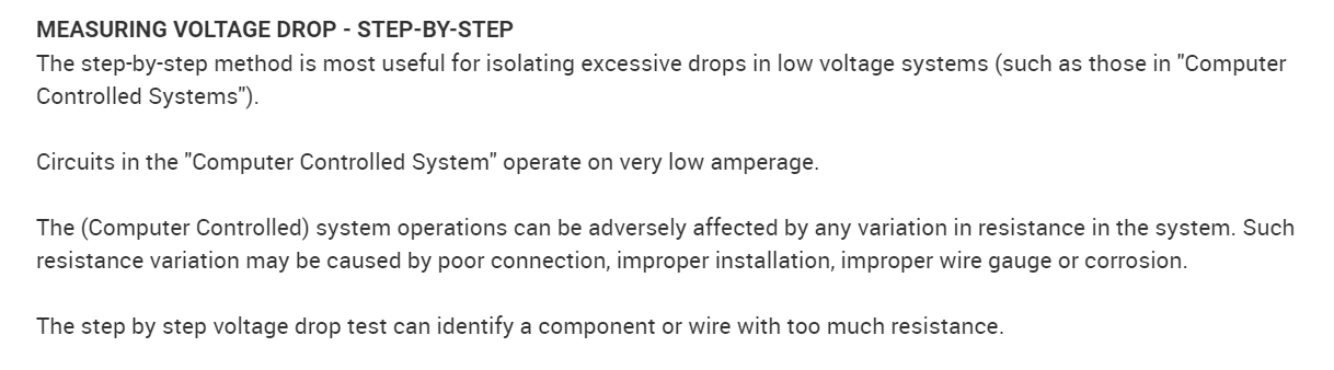

Okay, Have you inspected the ECT electrical connector and the wires for problems? In the diagrams down below I have included the wiring diagram for the ECT and a guide for finding intermittent and poor electrical connectors and for finding unwanted resistance in an automotive electrical circuit using the voltage drop method. Please go through these guides and get back to us with what you find out.
Thanks,
Alex
2CarPros

Hey guys, just want to tie a bow on this one. I never got though diagnosing the engine harness. Here's what actually happened: I towed the car to my regular mechanic and got it fixed. The replacement crankshaft sensor was not shimmed correctly. This allowed the crankshaft pulley tone ring tabs to strike the sensor, eventually breaking it (and bending tabs). So even though the crankshaft sensor was replaced the "non start" was still due to the new broken crankshaft sensor. My mechanic replaced the damaged sensor and bent the tone ring tabs back into place. It's been running fine for a few weeks now.
