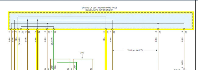

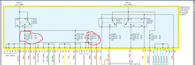

The drivers side rear running lights not working they were working.

DANNY ZACCARDI
It is in the wiring between the ignition and the junction box in the back underneath the truck.

Okay, first check the fuses I circled. Note there is one for the left and one for the right parking lamps. See pic 1. If they are both good confirm power out from the fuse box. If there is power out, check for power at the rear light junction box in the left side frame rail. See pic 2. Let me know what is found. The highlighted brown wire in pic 2 should have power when you have the lights on.
