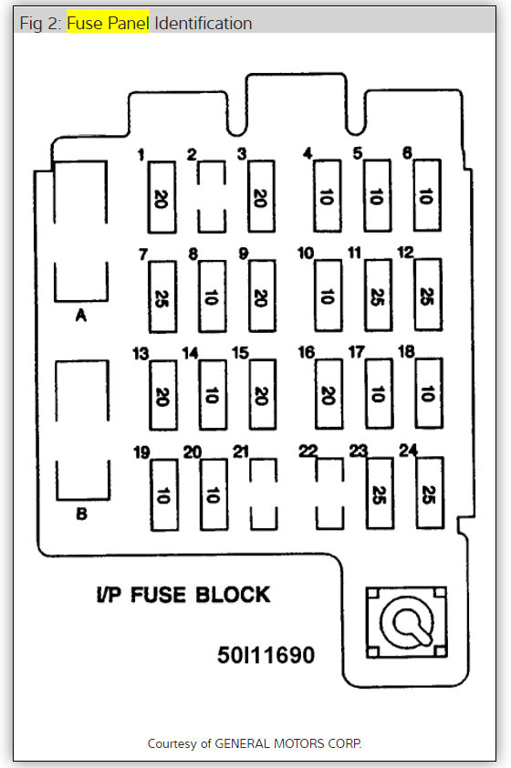

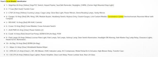

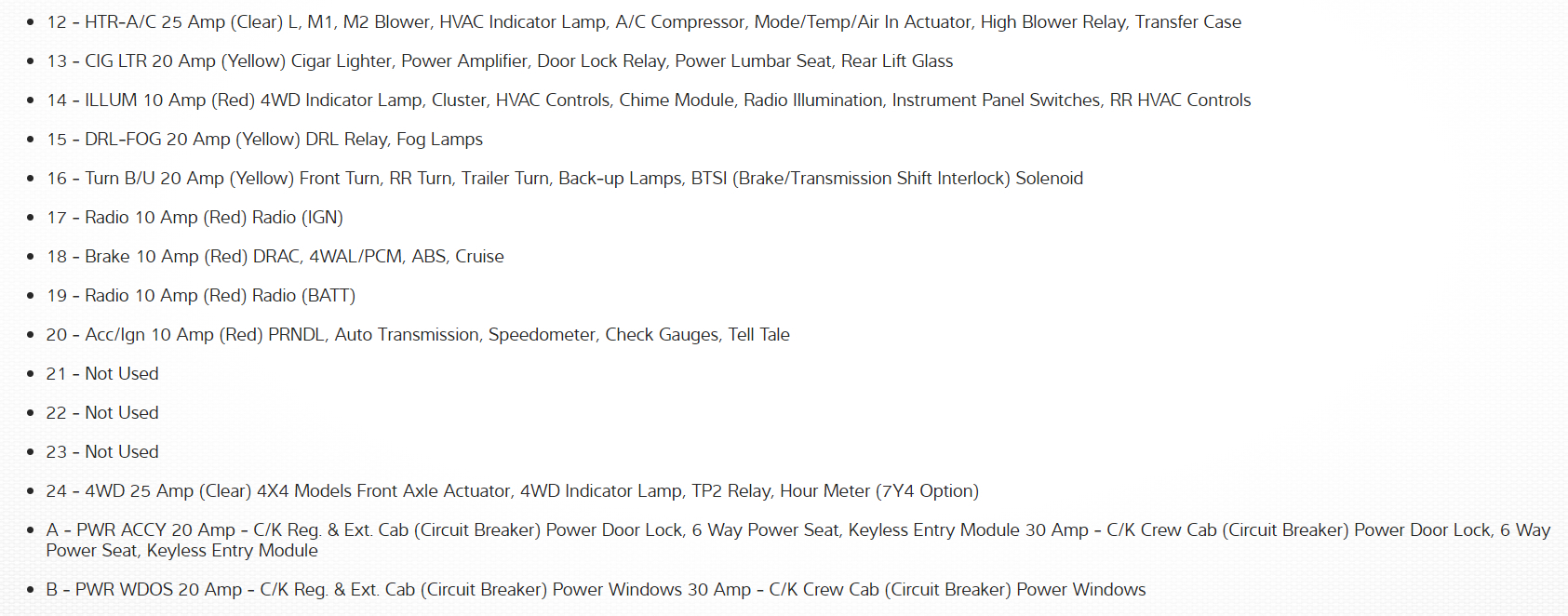

There is a tail light fuse you need to check first to see if there is power there if so follow the power through the switch to see if that is bad here is a guide to help you with the tests.
Here is a tail light wiring diagrams and the fuse location to help

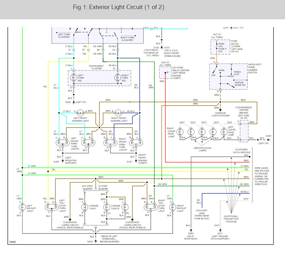

Tail lights do not turn on, brake lights do not turn on, when I turn the left signal in cab one light on the left side blinks and the right side has two lights blink. When right turn signal no lights come on. Pulled out lights and checked to see if power was getting to lights, and getting power in all slots on both sides of connection. Brake light turns on on the cab light, also has a solid running light.
So I decided as a temp fix I plugged in a 3 light hitch that plugs into the trailer connection, which works I get running lights on that device, and when I use a turn signal I get the left but not right. Also with this plugged in the right running light comes on but is very dim.
Another strange thing, when I turn on the right turn signal, where the license plate lights are, the one on the right side blinks.
I have checked all fuses under the hood and they all work, I checked all fuses inside the drivers side panel and none were bad.
I am at a loss with this, it is very confusing and I have no idea where to start to find out were the issue is. Any ideas would be greatly appreciated!
To include all details - the front lights and high beams run perfectly, running lights (yellow) run fine up front, turn signals work in the front but blink extremely fast up front. Nothing in the rear works except the plugin for the trailer, but turn signals are still screwy on it.

All of what you described is typical of a broken ground wire, particularly when you have lights flashing with the signals, like the license lamp. To verify this, you can use a test light or voltmeter to check for voltage on all the terminals on one of the malfunctioning bulbs. If you have the flat plastic base with four wires, one should have 12 volts with the brakes applied and a different one will have 12 volts with the tail lights turned on. The other two must have 0.0 volts. With a bad ground wire, you'll have voltage on all four terminals although the two ground terminals will usually not have the full 12 volts.
If the bulbs have the older round brass bases, you must have 0.0 volts on the brass base. You'll find around 6.0 to 8.0 volts there if there's a broken ground wire.
Another clue is when working with the signal lights only, the bulb on one side will act differently when you remove the mating bulb on the other side of the vehicle. That's because when current can't get to ground, it finds an alternate path through the bulb on the other side that it's tied to, then through a front bulb and to ground.

So I checked the ground coming off the wiring harness at the rear end, it was extremely rusted, in which I re spliced, new screw, and sanded the rust off that same area AFTER checking to make sure it was a proper ground.
Still did not work, had the same problem.
So what I did was run a wire from the battery post negative side, to that ground and it fixed my ground issue. So I was wondering if that was an issue in the ground between the battery and the truck, including cab to bed? Or if there was another issue I am not seeing. I have checked and re checked fuses including ones under the hood, and all test fine, or they are not broken.
Thank you for the reply, it did help, was able to fix my vehicles taillights minus running a ground from the front to the back. Is there a recommended gauge of wire I should run for the ground if I do keep it at its current condition? I believe right now its 16 or 18 ga. I was thinking of running 10 gauge but didn't want to waste that on a test.

10 gauge is severe overkill. That's good for 30 amps. You need a wire to handle less than 10 amps if it's for all the lights on the rear. 14 gauge is fine for that.
The bigger issue is running a new wire. My students knew that was never an acceptable solution because you don't know what happened to the original wire, so you don't know if the same thing will happen to the other wires in the same harness. As an example, suppose a harness fell down onto hot exhaust parts and one melted through the insulation and the wire grounded out. How long before the same thing happens to the next wire? That second one could result in wasting a real lot of time on the diagnosis when the problem never would have occurred in the first place if the cause of the first problem was found and repaired. You would have seen the other wires in danger of becoming grounded. Same is true when a harness is sliding back and forth on something as the engine rocks, or it's rubbing on a sharp metal bracket. The point is you want to know exactly where the cause of the problem is so you can prevent it from happening again.
Now that you found where on the bulb socket that needs to be grounded but currently isn't, use a test light instead. Ground the test light's ground lead to a good, paint-free and rust-free point. You can even use the end of that wire you used for testing. Place the probe on the point that is supposed to be grounded. When you turn on that light, you'll see the bulb gets only half brightness and the test light gets half brightness. That's because each bulb is getting only half of the 12 volts. Now you can move the test light's probe along the socket's ground wire to the next accessible test point. That's typically a connector. Sneak the probe in there and see if the test light is still half brightness or if it stays off. You're looking for the first place the test light stays off. That means you just passed over the break in the circuit.

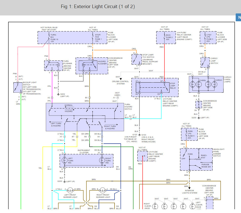

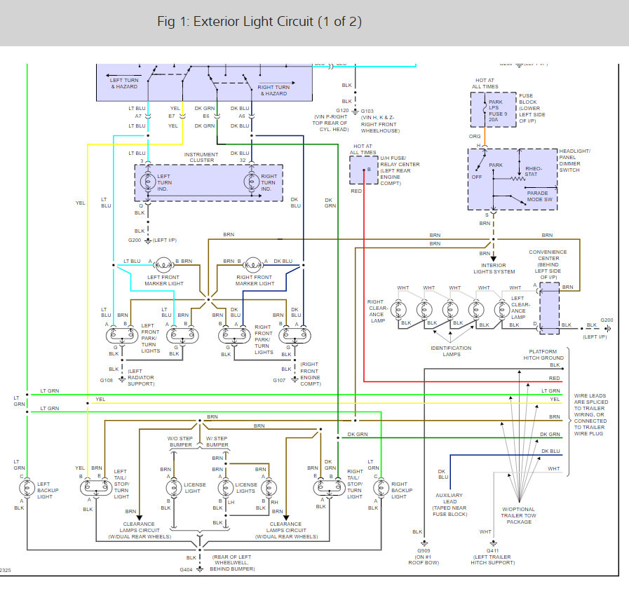

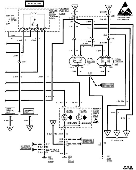

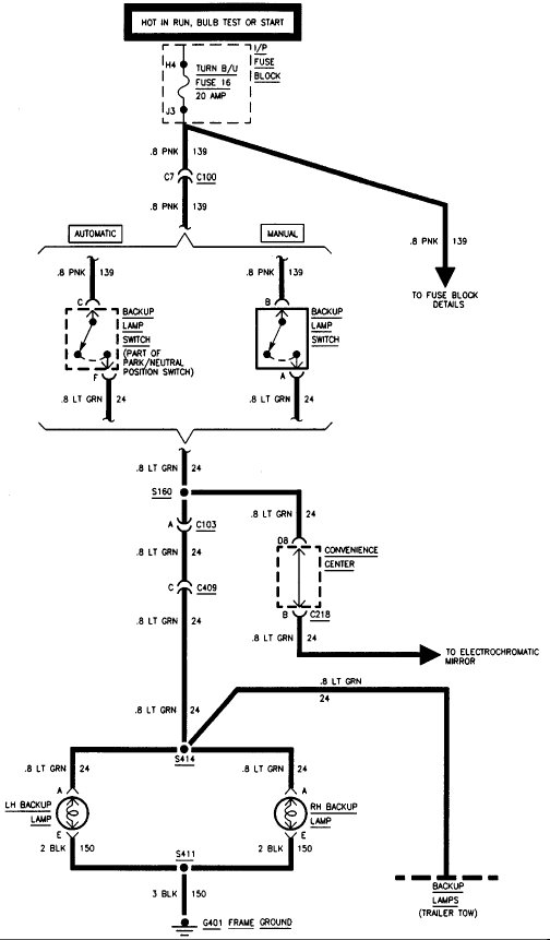

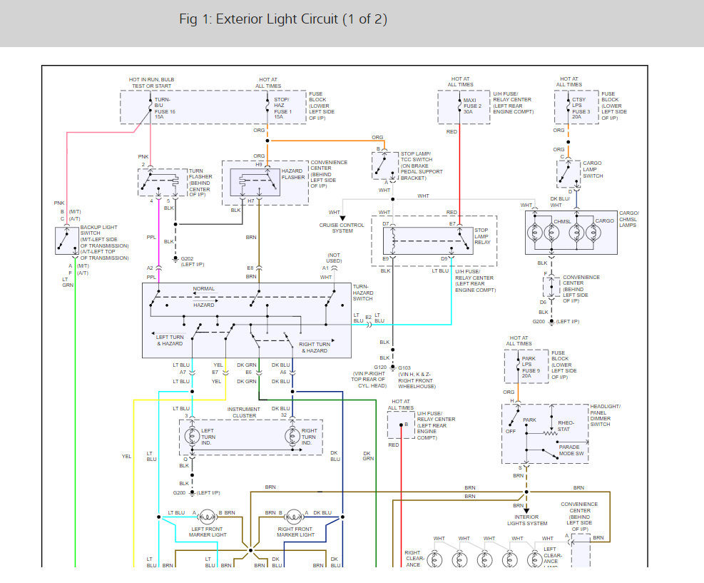

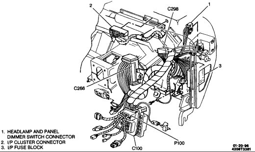

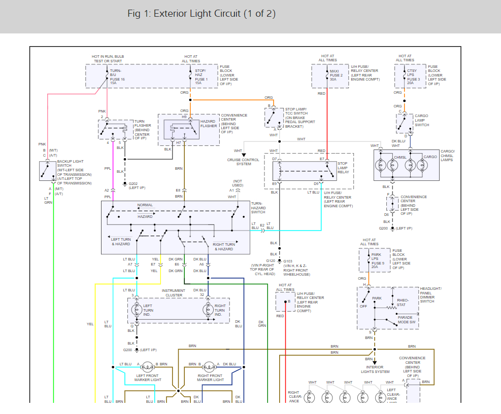

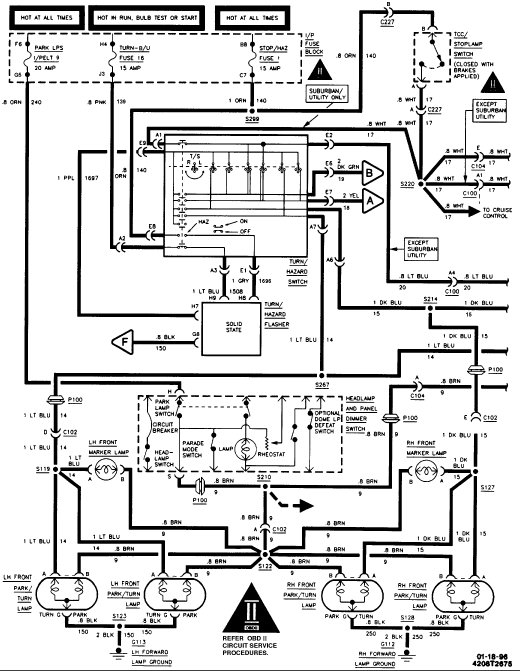

I am having the same issue with my 96 k 1500. I have replaced both tail light circuits, turn signal switch, brake switch and relay. Pulled the wiring harness all the way to connectors C104, C110, and C111. Inspected that section of harness, and oh I also have this same elusive wire. Mine was taped off at the rear and has power when you press the brake pedal but no other time.
-Take notice the 4 white wires coming from the TCC/stop lamp upper right corner. 2 of those wires have connector C100 A and C104 E as a point where they are running to. Look further down on image 1 and see brown wire going to connector C104 A.
-In image 2 if you look in the center you see yellow going to C104 C and dark green going to C104 D
- Have not found C104 A
- In 3rd image you see backup lamp wire coming from connector C100 C to the rear.
- You will notice in these images that brown, yellow, d green, and l green all run to rear harness connector C409 but the white shows it going to connector C298 F, stop lamp relay B pin and on page 1 to TCC, cruise, and turn hazard switch. Image 4 shows location of C298.
- Also note that C104, 110, & 111 are all listed as being on the rear lamp harness.
White wire is coming from C298 through the I/p connector to C104 and just runs down to the rear. Same length as other wires. White wire through C100 runs to relay switch in under hood fuse box. Now you are where I am with no brake lights. Everything has been replaced and checked. With multimeter and light. White wire acts like it is the rear brake light, and as far as factory goes. There are no splices or nothing out of the ordinary that does not look factory.

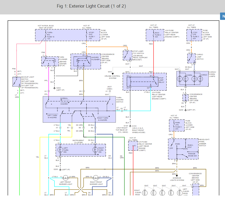

It sounds like the turn signal switch is no good but to be sure here is a guide to help you check for power and the wiring diagrams from mitchell1 so you can see how the system works a little better. Check for power in and out of the switch. Check out the diagrams (Below). Please let us know what you find. We are interested to see what it is.
