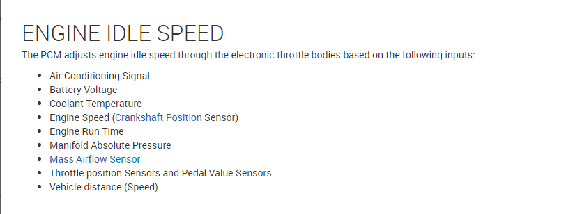

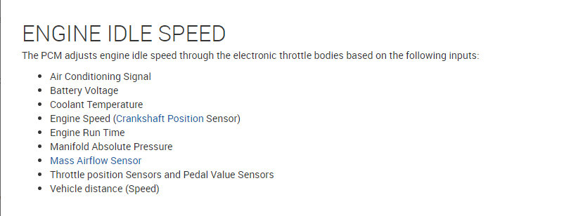

Below is the info on idle control and you will see that it is PCM controlled based on these inputs. So if there is an issue, I would hope there is a code for one of these systems to point us in that direction.
Lastly we may need to just do an ETC relearn which can only be done with a scan tool so we may need to seek a shop to try this if you do not have a scan tool that can do this.
Let's start with this info and go from there. Thanks
