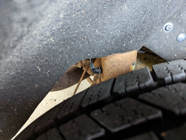

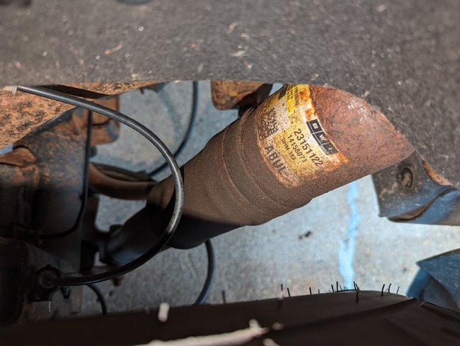

So today I went to look to see what it would take to replace the rear shocks. I learned that the shocks that are on the vehicle have an air line. The Monroe rear shocks I ordered do not. I found these shocks on Amazon (https://www.amazon.com/gp/product/B014RFE8RO) which appear to be a replacement and fit the 2015 Suburban LTZ with air but now I am learning that I need a scan tool to replace and set them up correctly. I do not have a scan tool.
Since I am not much of a mechanic, I am now starting to lean to sending the stuff back and just have the dealership do it but I cannot swing the $4,100,00. are there alternative Magnride solutions that are not OEM but satisfy as an adequate replacement? The dealership said they would use the parts I had to replace, which is very odd, they would even allow it and they would charge about $700.00 to install and complete an alignment.

Okay, if yours have an air line it must have the automatic leveling and Magnaride as well. That is about the most expensive system GM offered at the time. The aftermarket doesn't really offer much other than ways to eliminate it, which is what the parts you have should do.
The dealer will use your parts, likely because they cannot get the OE parts in any reasonable time and want your business.
The only reason for a scan tool would be to reprogram the suspension control module after you removed the OE magnaride parts. That is what the piece you bought from Xineering should do.

Z95 has Magnaride at both ends plus air at the rear for the auto leveling. If you only have an air line to the rear you might want to check it closer, it almost sounds like someone already changed some parts. Your dash sticker shows the Z95 option which is 4-wheel Magnaride.
Arnott used to make some that fit but I haven't looked in a while.
These look to be Z95 compatible, but you need to see what parts of the system are still there before buying them.
