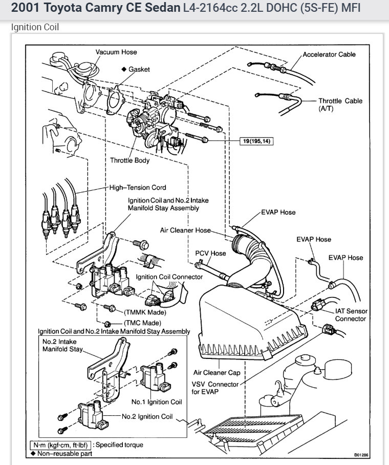

Hi there, I am currently working on my sister in law's car it is the LE model. We exchanged the transmission with a identical Camry, I added Toyota ATF IV transmission fluid, added coolant, made sure all wire harnesses are connected, all sensors connected. When I first turned the car on it started having pretty rough idle, check engine light came on and gave me codes: P0300, p0301, p0302, p0303 and p0304. I checked all vacuum hoses okay, checked MAF sensor, okay. Replaced spark plugs,checked volts on the ignition coils, checked and cleaned fuel injectors, also checked the connectors. I changed the camshaft sensor. When I start the car it gives a 2,500 close to 3,000 rpm's then drops to maybe 600 or 500 rpm's then it vibrates/shakes like if it is going to shut off and sometimes it does. What can it be?

These are all misfire codes. I am wondering if you got all the computer grounds are connected. Did it run okay before you began? Do you have the air intake tube connected to the throttle body? Please let us know.

Yes, I double checked my computer grounds, and also I do have my intake tube connected and as far as it running okay I was told it did run okay and it idled okay too. I did not actually run the car myself (due to transmission not working) but I did have on idle and it did not sound or shake the way it is doing it now. I also forgot to mention on her flex pipe it had a small hole so I removed it and replaced it with a AutoZone flex pipe. Could that maybe be causing the rough idling?

Only if the pipe is leaking, it will bring in fresh air which will fool the computer causing it to run rough. Also the IAC motor on these engine gets dirty causing the unit not to work also I have seen one of the two igniters (coils) go out and finally there is a map sensor that is very sensitive which go out as well. Here is a guide to help you clean the IAC:

Okay, so I cleaned the throttle bore, and now it stopped shaking/vibrating. So now when I turn on the car it gives a strong idle at 3,000 rpm's and then drops to 2,000 rpm's after three minutes or so it drops to 1,100 rpm's and stays there.

This can be normal as the computer relearns. I would drive it for about fifty miles to see what happens. This guide can help as well:

Thank you ken everything worked out great.
