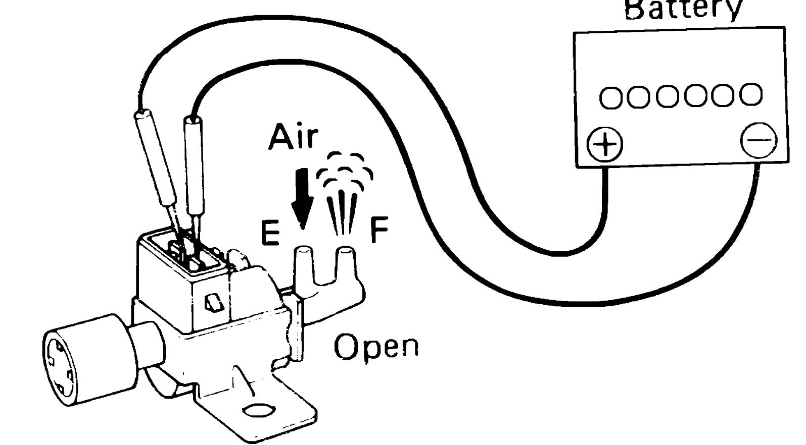

Vacuum solenoid test. Image below.
1. Apply battery voltage to vacuum switching valve terminals.
2. Blow air into pipe ``E, '' Fig. 34, and ensure air flows from pipe ``F.''
3. Disconnect voltage from valve, then blow air into pipe ``E, '' and ensure air flows from air filter at bottom of valve.
4. If air flow is not as described, replace valve.
5. Check for continuity between terminals and valve body and replace valve if continuity exists.
6. Measure resistance between valve terminals and replace valve if resistance does not measure 33-39 ohms at 68°F.

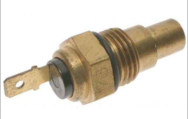

If the PCM thinks it always cold it will hold the rpm high and richen the mix both of which can cause issues. The catch now is to determine if it's the wiring or sender unit, or is the engine really staying cold. Air in the system could cause a bad reading if the sender had an air pocket around it. What you can do is use an IR thermometer and measure the temperature of the various parts of the system. The fans shouldn't even turn on if the engine isn't getting hot, they respond to the sender unit and activate only at high coolant temperatures or if you are turning the AC on.

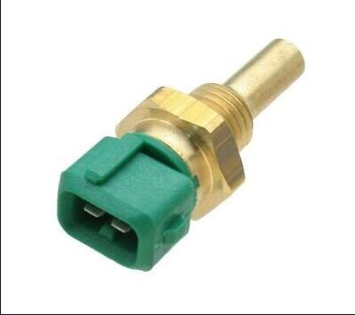

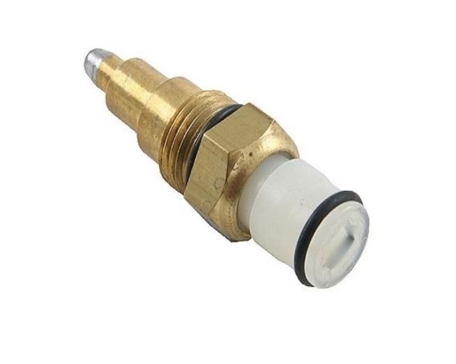

Depending on the emissions package you can have 2 or three temperature sending units. The California versions have 3 while the rest of the country got 2, on the Cali models two are just switches with the third being the sender for the dash. On the federal versions, one is a switch while the other is the dash sender.
The one for the dash unit will have a single slip on connector like the first one. The others will look like the second two pictures. Which did you change out?
Saturday, December 19th, 2020 AT 7:58 PM
TRISCUIT
  • 76 POSTS
I changed out the sender to the ECU which is the third picture with the green plug. It was pretty inexpensive so I just replaced it altogether.

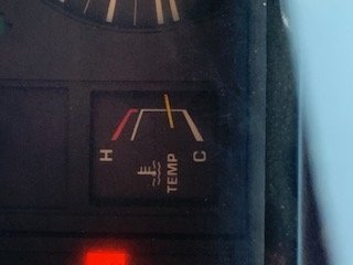

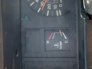

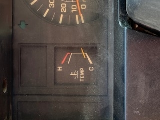

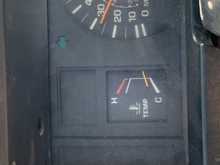

I found some of the problem. I removed my fan and the clutch and the engine temp gauge came up to the level it used to years ago (second picture). The fan clutch is part of the problem. The idle feels smoother now most of the time but still much too fast, as though the computer isn't receiving the signal saying the engine is up to operating temperature.
The Cold Start Injector Timing Sender ohms at about 31 when cold and 55 when hot so it's within spec. I started the truck cold with the CST unplugged and it started only slightly worse so I'm going to check the Cold Start injector tomorrow to see if it's firing when cold.
The engine temperature gauge stayed nearly 100% steady for all of my driving which included the freeway and street. After a couple of errands I headed home and only then the gauge start to creep up, so I turned on the heat until getting onto the freeway and it came down to the normal level again, still without the fan installed. Once I got off of the freeway the gauge took longer to drop and made it to as high as a third of the way to red. Once I parked I let the truck idle and the gauge rose slowly until about halfway to red and then I turned the engine off.
The following are different temperature readings I got as the engine cooled. By the time I finished the temp gauge was at about 1/4 and still dropping so it's safe to say the thermostat, sender to gauge and sender to ECU are all working just fine.
First picture - after idling for 9 minutes.
Second picture - as high as the gauge went before heading home.
Third picture - the gauge after driving on the freeway and letting the truck sit and idle for a few seconds after getting home.
Thermostat Housing: 215
Thermostat Neck: 192
Upper Radiator Hose at thermostat housing side: 201
Upper Radiator Hose at radiator side: 152
Valve Cover: 167
Exhaust Manifold: 268
Tuesday, December 22nd, 2020 AT 4:14 PM

Those temperatures look good. I would say the fan clutch is locked. On some a simple test it to spin the fan on a cold engine, it normally will go about 2-3 turns and stop. However that is on a fan that isn't cooling. You have the opposite issue, the fan isn't unlocking when it's cold and warming up. To test them you can usually run the engine for a few minutes until the coolant just starts to warm up. Shut the engine off and try to spin the fan now. It should spin 2-3 turns at least and be somewhat easy to move. If it won't spin at all the clutch is bad internally and not responding to the temperature change.
