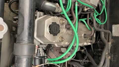

I've done a lot of work on this truck over many years attempting to get it to a smooth running, reliable machine. I've currently (still) got a rough idle that has become smoother/quieter as I've repaired and changed things but still isn't where it should be. The idle becomes more intense when shifted to anything other than Park of Neutral.
I have done the following over the years (some multiple times, some once. I do not currently drive the truck. It's been driven about 3,000 miles in 6.5 years):
1. Rebuilt engine with metal-backed timing chain guide (the motor mounts look fine)
2. Machined and rebuilt the cylinder head and adjusted the valve lash on intake and exhaust (cold and warm) = no change.
3. Installed all new vacuum hoses = no change.
4. Sprayed the vacuum hoses, intake manifold, etc with carburetor cleaner checking for changes in idle = Nothing.
5. New (installed years ago, but again, I barely drive the truck) spark plugs (NGK's, just like the 22REs like).
6. Recently checked the plugs for signs of engine health = they look fine/normal.
7. Put in 4 new Toyota OEM spark plug wires (no cheap wires) + ignition wire = No significant change.
8. Pulled each plug wire at the spark plug/engine = all 4 produced an engine stumble.
9. New distributor and cap (quality, not cheap) = No noticeable change.
10. New OEM TPS installed and meticulously adjusted via 4crawler.com directions = slight power increase, slight idle improvement.
11. New transmission mount (old one was falling apart) = the shake at idle is less jarring but still as active.
12. New marine battery cables.
13. Tested VAFM while installed. It passed every test except for the last one. (Write-up of instructions are at 4crawler.com) Not sure about the last test; waiting for outside input on replacing it because it's an expensive part.
14. R and R Oxygen sensor with OEM Denso sensor. Previous once was a Bosch which does not work well for the 22RE. New Denso sensor has produced a noticeable power gain, improved responsiveness, and the "rich" burning gasoline smell has been lessened; rough idle still present.
15. Pulled spark plugs again, checked and re-gaped them = small increase in power; idle still the same.
16. Checked for engine timing with sensor jumpered. It was coming in around 14 BTDC so I adjusted the distributor to get 5 BTDC. The distributor is NOT swung all the way to one side, rather it's pretty centered, so I don't think it's off a tooth but I don't have a tach so I can't check the idle RPMs. I'm going to buy a handheld one in the next week and re-check the timing.
17. Adjusted the valve lash on both intake and exhaust to spec listed on 22reperformance.com.
18. Removed the charcoal canister and attempted to "clean" it. Improved airflow from bottom spout through top ones but not vice-versa. I'd noticed that there's a lot of off-gasing when I open my gas cap at all.
19. Oh yeah, the intake manifold was thoroughly cleaned when I rebuilt the engine. I also adjusted the stop screw for the accelerator cable (the one that goes from the throttle body to the accelerator pedal). I do need a new detent cable because it's completely overstretched.
I believe I have a misfire but I don't know what I should be hearing. I remember reading somewhere that holding a towel in front of the exhaust pipe should show a smooth flow and that the towel shouldn't be sucked in or be "puffing" back and forth like someone is blowing small puffs of air at it, repeatedly. No idea if that's true but a towel held there responds like small puffs are being blown at it.
I've had an injector replaced professionally which immediately produced a complete, overnight parasitic drain from the alternator. I've since fixed it after much hunting for the source. Nothing else has been done by anyone other than me in about 3 years.
My next steps are to try to jiggle the intake connectors to see if the engine stumbles, do another timing adjustment once I get the handheld tachometer, test the pickup coil(s) and ignition coil(s), and I may also try spraying carburetor cleaner for leaks one more time.
I'm really wondering about the engine idle and timing. It seems to need to idle high (it sounds high/fast, but what do I know?) so it doesn't stumble. But I'm running out of things to do and need help. What am I missing?

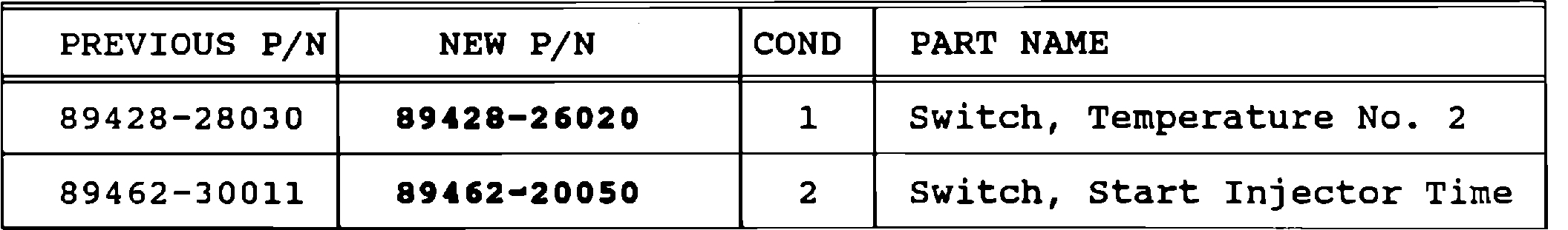

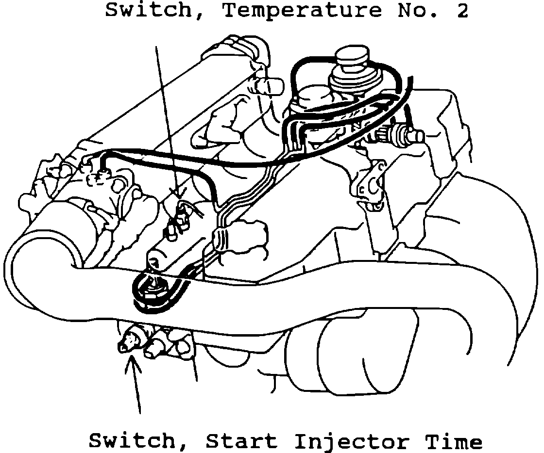

TITLE 22R-E, 22R-TE HARD STARTING/ROUGH IDLE

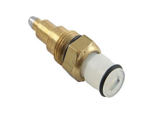

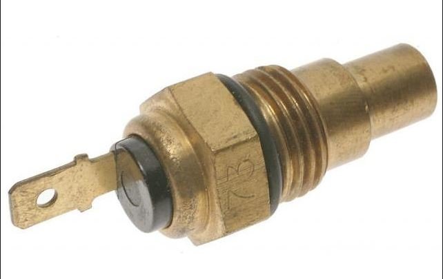

The following parts are now available to improve the start-ability and idle stability after a hot dead soak or an extended dead soak.
pic 1
MODIFICATION INFORMATION:
pic 2

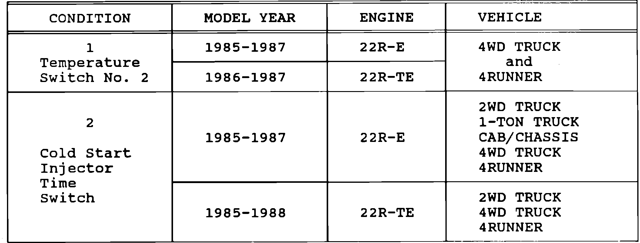

YEAR/MODEL APPLICATION:
pic 3
PART NUMBER INFORMATION:
PRODUCTION CHANGE INFORMATION:

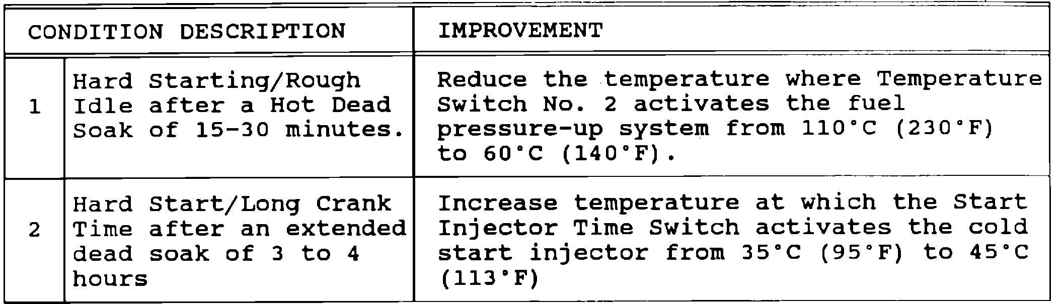

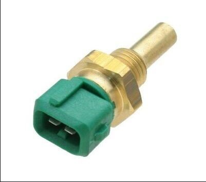

CONDITION 1: Temperature Switch No. 2 specification (same as
field fix) changed at beginning of 1988 model year.
CONDITION 2: ECU modification at beginning of 1988 model year to
activate cold start injector at higher temperature (22R-E only).
REPAIR PROCEDURE:
1. Replace cold start injector time switch with the new part.
pic 4

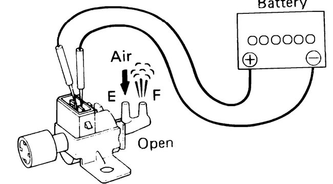

2. On vehicles equipped with a pressure-up system, (see application chart on page 1) also replace Temperature Switch No. 2 with the modified one.
pic 5

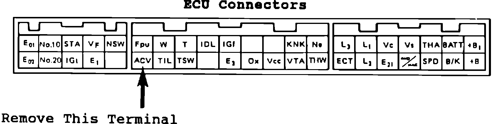

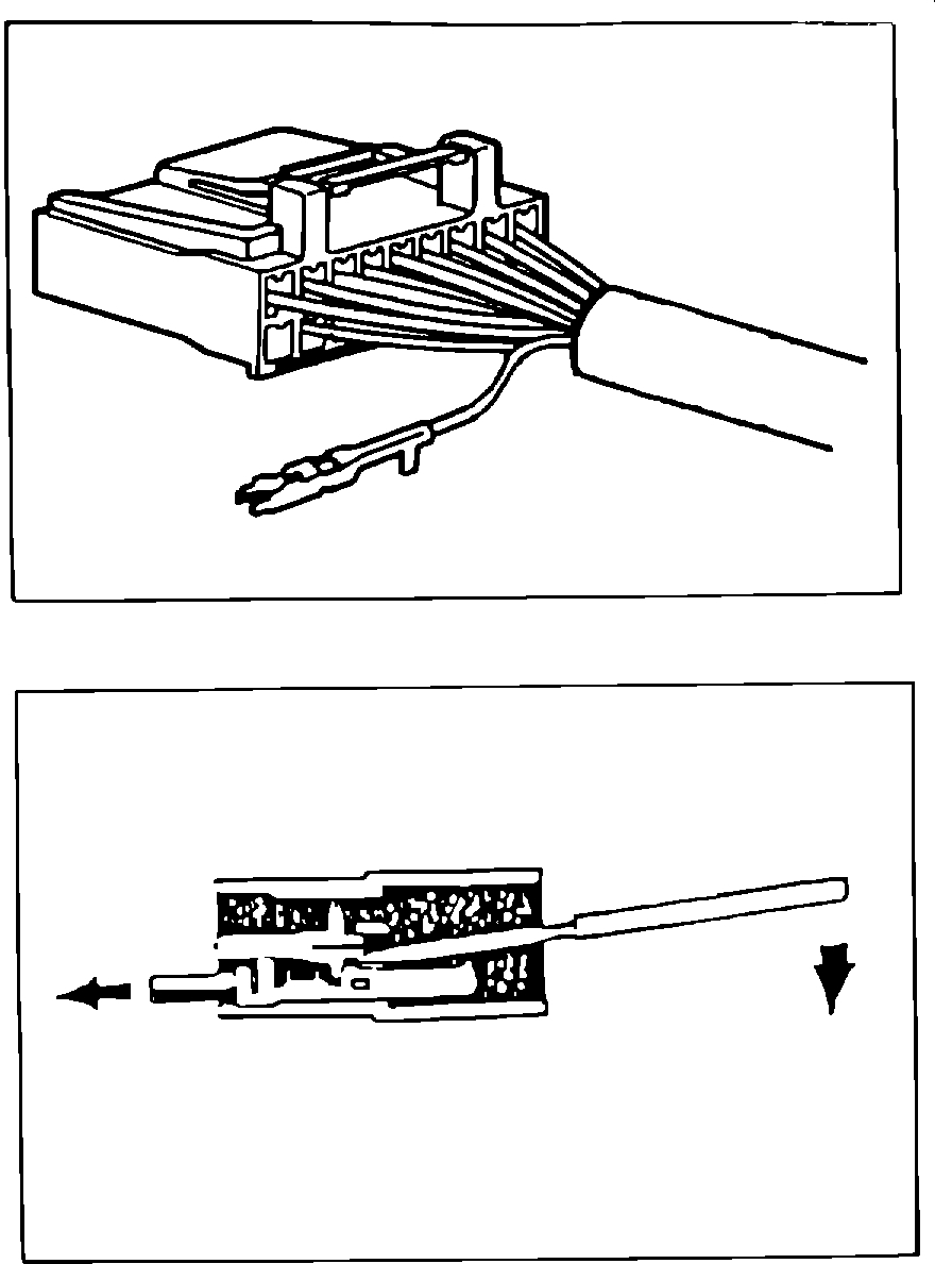

3. For vehicles equipped with Air Conditioning, the ACV terminal must be disconnected from the ECU when installing the modified Temperature Switch No. 2 (Condition 1). This is necessary to prevent the Engine Idle-Up from working continuously after warm up.

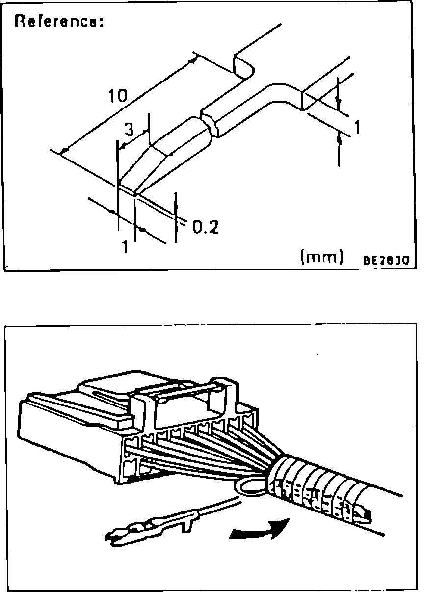

HOW TO REMOVE THE WIRE TERMINAL
pic 6
1. Insert a miniature screwdriver from the open end. Move the locking clip to the unlocking direction ( ) and hold it in this position.
Do not apply excessive force to the terminal.
Do not pry the terminal with the screwdriver.
2. Carefully remove the terminal without using excessive force.
pic 7
3. Wrap the removed wire terminal with electrical tape. Tuck the terminal into the harness protector and secure with electrical tape.

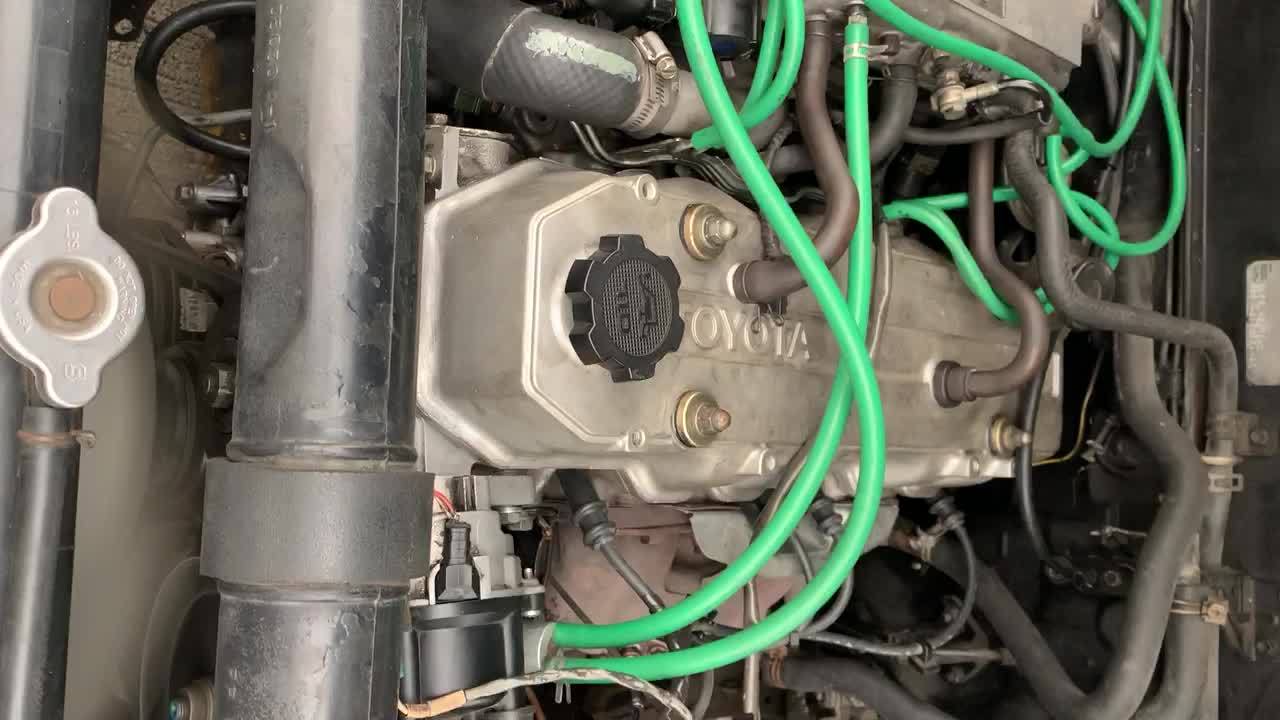

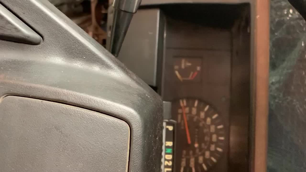

I went back out today and pulled out the ignition coil and igniter assembly, tested them and cleaned up the contacts. It tested within spec for both the primary and secondary readings and the truck started when I got it put back in and connected. Cool.
I noticed the engine idle slowed and smoothed out a bit once the truck warmed up, for a second I thought it was going to start sputtering and hesitating but it never did. I pulled out my test light to check the timing again and it’s holding steady at 12 BTDC and 5 BTDC - jumpered. Then I decided to move the spark plug pickup connector to all four wires and watch the light fire. My number two spark plug is firing much faster than the other 3. That’s the fuel injector that got a new connector and I noticed the spark plug Itself is slightly off center like a PO may have cross threaded it. It still seats fit and looks the same as the others.

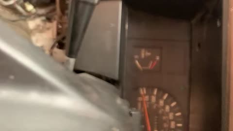

Below is a video of the engine idling. I tried to get one of the timing light going but the camera wasn’t picking up the light’s firing frequency accurately at all. The second video is of the idle change when I switch out of Park/Neutral into any other gear. Again the roughness of the idle isn’t given justice in the video but you still see and hear some of it.
Sep 10, 2020 at 10:48 AM
  • 110,241 POSTS

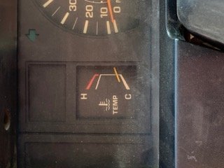

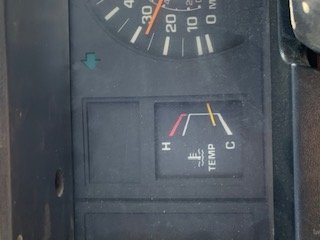

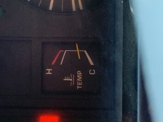

I did watch the video and understand what you mean. Tell me, is the temperature gauge always on hot? Also, the idea that the one cylinder seems to be firing faster than the others is odd. Are you sure there isn't a crack in the distributor cap or wires arcing at some point?

Joe: the temperature gauge is not on hot, it never is. It actually barely moves up beyond the minimum line when it's completely warmed up. I think you saw the top mark of the gauge, not the actual needle. I went out today and accidentally bumped the external part of the pickup coil (that is exposed on the distributor case) and guess what? the engine stumbled a bit then came back. So, i just got a clue that it needs to be replaced. The wires are a bit too exposed so that may be causing a problem and i'm going to go out tonight and see if i can spot any arcing on the wires despite the fact that they're brand new. I wrapped a piece of electrical tape around one of the pickup coil wires and it seems like the idle had smoothed out a bit. I'll include a picture below.

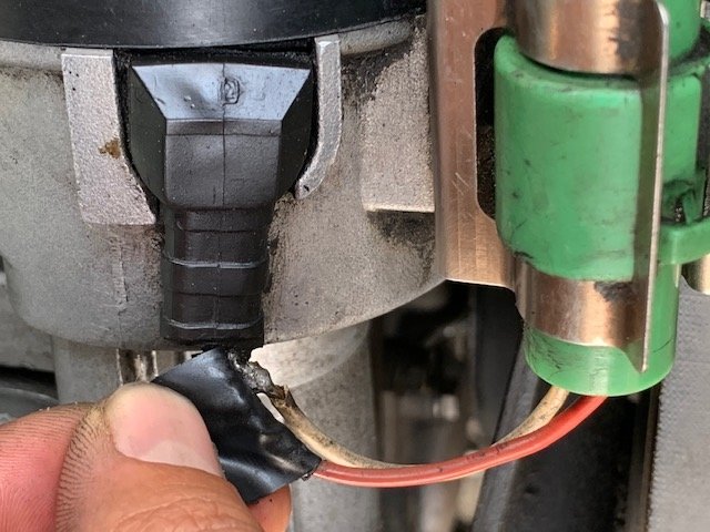

Does it seem like that wire exposure on the p/u coil could be the problem?? Thanks, again.
Sep 13, 2020 at 9:43 AM
  • 110,241 POSTS
Anything is possible. Since it was soldered it concerns me.

I did some reading regarding your suggestion about the Cold Start Injector and the CSI Time Switch and it seems like it could be an issue, but not explicitly. Ill test the Time Switch soon but I don't have the symptomatic hard starts in the morning/when it's cold and it's rarely below 65 degrees where I live. The truck has an exhaust leak at the manifold/cylinder head so I smell more than I should coming from the engine but noticed the old oil smelled like gasoline as well but I don't have any smoke coming from the exhaust pipe, I don't lose acceleration when driving and the spark plugs look normal. The MPG was low but since changing the O2 sensor, readjusting the TPS and changing the oil I haven't driven the truck around to see if the MPG has changed.
It seems like something is up with the exhaust or the fuel system so I'm going to look back through my record of things I have done over the years and will send a message about that soon, as well. Would an exhaust leak cause these symptoms? And, why would water come from the tailpipe after installing the new pickup coil?

Vacuum solenoid test. Image below.
1. Apply battery voltage to vacuum switching valve terminals.
2. Blow air into pipe ``E,'' Fig. 34, and ensure air flows from pipe ``F.''
3. Disconnect voltage from valve, then blow air into pipe ``E,'' and ensure air flows from air filter at bottom of valve.
4. If air flow is not as described, replace valve.
5. Check for continuity between terminals and valve body and replace valve if continuity exists.

I actually blocked the EGR port at the intake manifold right after sending you the last message per the instructions at LC Engineering, 22RE specialists. It starts fine like usual and runs a tad smoother but nothing extreme. I'm going to go buy more carb cleaner tomorrow, remove the EGR again, and clean it for another 10+ hours. Ill also recheck the modulator per your instructions. My BVSV is new (I broke the nipples on the last one) and I sprayed brake cleaner through the metal pipes connecting the vacuum lines at both ends for both ports to the EGR. The cleaner was crystal clear and blasted right through.
My engine is still not coming up to operating temperature and after blocking the EGR it seems like the missing goes away or reduces significantly. I'm noticing that my cold-start idle is working but the engine never seems to drop back to a warm temperature idle. The idle actually seemed smoother but much too fast. Something is up with the engine not reaching operating temperature. The thermostat and sender to ECU are new, the upper radiator hose heats up slowly and gets hot, there are no leaks, and the heater in the truck gets hot. I burped the cooling system again and will do it one more time in hopes that there are still trapped air bubbles. The temperature gauge's position in the truck varies ever-so-slightly but barely moves past the minimum temp line. When it does it's only by about 1/8" which is too low, then it'll go back down to the minimum line and my previous thermo read the same.
I suppose testing the sender to gauge and ECU readings are next? I'm also looking into how to find out if my fan is turning on too soon. If the engine isn't coming up to temperature that could certainly be why the idle is rough and too fast.
Oh! I knew nothing of the jiggle valve on thermostats until I stumbled on a thread discussing position and temperature variance. I have no idea how I installed the thermostat in relation to the jiggle valve but it seems that having it installed correctly cools the engine down more so even if mine is not at the 6 o'clock position I'd have a warmer engine, not a cooler engine. I'm inclined to leave it for now.

If the PCM thinks it always cold it will hold the rpm high and richen the mix both of which can cause issues. The catch now is to determine if it's the wiring or sender unit, or is the engine really staying cold. Air in the system could cause a bad reading if the sender had an air pocket around it. What you can do is use an IR thermometer and measure the temperature of the various parts of the system. The fans shouldn't even turn on if the engine isn't getting hot, they respond to the sender unit and activate only at high coolant temperatures or if you are turning the AC on.
Depending on the emissions package you can have 2 or three temperature sending units. The California versions have 3 while the rest of the country got 2, on the Cali models two are just switches with the third being the sender for the dash. On the federal versions, one is a switch while the other is the dash sender.
The one for the dash unit will have a single slip on connector like the first one. The others will look like the second two pictures. Which did you change out?
Dec 19, 2020 at 11:58 AM
TRISCUIT
  • 76 POSTS
I changed out the sender to the ECU which is the third picture with the green plug. It was pretty inexpensive so I just replaced it altogether.
I am thinking of pulling the sender to the gauge to check it, but honestly I doubt it’s that. I was looking for an IR thermometer last night and think I found one near by that’s affordable. I’ll shoot different parts of the cooling system when I get the thermometer and report back.
I believe the fan turns on (but doesn’t pull air) when the vehicle is started, regardless of temperature because it’s belt driven and on the same loop as the water pump, if I recall correctly. I was researching because my fan always turns on, I thought that maybe it’s indicative of a faulty fan clutch however I only found blogs saying it turns on regardless though I'm open to checking the fan as being the issue; I’m so perplexed by this idle issue.

Okay, forgot this is a "vintage" vehicle. A manual fan will always pull air but the cooling system is designed to deal with that. The thermostat hold the coolant in the engine until it gets warm enough that it starts to open, but it doesn't generally stay open for a while. The coolant gets hot, the thermostat cracks open and some coolant flows through, but as it flows it draws in colder coolant and the thermostat closes and lets the coolant heat up again, that cycle continues a while until the coolant is finally carrying enough heat to keep it open, even then it won't be fully open until the coolant reaches the full temperature that the cooling system is designed for. The fan being on doesn't really hurt that because it was factored in during the design.
If it has a fan clutch it will generally come on for a few seconds at initial start until the bimetal control on it determines the engine isn't hot and then it will more or less freewheel.

I found some of the problem. I removed my fan and the clutch and the engine temp gauge came up to the level it used to years ago (second picture). The fan clutch is part of the problem. The idle feels smoother now most of the time but still much too fast, as though the computer isn't receiving the signal saying the engine is up to operating temperature.
The Cold Start Injector Timing Sender ohms at about 31 when cold and 55 when hot so it's within spec. I started the truck cold with the CST unplugged and it started only slightly worse so I'm going to check the Cold Start injector tomorrow to see if it's firing when cold.
The engine temperature gauge stayed nearly 100% steady for all of my driving which included the freeway and street. After a couple of errands I headed home and only then the gauge start to creep up, so I turned on the heat until getting onto the freeway and it came down to the normal level again, still without the fan installed. Once I got off of the freeway the gauge took longer to drop and made it to as high as a third of the way to red. Once I parked I let the truck idle and the gauge rose slowly until about halfway to red and then I turned the engine off.
The following are different temperature readings I got as the engine cooled. By the time I finished the temp gauge was at about 1/4 and still dropping so it's safe to say the thermostat, sender to gauge and sender to ECU are all working just fine.
First picture - after idling for 9 minutes.
Second picture - as high as the gauge went before heading home.
Third picture - the gauge after driving on the freeway and letting the truck sit and idle for a few seconds after getting home.

Those temperatures look good. I would say the fan clutch is locked. On some a simple test it to spin the fan on a cold engine, it normally will go about 2-3 turns and stop. However that is on a fan that isn't cooling. You have the opposite issue, the fan isn't unlocking when it's cold and warming up. To test them you can usually run the engine for a few minutes until the coolant just starts to warm up. Shut the engine off and try to spin the fan now. It should spin 2-3 turns at least and be somewhat easy to move. If it won't spin at all the clutch is bad internally and not responding to the temperature change.
