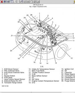

No check engine light on. Where should I start should I try to clean the iac valve? where is the egr valve located?

I would start there, and clean the throttle body if you havent already. I have a diagram, I am assuming this is the 2.0 if not then let me know. also the hose/accordian hose that is connected from the airbox to the throttle body look at it really well and see if there are any cracks or holes in it, this will cause you some problems.

https://images.2carpros.com/forum/automotive_pictures/88091_iac_626_20_1.jpg

I cleaned the iac valve and the egr valve. The egr valve was filthy! I put a new throttle body gasket on and started t up and went for a 20 minute drive. It idled great!plus the exhaust wasn't making a puffing sound anymore. when I was driving it was sputtering a little bit.Is this because the computer needs to reset the settings?

yes, I know your frustrated, but it will get fixed, its not as easy as some people think. check the mapp sensor, also see if the accordian has any cracks in it. and of course the catalytic, I dont remember if you said you had that looked at

Thanks for your help! I broke down and got it checked for a vacuum leak, and the intake manifold gasket and the injector orings needs replacing. He is charging me 300 for both things.A coouple of garage mechanics quoted me at 200 plus parts.Do you think this is a fair price?I guess its worth it to get it off my mind!Thanks again.
