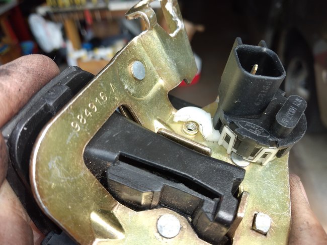

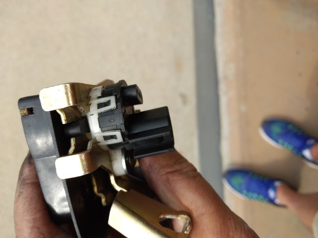

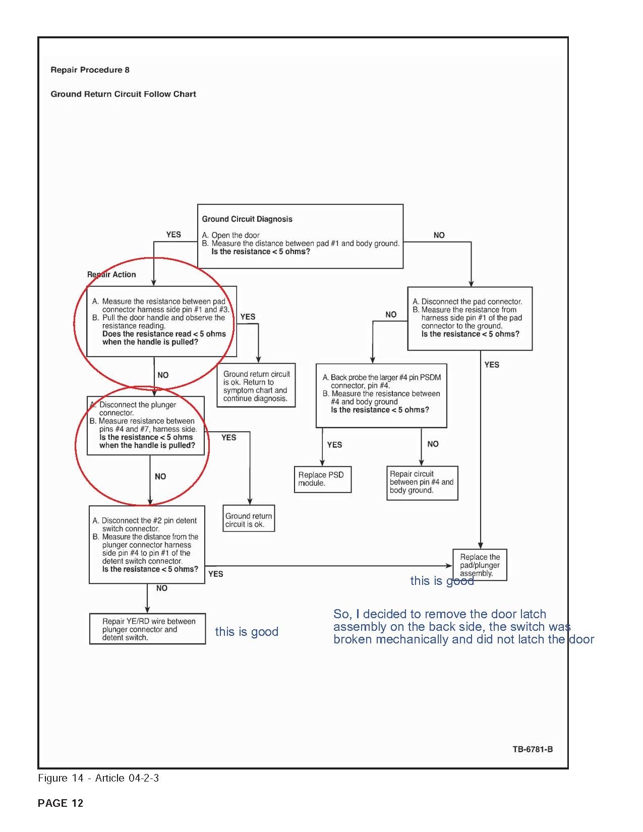

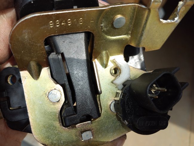

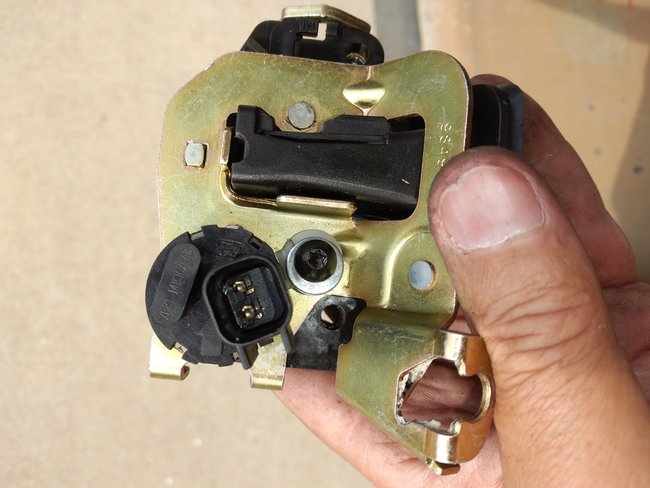

Bingo! Fixed it. I followed the diagram attached and I could not find anything so I disassembled the only thing I had not touched yet, the door back latch! Now I need help to find the parts. I attached the pictures can you help? I am looking but no luck! Thanks!

That is excellent work. I am sure this will help others. I know if helped me.
As for the parts, I am not finding any sources either. I think we are down to the dealer or a salvage yard.
Thanks for keeping us update to date on this. You should be proud of this because not only did the dealer find it but I was just about out of ideas as well.
