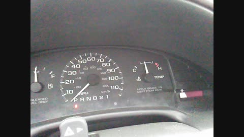

Two to three weeks ago I replaced my turn signal switch to fix my brake light problem. Now my passenger turn signal won't work when I use it the signal flashes fast. I have replaced the rear bulb and it does the same thing. Any ideas on how to fix my problem?

Hey TORY24,
Please put the hazard warning lights on and check all of your turn signals.
Is it just the passenger rear turn signal not working?
Have you got access to a multi meter or test light?
I would remove the bulb you have replaced and ensure it is the right bulb, the connections are clean and it is installed correctly. You can always check and match to the other side.
If that looks okay I would then unplug the main plug from that light unit and visually check the connections.
After this you will need a test light or multi-meter to do some electrical testing.
