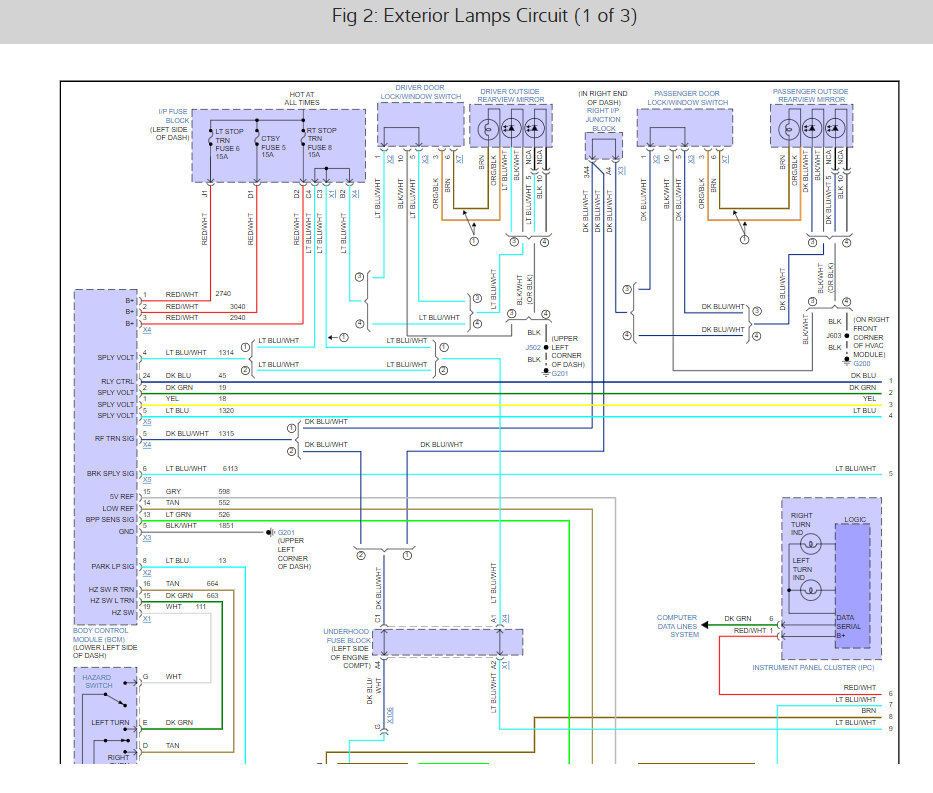

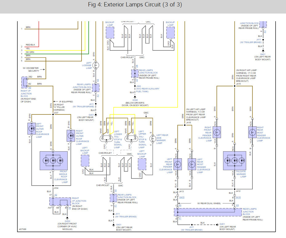

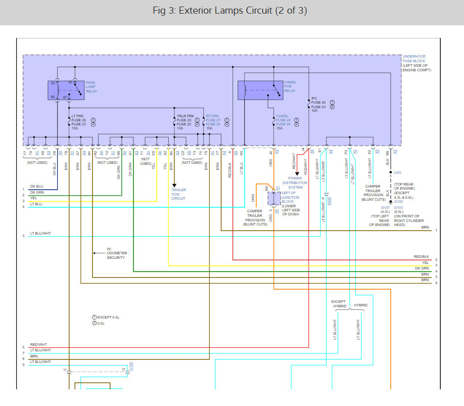

Right hand park lamp stays on even after pulling fuse and relay?
2013 CHEVROLET SILVERADO
70,000 MILES • 6.0L • V8 • 4WD • AUTOMATIC
AWBALLANTYNE
Jan 18, 2023 at 2:22 PM
  • 54,837 POSTS

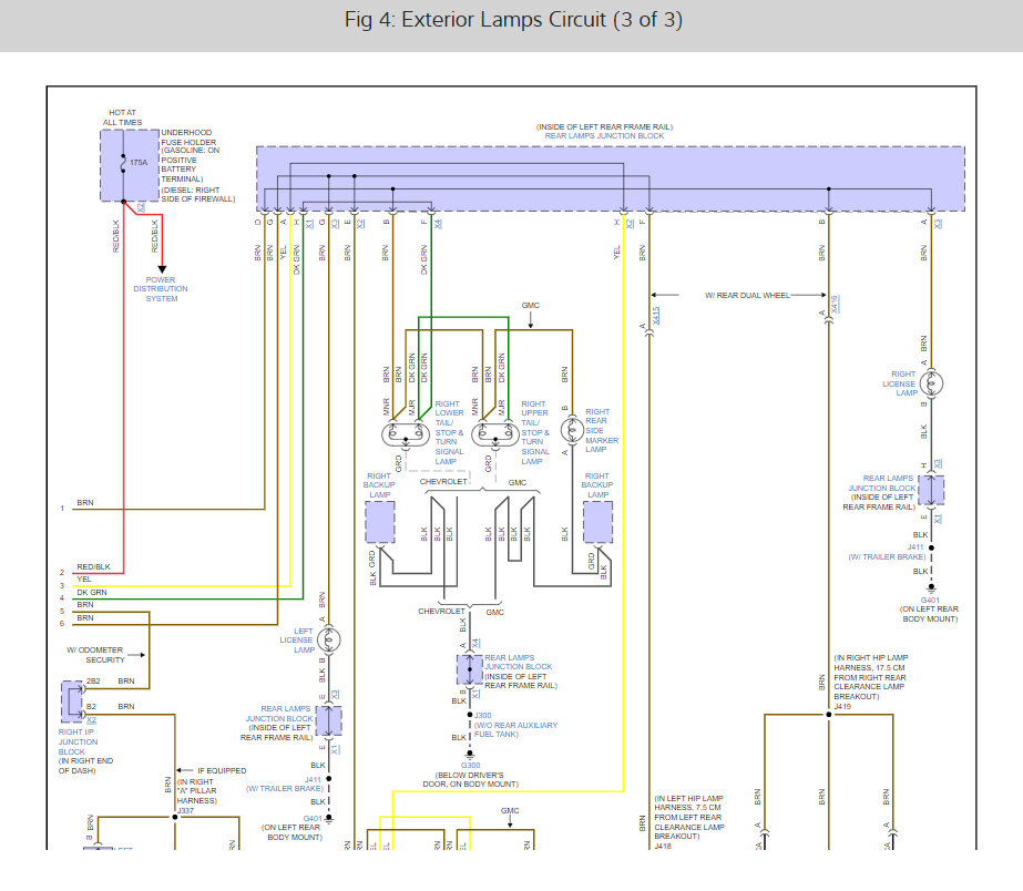

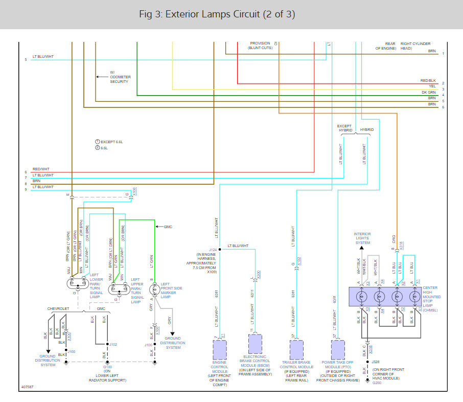

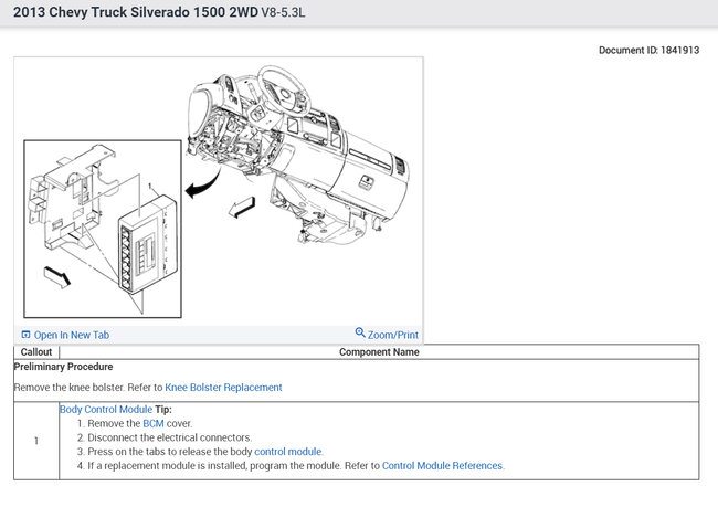

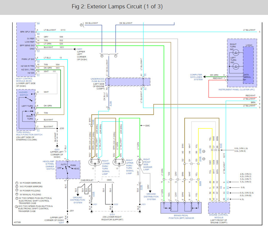

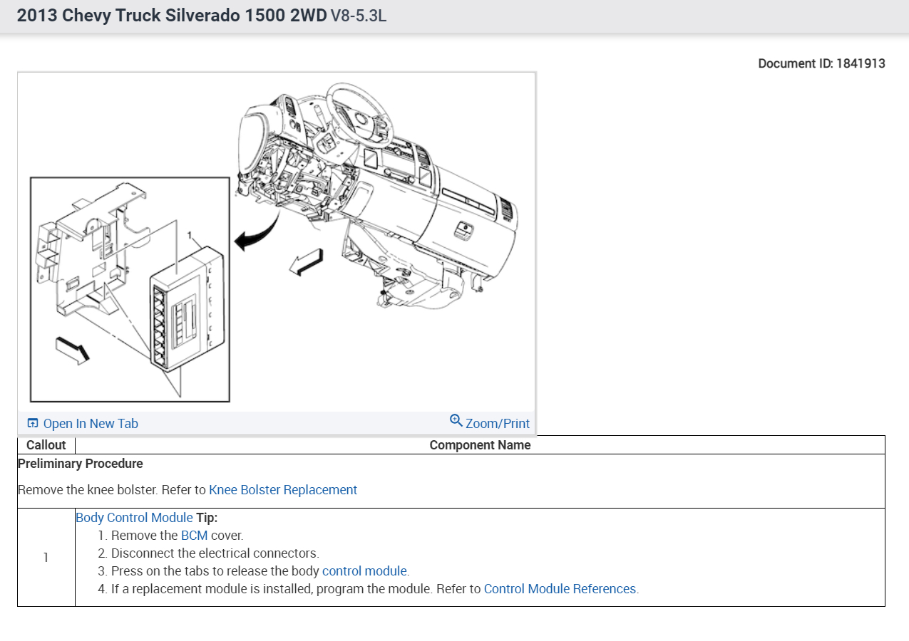

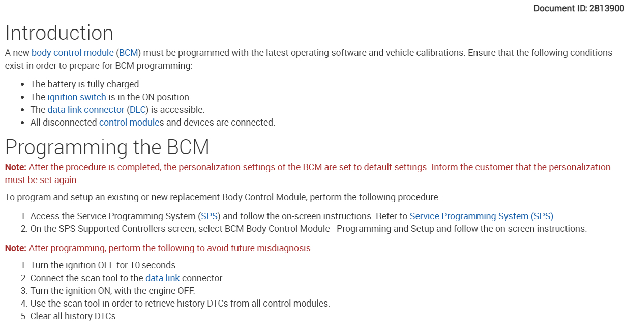

Yep, this is a common problem which happens when the BCM goes out. here is the parking light wiring diagrams so you can see how the system works and how to replace the BCM which you get a preprogrammed unit by searching Google or Ebay. Check out the images (bBelow). Let us know what happens and please upload pictures or videos of the problem.
