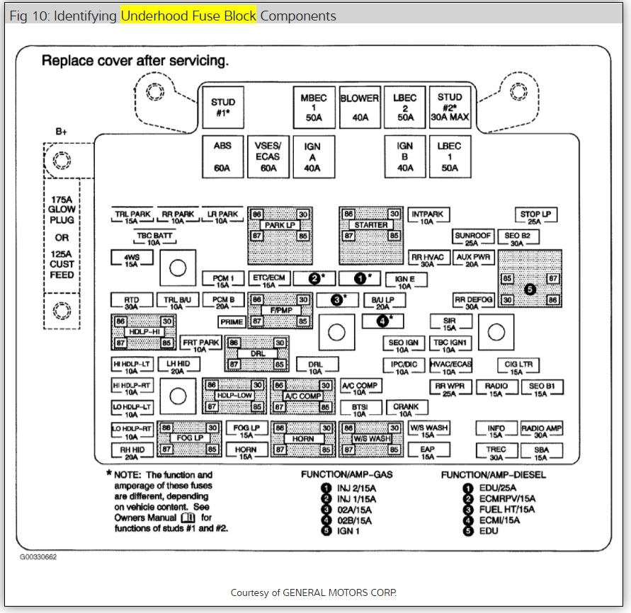

My park lights stay on after I shut off motor and park. It drained my battery and while recharging I heard a noise in the under hood fuse panel. I pulled out the fuse that was vibrating and the light went out but after placing the fuse back in the park lights refused to go out. So now I can not park the truck without pulling the fuse. Any idea what causing this? Thank you

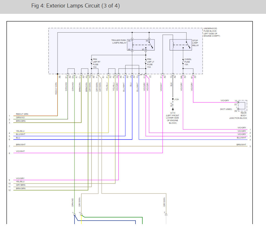

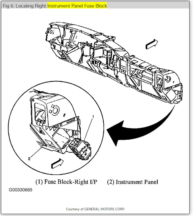

There is a parking light relay that is stuck on and needs to be replaced. Here is a guide to help you test and confirm the issue.
Here is the location of the relay (Below). Please let us know if you need anything else to get the problem fixed.

Perfect! Worked great I love this site all for free gives you hope for the world.

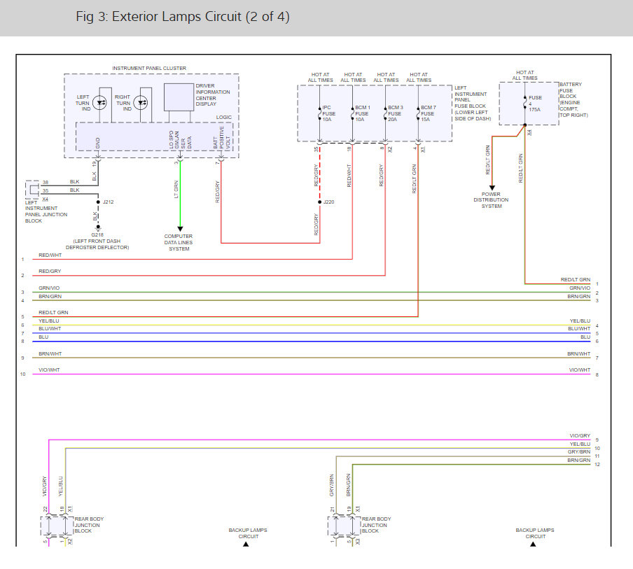

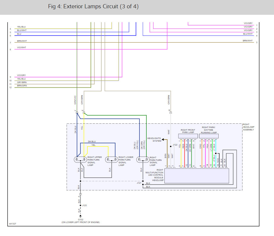

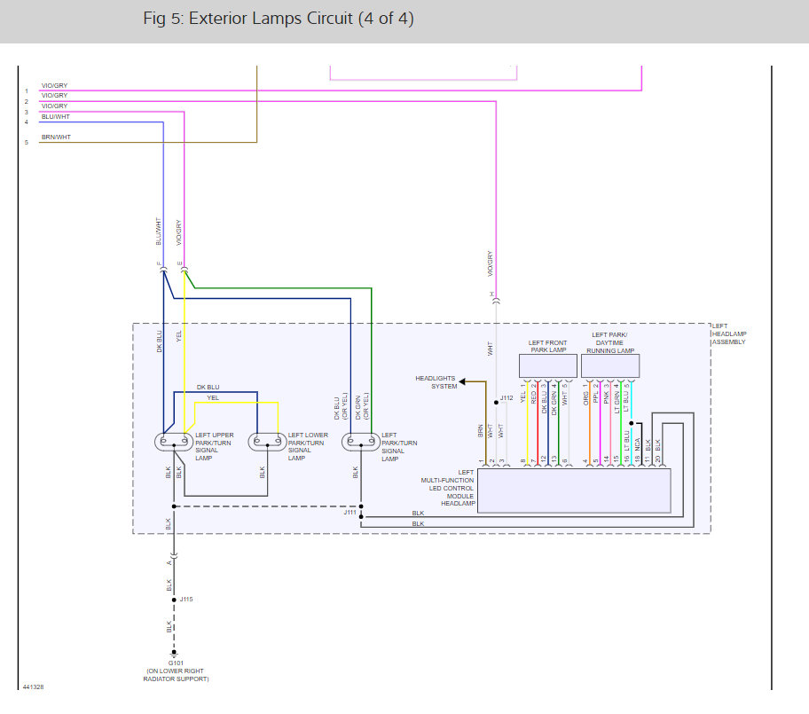

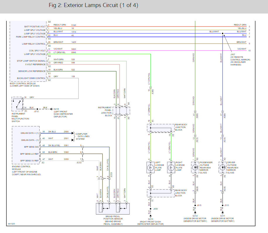

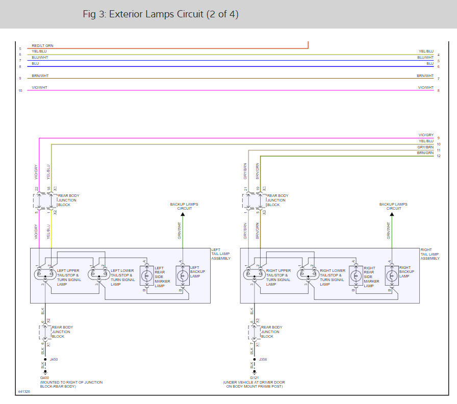

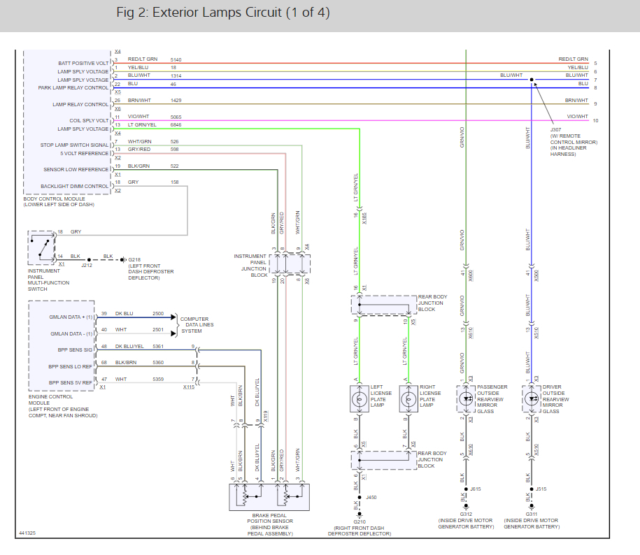

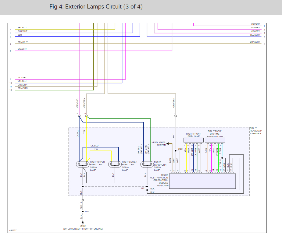

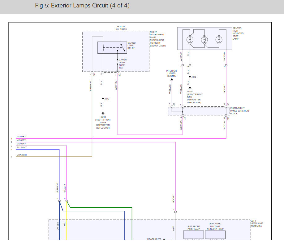

You need to replace the relay not the fuse. Here is the tail light wiring diagrams so you can see how the system works. Check out the diagrams (below). Please let us know what happens.

Thank you for the diagrams. I forgot to mention that not only are my running lights on but my head lights also stay on when the vehicle is shut off. I pinpointed through a Chevrolet website that it is the BCM; body control module. Or at least that is what I narrowed down. Thank you for your assistance.
