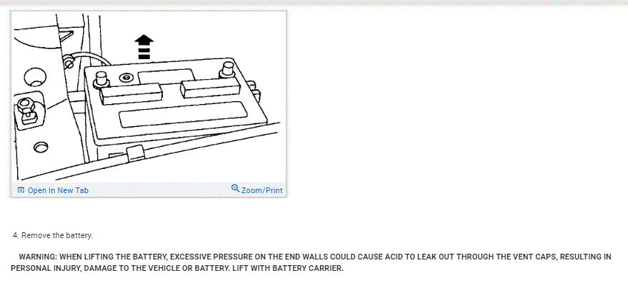

When I come to a stop and put it in park, the ignition restarts while turning the key backwards. I never experienced any car do this before, and the only thing that has changed were a couple mini fuses that I replaced. Is it my ignition switch or something electrical? Or maybe a false computer reading?
Jan 20, 2019 at 2:31 PM
HARRY P
  • 2,292 POSTS

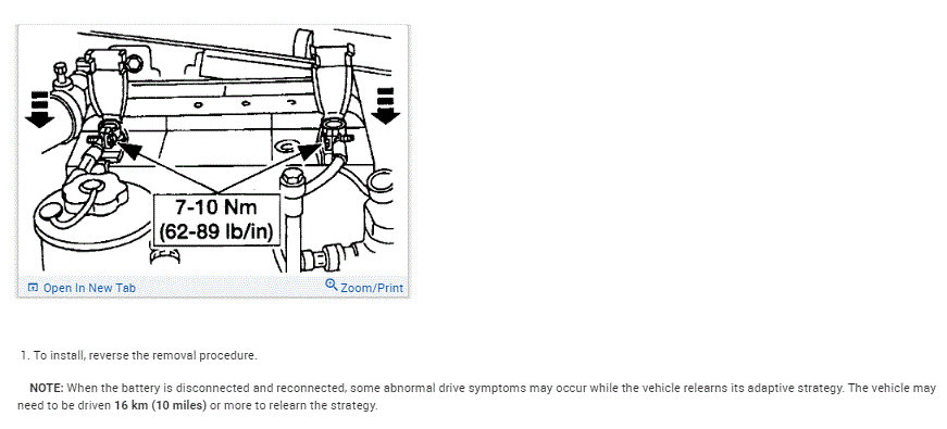

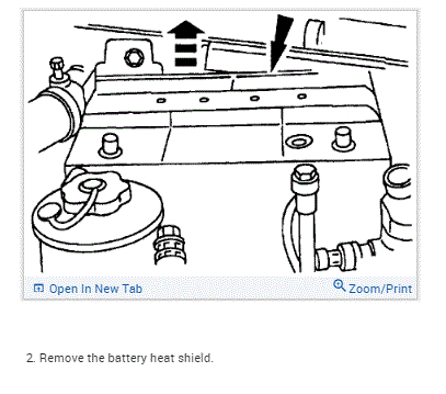

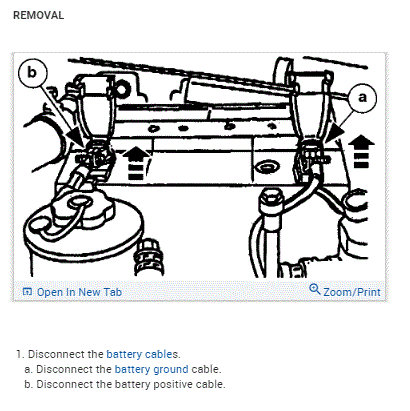

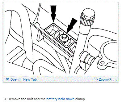

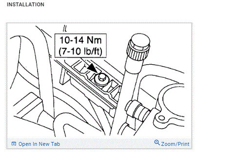

Hello again. To me that sounds like when you pulled and checked and changed fuses that the computer got kind of scrambled and is misreading it's signals, for lack of a better analogy. The first thing that I'd suggest doing is that you disconnect the battery for at least fifteen minutes, and then reconnect it and see what happens. I'll bet that this issue goes away completely. I'm posting what information I can find about disconnecting the battery in the images below.
While the battery is disconnected, it would be a good idea for you to recheck your work with the fuses, making sure that they're all snugly in place and that the correct amperage ratings are in the slots. A loose or blown fuse could be causing the computer to not receive as much power as is needed, which could be causing it to act oddly.
Hope that this information helps. Keep us posted on this and on your turn signal/hazard problem from your earlier post. Good luck!
