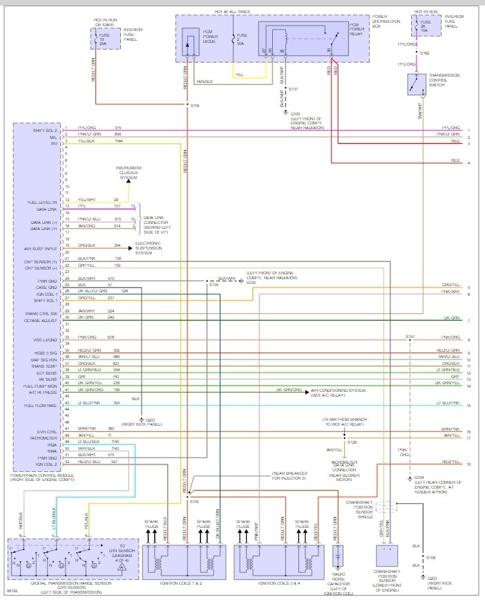

My truck cranks but wont start shaft and throttle sensors has spark.

Now my truck doesnt have spark but does crank

Hi, those engine's had a big problem with the crank angle sensor and the ignition module. If there is no injector pulse or spark this is where I would start. Here are some guide to help you.
and
just to confirm the module is bad.
here is a wiring diagram to help with the testing.
Best, Ken
