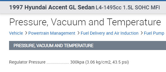

I'm not sure what you are asking. There isn't a separate fuel tank that is for reserve. If you are not getting fuel, have you checked fuel pressure to see if it is within the manufacturer's specifications?
If you haven't, here is a link that explains how in general to test fuel pressure:
I attached the pressure specifications below. Let me know if this helps or if you have other questions.

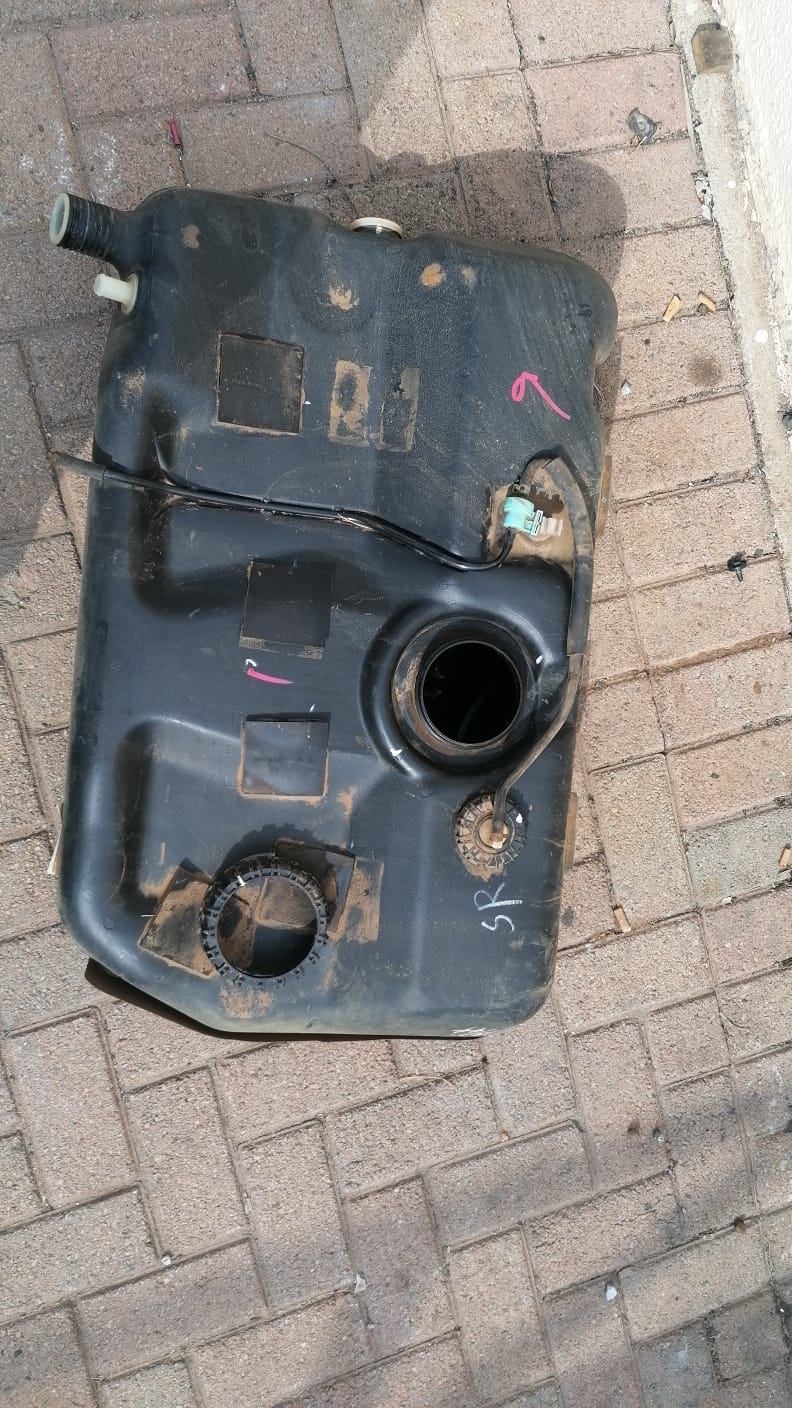

The car has on numerous occasions left me stranded with half a tank when reserve runs out of fuel. Have replaced the fuel pump and fuel filter. Still the gauge drops to empty and cuts the car out meanwhile there is half a tank of fuel. My son noticed a nozzle or pipe leading from the reserve to the main hold tank. I think this could be possible blocked. Right now, I keep on filling up 26 liters every time it's a 45 liter tank.

Yes, the car starts to stutter, letting you know it's about to run out of fuel. However. Then I go to the nearest filling station, I fill up or give them R300 and then it rises all the way up to half again. Something is off and I just can't put my finger on it. Next step is the sender unit. I have in the interim run a hose from the remaining tank into the reserve so that the fuel can be reached by the pump at all times.

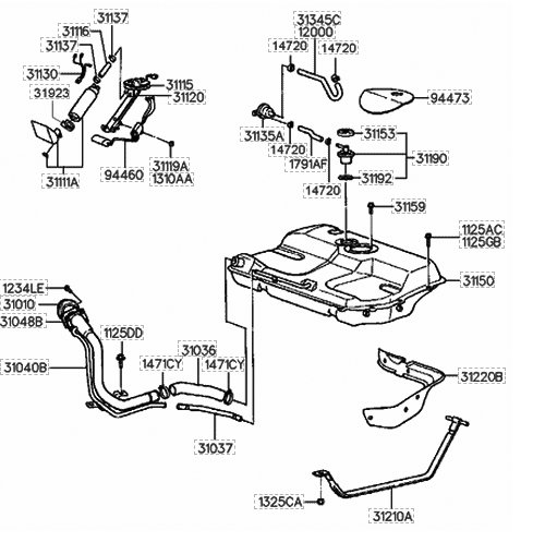

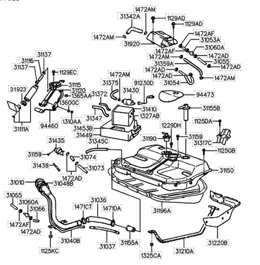

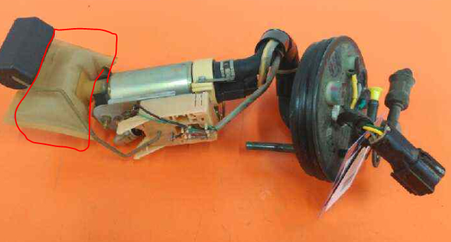

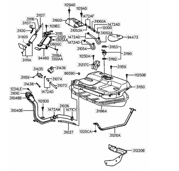

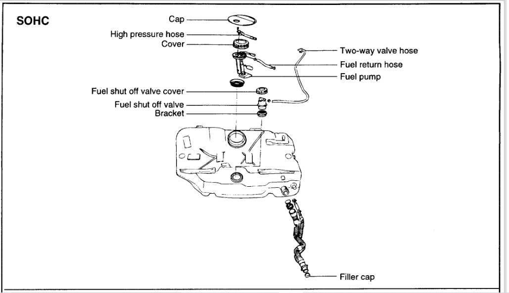

I attached a few pics below to help you understand how it works. However, pic 1 is for me. LOL Do you see what you are referring to as a fuel reserve compartment? There really isn' a tank for that. Let me know.
Okay, in pic 2, I circled the float. It is mounted on the fuel pump module. Basically, it is a rheostat or thermistor. As the fuel level drops in the tank, the float moves downward. When you add fuel, it moves up.

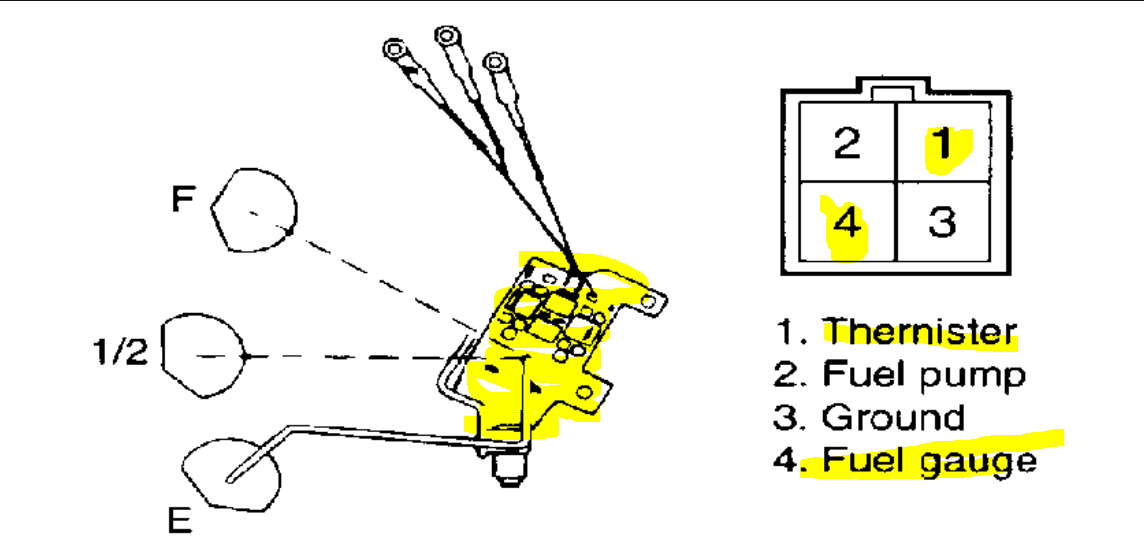

If you look at pic 3, that is the level float. Power is introduced to it via pin one in the connector. Power goes through the rheostat which functions as a resister. Based on the level of fuel on the tank, a certain amount of voltage is sent via pin 4 in the connector. That voltage is what determines the fuel gauge indication.
Let me know if this helps. Note, pic 2 is from is for a single overhead cam model. If you have a dual overhead cam engine, let me know and I'll get you the other pic.
See pics below

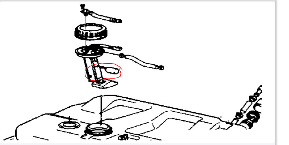

However, if the vehicle stalls out at half tank, the only thing I can think of is the filter at the bottom of the fuel pump is partially clogged and not allowing fuel to enter after a certain level. Nothing other makes sense.
I'm still confused about what the reserve tank is. I have gone through several exploded views of the tank and components, and nothing is listed.
If you take a look at the pics below, do you see the component you are referring to?

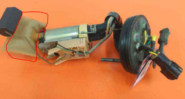

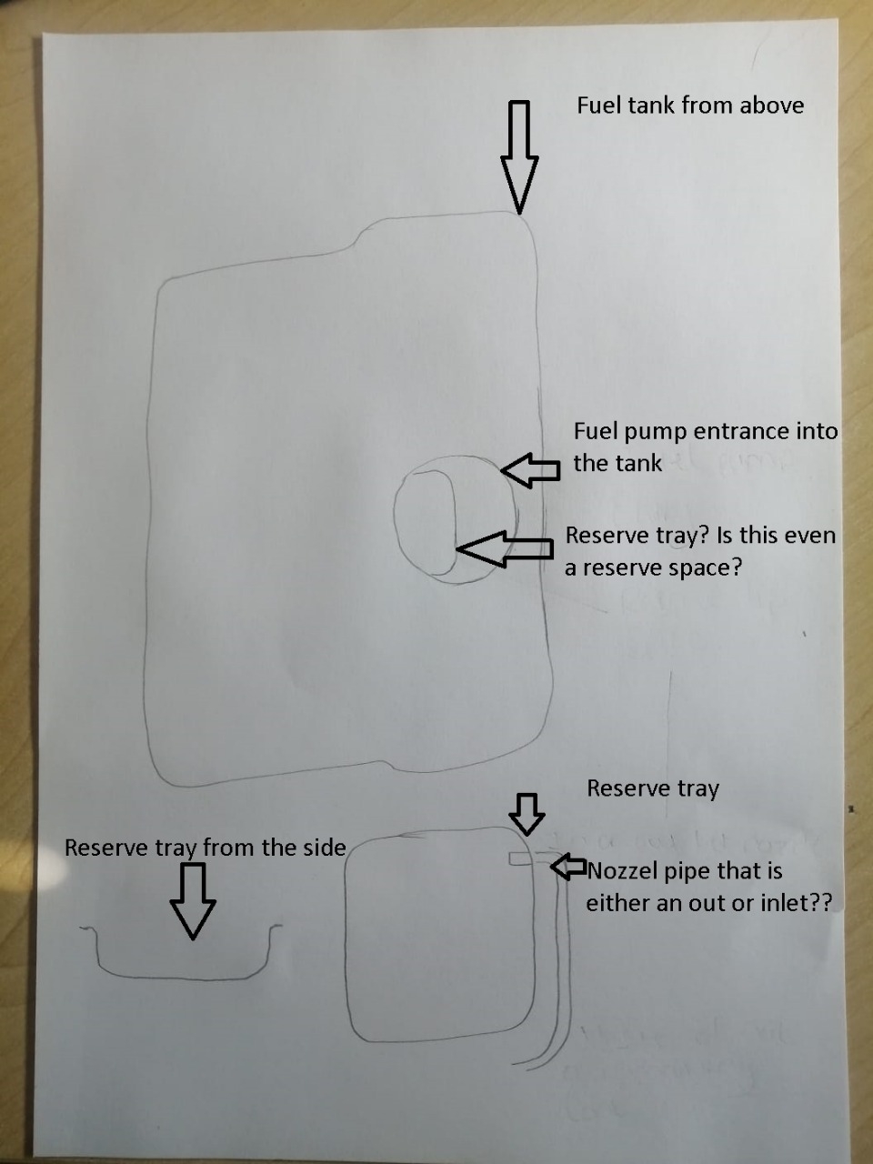

I hope this will help what I see and feel when I've got the lid off into the tank.

  • 110,240 POSTS
Do the actual fuel lines go to those things or could they actually be the charcoal canister?

I have no idea. My investigation is still around is that the reserve and how does the rest of the tank flow into the reserve once it starts heading down to low and nearly empty.
Jul 30, 2022 at 10:10 PM
  • 110,240 POSTS
If the "reserve tank" in the pic you made is mounted near the tank and not in it, that is most likely a charcoal canister that traps fuel vapors from escaping into the atmosphere.
Do me a favor. Carefully disconnect one of the hoses at the "reserve tank" and see if there is fuel in it. If there isn't, suspect the sock on the bottom of the pump is partially plugged.

Pic is from inside the tank as you drop the fuel pump assembly unit into the tank. There aren't any internal hoses. Maybe below the tank on the outside yes. But none inside the tank even remotely resembles a hose.
Next option could be that the floater isn't long enough to give a proper reading. Or that the tank at some point was changed to a 25-liter tank.
I'll take pictures tomorrow and send them to you. Also, will get proper test done on assembly unit specifically the sender unit.

Anything is possible as far as the tank. Maybe the pump isn't reaching the bottom of the tank.
I attached the pic you made below. What is this that I circled?
Let me know,
See pic below.

That is a metal pipe that is part of this "reserve" section that is made of metal. It is part if this section and is not an attached section to the tank. It also curves in a C around the "reserve tank" I had huge amounts of carbon smoke this morning that looked like condensation.
So, if the pipe to the carbon box is dirty or blocked will it have a huge effect on the regulation of the fuel inside the tank?
And if the carbon box is dirty, will it also affect a lot of the problems experienced?

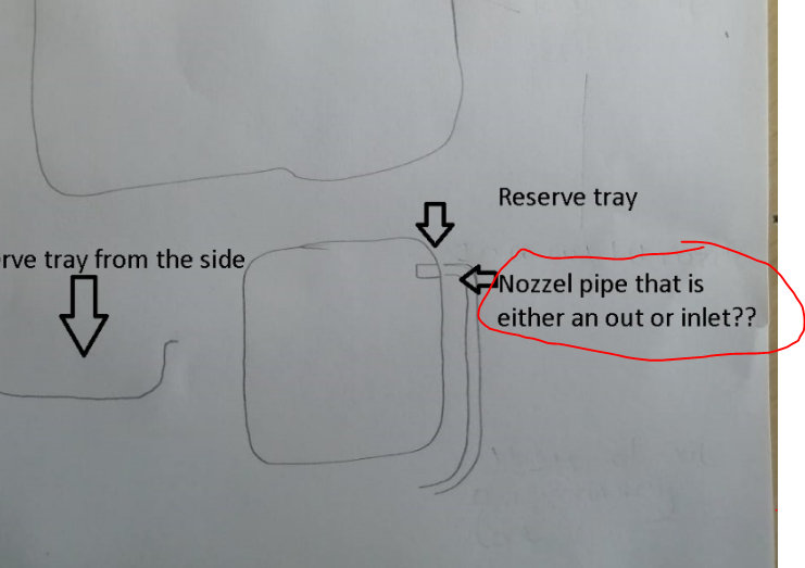

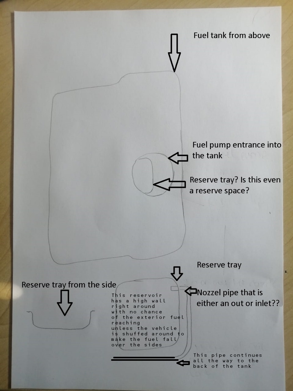

Tried to flush out the fuel line pipe that follows to the reserve thank - such a bad design. See diagram of how it works.
Fitted a secondhand sensor and floater unit and filter let's see how it goes. I'll have to on a monthly basis pull out the pump and see what the tank is doing.
Aug 8, 2022 at 2:14 AM
  • 110,240 POSTS
I have no idea the purpose of the "reserve". What is indicated is no fuel from the outside can enter it. Could it be some type of baffle that prevents the fuel from sloshing around?
Also, the tank in the pic appears to be plastic, or am I seeing it wrong?
Aug 8, 2022 at 2:22 PM
JERAQUE007
  • 15 POSTS
Morning Joe,

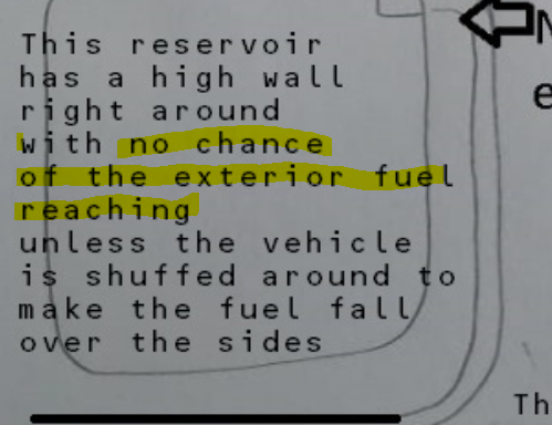

It's literally a bowl that the pump sits in and then sucks the fuel through that stupid pipe in the picture. So, if the fuel isn't shaken around in the car regardless, I will always run out of fuel because we weren't able to manage blowing it open. Or rather I didn't get the help I needed to get it done.

That is an interesting design. One that really makes no sense to me, but I'm not a design engineer. LOL What is interesting to me is they call it a reserve tank.
