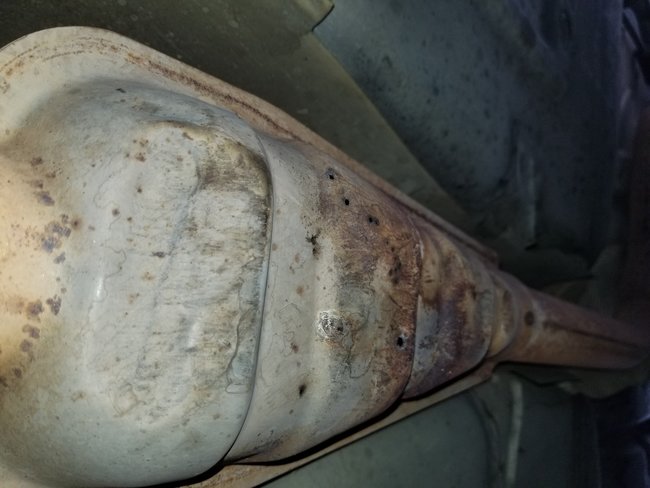

What's the job of the upstream sensor
Sunday, February 25th, 2018 AT 4:45 PM
MECHANIC
52,797 POSTS
Monitor the fuel mapping. The up and down voltages you see are rich/lean signals being sent to the pcm to adjust injector on times

I inspected the exhaust system and I found several holes throughout the pipes.
Tuesday, February 27th, 2018 AT 3:31 PM
MECHANIC
52,797 POSTS
OK, where were they located?
Tuesday, February 27th, 2018 AT 3:37 PM
ALEX19899
MEMBER
171 POSTS
After the downstream o2 sensor
SPONSORED LINKS
Tuesday, February 27th, 2018 AT 3:40 PM
MECHANIC
52,797 POSTS
Ok, thanks. That will not effect the O2 readings. It will only effect the reading if it is before the sensor.
Tuesday, February 27th, 2018 AT 3:47 PM
ALEX19899
MEMBER
171 POSTS
Here s a pic
Image (Click to make bigger)
Tuesday, February 27th, 2018 AT 4:19 PM
MECHANIC
52,797 POSTS
That is the muffler.
Tuesday, February 27th, 2018 AT 4:23 PM
ALEX19899
MEMBER
171 POSTS
Ohhhh what problems would I have if I continued to drive it like that?
Tuesday, February 27th, 2018 AT 4:34 PM
MECHANIC
52,797 POSTS
It will not effect the driving. It will just keep the light on until you have it repaired.
