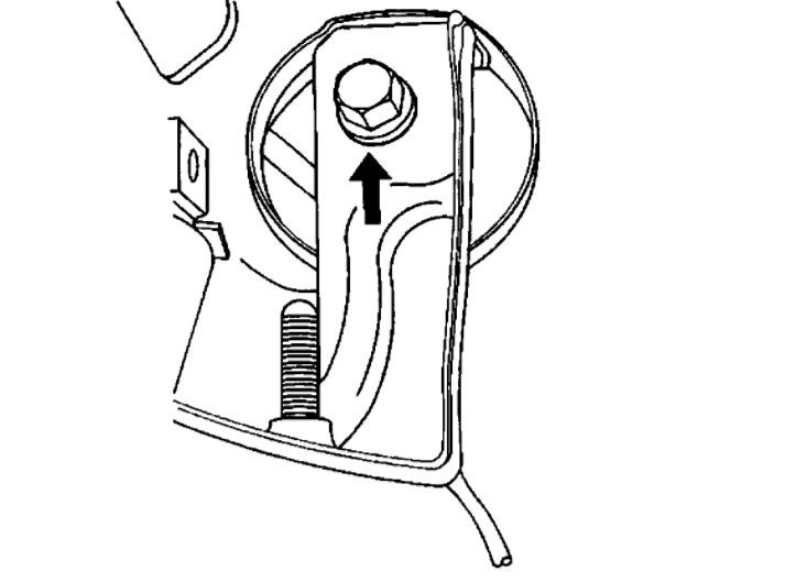

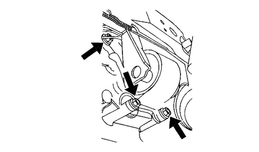

Does anyone have pictures of the transmission mounts location? I will be replacing them in a couple of weeks and want to see how hard it is to get them replaced.

Good morning.
The front one is easy. Just be sure you use a floor jack with a piece of wood to jack up the transmission.
The side one is little tight but once again make sure you have the transmission supported.
Feb 20, 2018 at 7:01 PM
ALEX19899
  • 171 POSTS

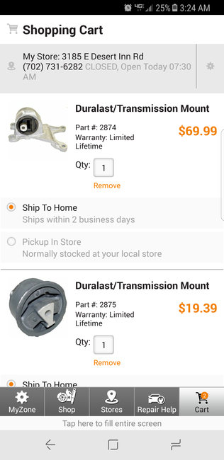

Thank you. from the pictures you showed me I will only need two transmission mounts?
Feb 20, 2018 at 7:15 PM
Correct, only shows front and side mount.
Feb 20, 2018 at 7:41 PM
ALEX19899
  • 171 POSTS
so I only need these two mounts?
Feb 20, 2018 at 7:58 PM
Correct.
Feb 20, 2018 at 7:59 PM

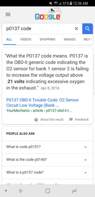

downstream o2 sensor is showing 0.2 voltage
Feb 25, 2018 at 8:36 AM
ok, the only job the downstream has is to monitor the cat converter. it has no effect on any other system.
it should read a relatively steady voltage as the front sensor will vary in voltage.
Feb 25, 2018 at 8:41 AM

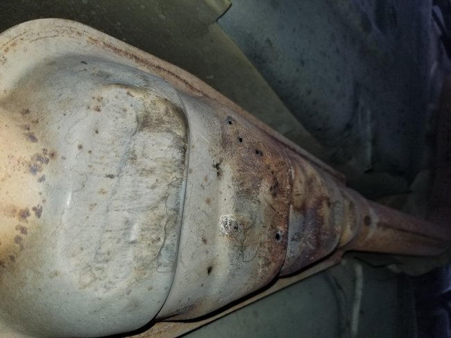

I inspected the exhaust system and I found several holes throughout the pipes.
Feb 27, 2018 at 7:31 AM
OK, where were they located??
Feb 27, 2018 at 7:37 AM
ALEX19899
  • 171 POSTS
after the downstream o2 sensor
Feb 27, 2018 at 7:40 AM
Ok, thanks. That will not effect the O2 readings. It will only effect the reading if it is before the sensor.
Feb 27, 2018 at 7:47 AM
ALEX19899
  • 171 POSTS
here s a pic
Feb 27, 2018 at 8:19 AM
That is the muffler.
Feb 27, 2018 at 8:23 AM
ALEX19899
  • 171 POSTS
ohhhh what problems would I have if I continued to drive it like that ?
Feb 27, 2018 at 8:34 AM
It will not effect the driving. It will just keep the light on until you have it repaired.
