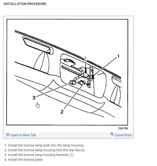

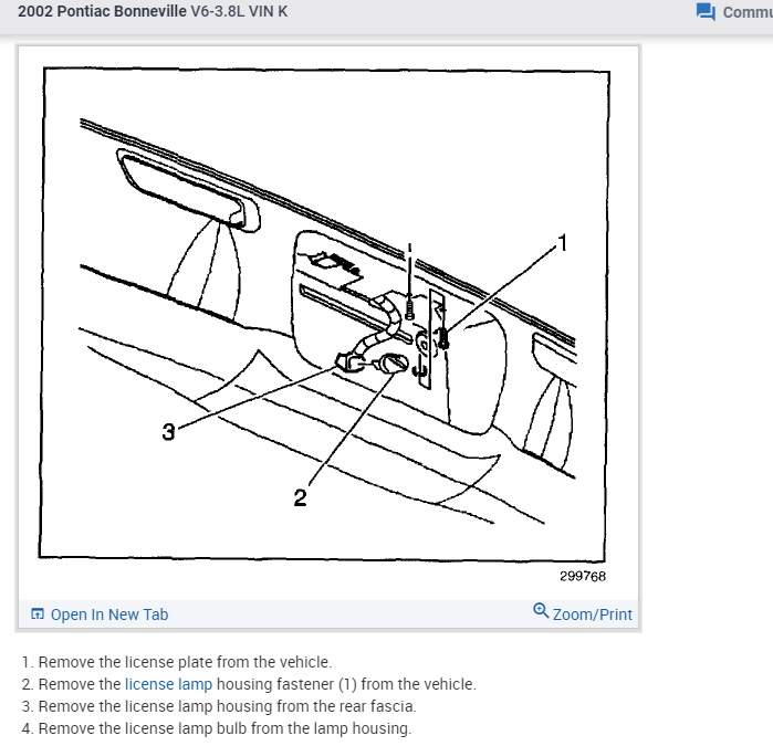

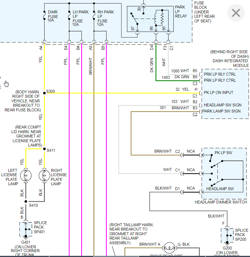

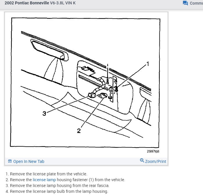

My license plate light is not working and i don't know how to replace it. It could be the fuse but i am not sure how to check it without the car manual.
Aug 21, 2019 at 9:06 PM
Here is the procedure for changing the bulb. Also, show the wiring diagram that has the fuse for these lamps.
If both bulbs are out then it is possible that the fuse or circuit is the issue. However, it may just be the bulbs. I would remove them and test for power and then replace the bulbs if there is power. If not, then start with the fuse. If the fuse is okay, and you don't have power then there is a wiring issue.
Let me know what you find and we can go from there. Thanks
