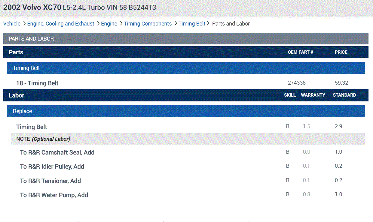

Got an estimate to fix leaking camshaft seal and front engine seal for oil leak. The estimate includes a timing belt and water pump. Does this job require a new timing belt and waterpump?

To replace the cam seals, you need to remove the timing belt. I suspect they are recommending it to eliminate labor if the belt or pump need replaced in the near future.
To answer your question, no. The pump and belt does is not required. However, it is recommended to save labor costs in the future. I noted the mileage. If the belt has over 100,000 on it, this is the time to replace it. Once everything is apart, the water pump is right there to replace as well since it is driven by the timing belt.

Thanks for the help. I had a quote for the whole thing for $1,100.00. The body is in great shape but we've put a fair amount of money into it over the past year. My wife drives it mostly and it is a super comfortable car. The previous owner was my mother-in-law who was meticulous in her care for the car. Trying to figure out whether to spend the money to get fixed or invest in something newer.

Does the $1,100.00 include everything? I attached a pic below that shows parts and labor for the belt. Then it indicates labor additional labor for additional components including the seal and water pump. This doesn't include the parts as far as the seal and pump, but it will give you an idea if the price quoted is in line.
