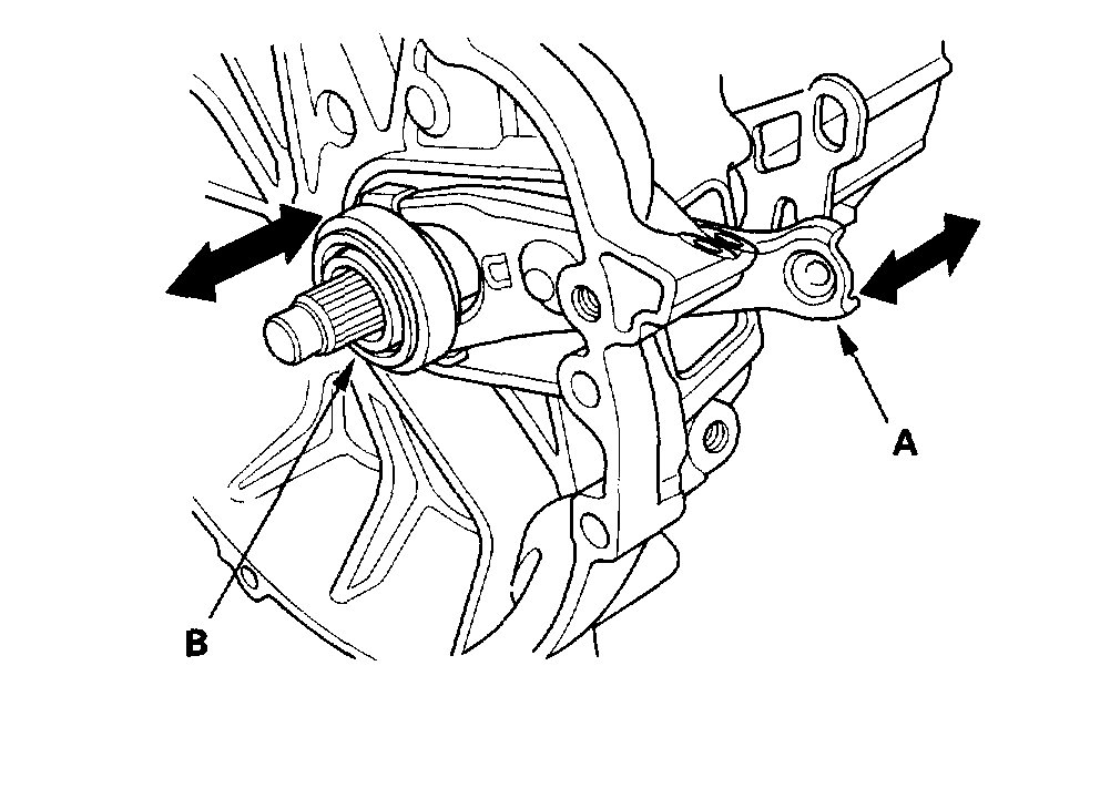

Took the clutch off and it was shredded. Just replaced the clutch with Exedy Stage 1/lightweight flywheel and car is still not moving. It will go into gear, but will not move. What would be the next piece to look at? Leaning towards something inside the transmission, but not sure what we are looking for. Not the hydraulics system (cmc/sc). Car doesn’t grind when going into gear, no noises. Starts up fine.

If it is going into gear, I doubt there is anything internal wrong with the transmission unless there was an issue before. Are you sure the release bearing was properly installed? If the release bearing isn't properly seated, it can cause issues.

It was the drive axle not being in all the way. thanks for the input. :)
