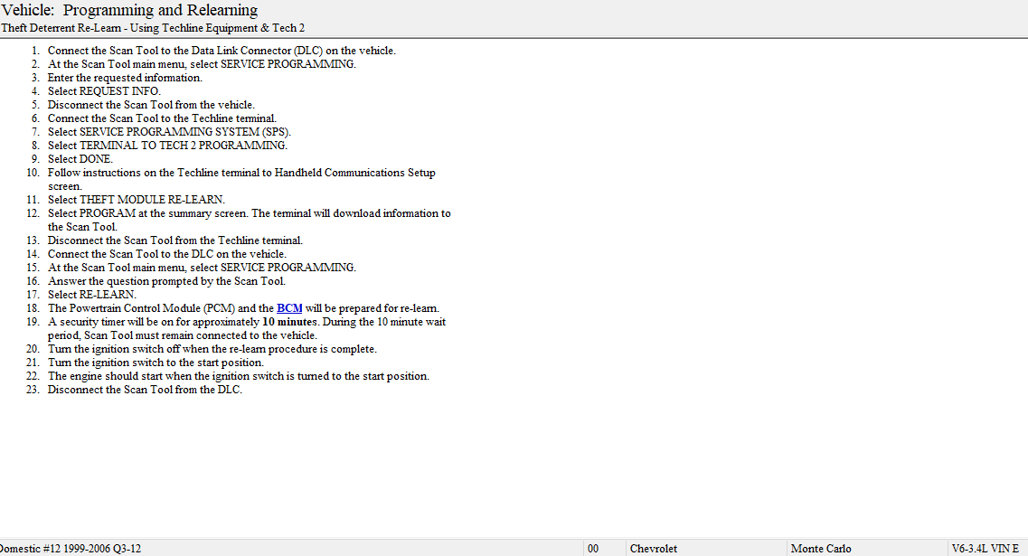

I replaced my ignition, my car was stolen and the person took my key with him when he abandoned my car. i replaced the ignition and when i turn the key it does not start and the dash lights come on, but that's all it will do. If i jump the starter it will start but shuts off in lets say 5 seconds.

it seems your key must be reprogrammed to synchronize with the engine control unit, perform the procedure as described below.
without using scan tool this procedure takes approximately 30 minutes. make sure the battery is fully charged before proceeding.

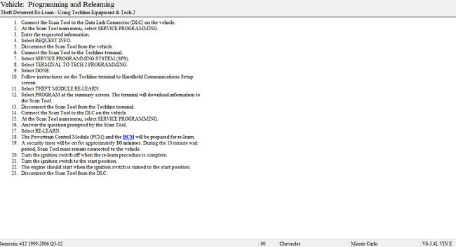

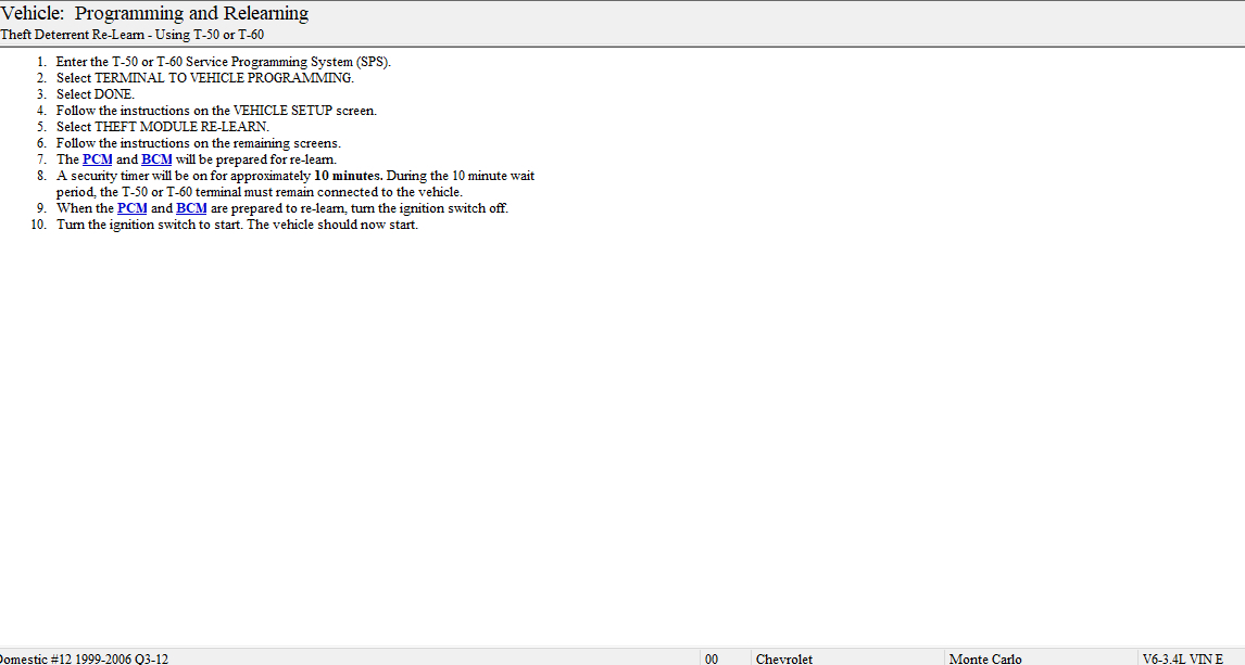

figure 1 and 2 below are the programming procedure by using scan tool.
