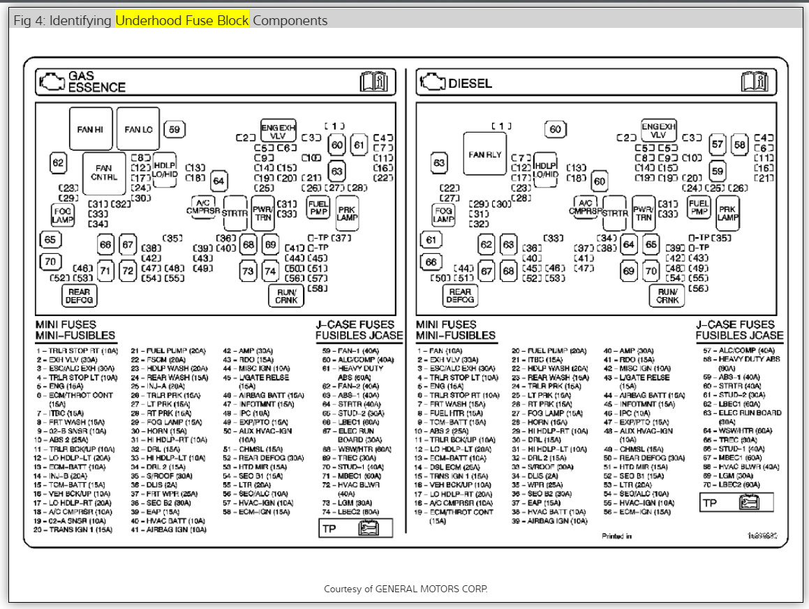

There are two amplifier fuses (40 and 42) that need to be checked. here is a guide to help with the fuse locations below:
Check out the diagrams (below). Please run this test and get back to us.
