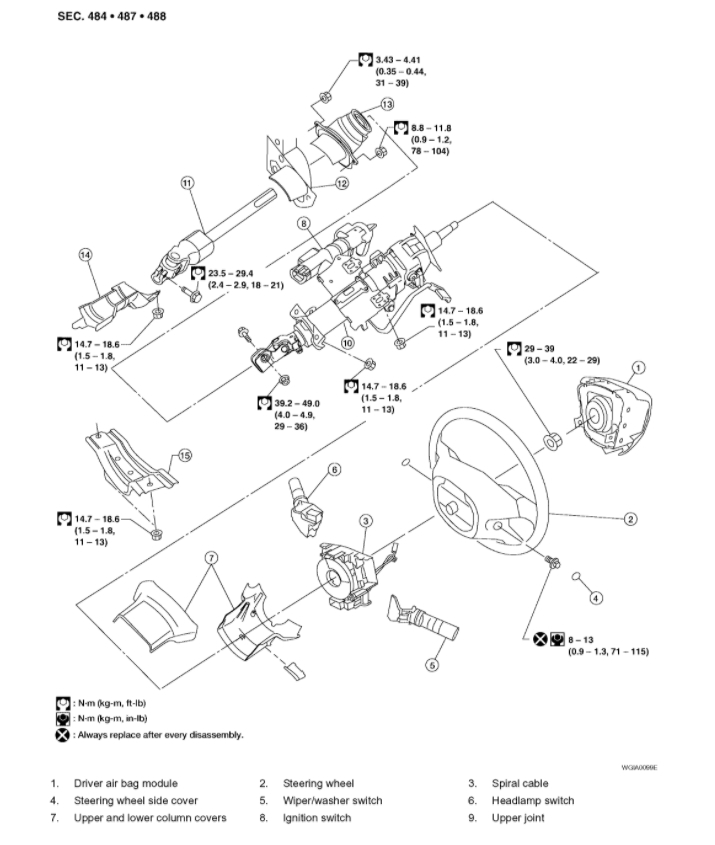

Ignition switch replacement instructions needed
2005 NISSAN ALTIMA
170,000 MILES
SHAWN THIBODEAUX
How to replace ignition switch on the car listed above?

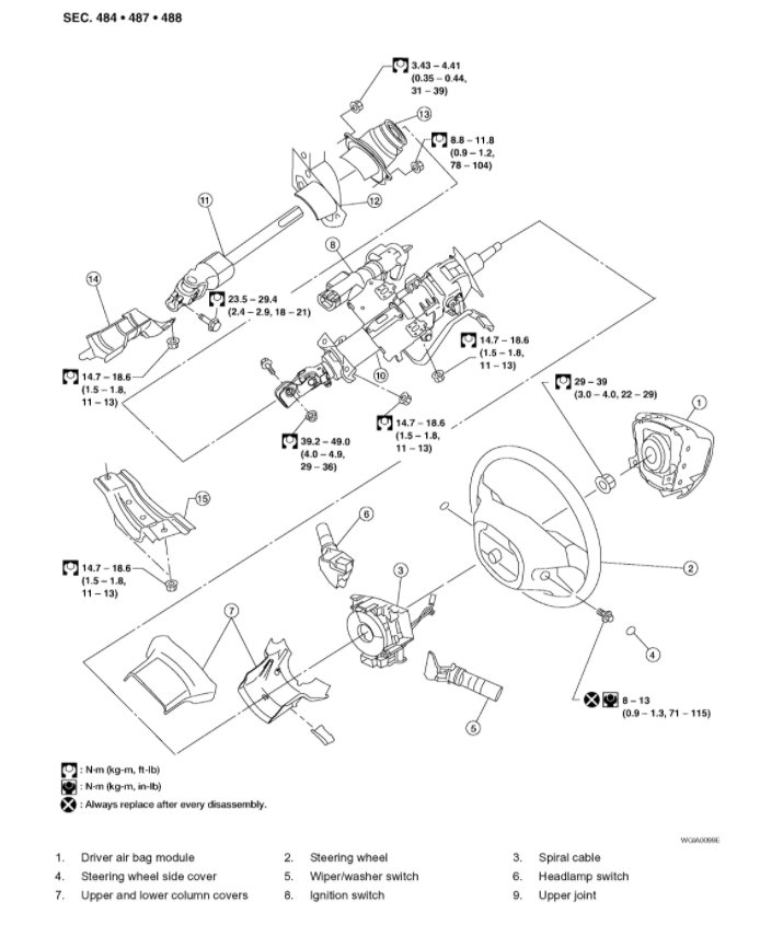

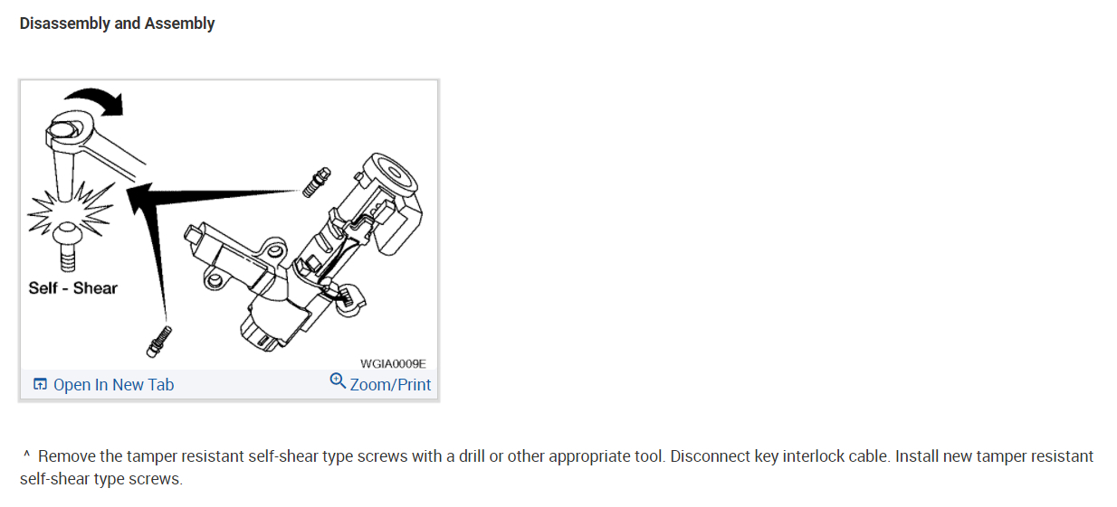

Here are the instructions how to replace the ignition switch and lock tumbler with key. you will need a sharp chisel to help "walk" the old bolts around to loosen them because they use two anti theft bolts at the top of the switch/lock which can be a little tough so position the chisel to one side and tap to remove the bolts. Check out the diagrams (below). Please let us know what happens.
