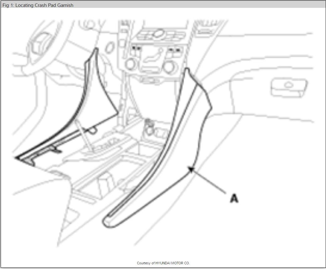

How do I remove the panel to remove the heater/AC module. What tools are required for this job?

Here are the removal and installation procedures:
Remove the crash pad garnish (A).
Fig 1: Locating Crash Pad Garnish

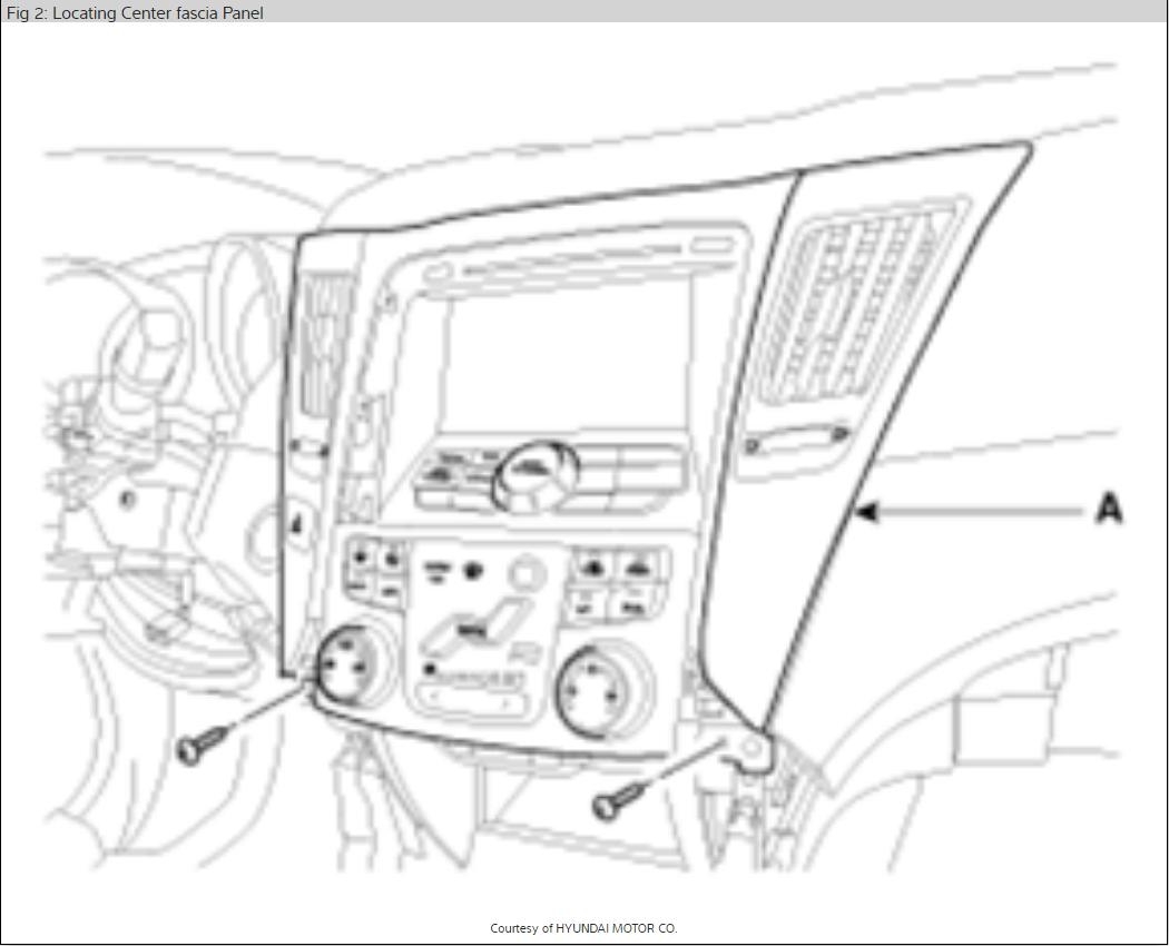

Using the screwdriver, remove the center fascia panel (A).
Fig 2: Locating Center fascia Panel.

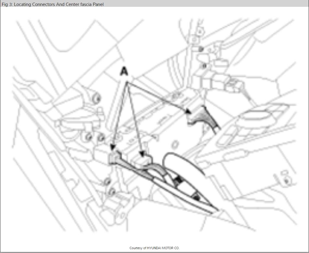

Disconnect the connectors (A) and then remove the center fascia panel from the crash pad.
Fig 3: Locating Connectors And Center fascia Panel.

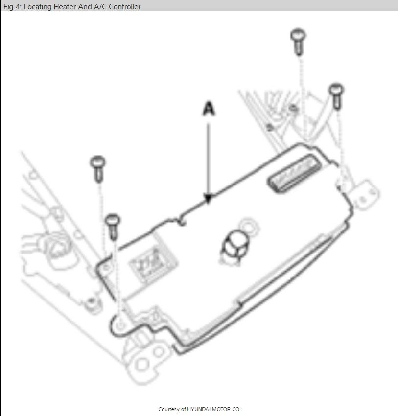

Remove the heater and A/C controller (A) from the center fascia.
Fig 4: Locating Heater And A/C Controller.
Installation is the reverse order of removal.
