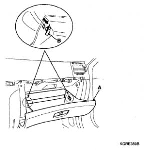

How do I change the cabin filter on a 2008 Hyundai sonata? Is it in the engine compartment or behind the glove box?

is behind glove compartment area. remove the damper from the glove box after removing side cover. open glove box and lower the bow down completely by removing the box stoppers. remove the filter cover with pushing the knob then replace the filter, make sure direction of filter is correct.
