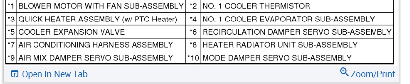

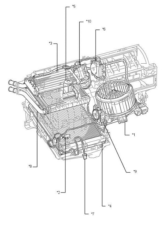

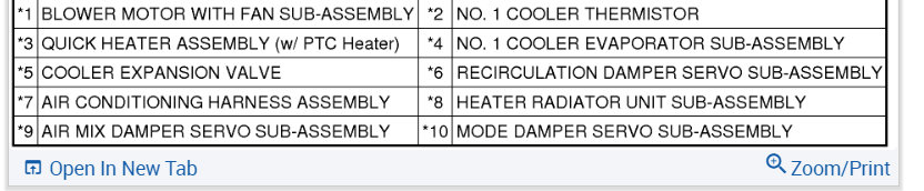

  • 55,402 POSTS
Here are diagrams to show the location of the blend door actuators. Check out the diagrams (Below). Please let us know what happens.
