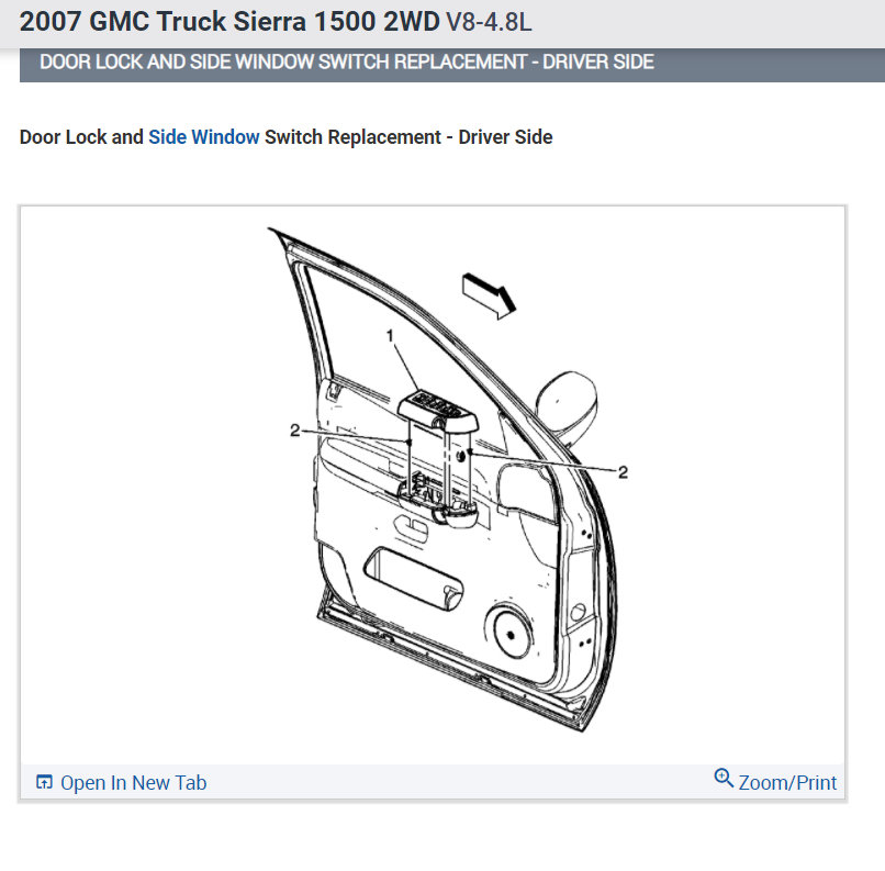

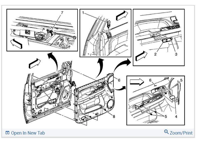

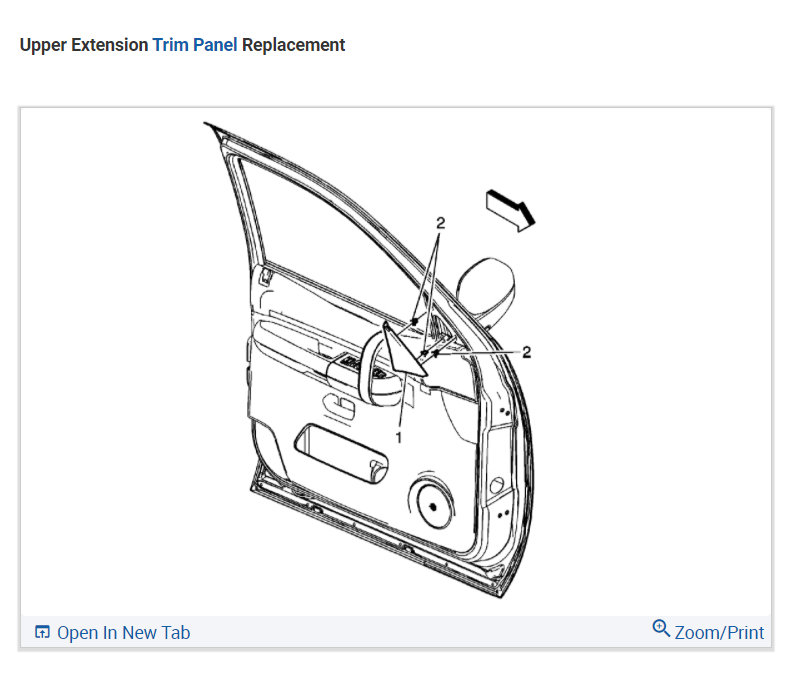

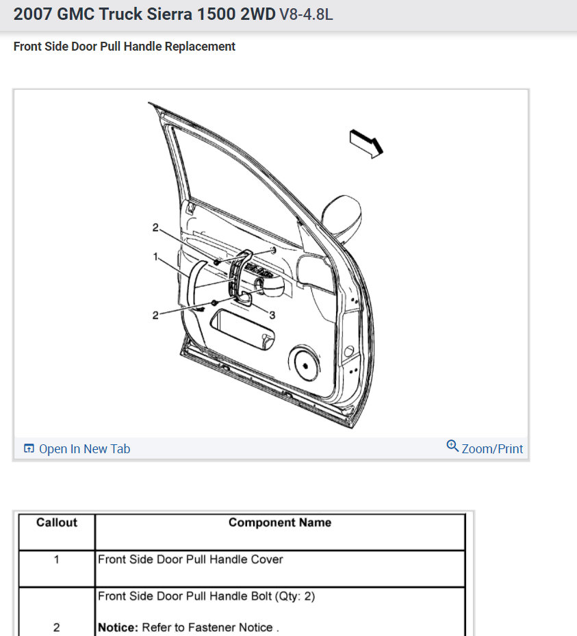

I cannot find anywhere that shows me how to remove the wood grain trim without taking the whole inside trim panel off. I know most you can pop out. Can you steer me in the right direction? thanks
(1500 SLT)
Apr 17, 2018 at 6:13 PM
WRENCHTECH
  • 20,761 POSTS
It snaps down with a clip in front and back, but the instructions say to remove the door pull handle first. Here are the instructions on how to remove the switch in the diagrams below. Check out the diagrams (Below). Please let us know what happens.
