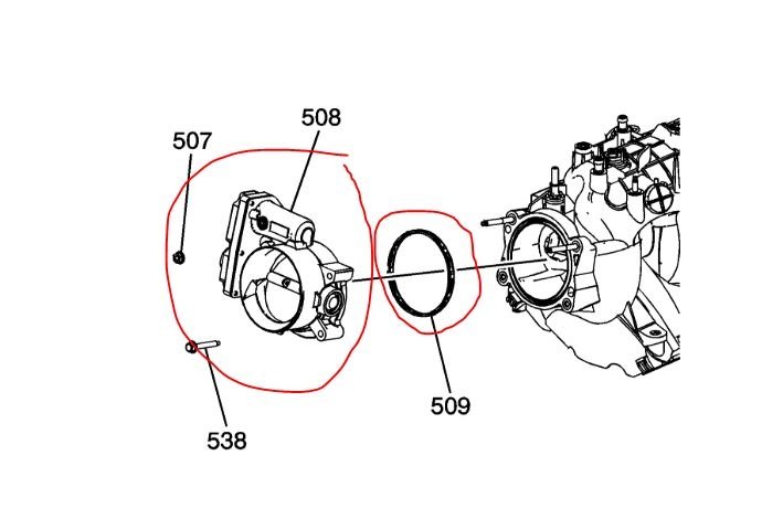

As long as I keep rpm's at 800 or so and above I have no problem. If I come to a stop and don’t keep the rpm's up I may get a reduced engine power message. I turn it off then back on and I may or may not have a check engine light. AutoZone scanned it and came up with these codes. P0172, P0175, p0220, p1516, and p2135. I’m at 110,000 miles and I’m guessing original spark plugs and who knows what else original. I was thinking a tune up would be the ticket( plugs, filters, oil) till they scanned it. It idles around 600 rpm when it wants to run. I suppose it’s low enough that a loose connection might show up cause of vibration. Any help is appreciated!
Sep 15, 2019 at 2:54 PM
  • 110,194 POSTS
Welcome to 2CarPros.
I would try to clean the throttle bore it helps fix these problems, then clear codes
Lets look at what each code is indicating and then see if there is a common denominator between all.
DTC P0171
- Fuel Trim System Lean Bank 1
DTC P0175
- Fuel Trim System Rich Bank 2
DTC P0220 The TP sensor 2 voltage is less than 0.25 volt or more than 4.59 volts for more than 1 second.
DTC P1516 - Throttle Actuator Control (TAC) Module Throttle Actuator Position Performance
DTC P2135 - Throttle Position (TP) Sensor 1-2 Correlation
As you can see, they are all fuel related. There is a good chance the throttle body itself needs replaced. However, before jumping to that conclusion, I need you to check for a couple things. Since one bank is lean and the other is rich, check to see if there are any exhaust leaks before the catalytic converters. It doesn't have to be loud. It can sound like a ticking, especially when cold.
Next, follow this link and check for other vacuum leaks.
https://.2carpros.com/articles/how-to-use-an-engine-vacuum-gauge
Next, if I had to guess, I would say there is a short to power between throttle position sensor one and two. I need you to check the wiring at the throttle body. Make sure it is not damaged, the connections are clean, tight, and internally not damaged, and make sure there are no cuts in the wiring insulation.
If I recall, this throttle body isn't serviceable. If you are comfortable with testing the electrical end of the system, let me know. I have flow charts (which are quite extensive) I will send. I am not going to overwhelm you with them if you don't want them
I attached a picture of the throttle body. That is where i need the wiring checked. Also, I circled an o-ring that can cause a leak, so make sure to check around there for issues.
Let me know what you find.

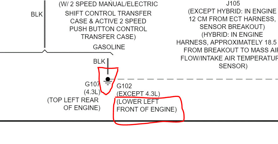

Okay I have reduced engine power. if I clear the code and turn my headlights to manual mode it will run fine. if I use the A/C or use high beam flash to pass or turn on headlights manually it fails into rep. if I pull either of my headlamps from the holders it stalls.
Sep 10, 2020 at 12:59 PM (Merged)
SATURNTECH9
  • 30,869 POSTS
Sounds like you have a bad ground to the headlights there is a ground splice pack usually up by the headlights.

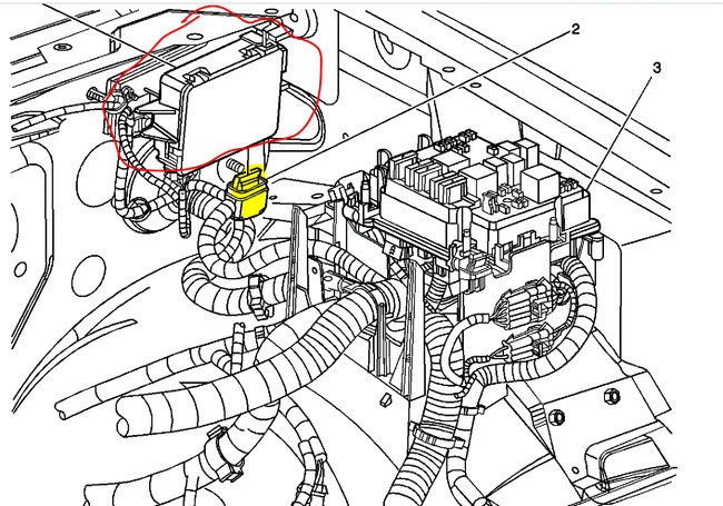

ROBERTBARNES62
  • 83 POSTS
just pulled the codes and got the following:
P0120
P0220
P1515
P1516
P1518
P2135
I did clear the codes and they came back as soon as I cleared them.
As I state above I did put a new throttle body on the truck but that did not help any..
  • 110,194 POSTS

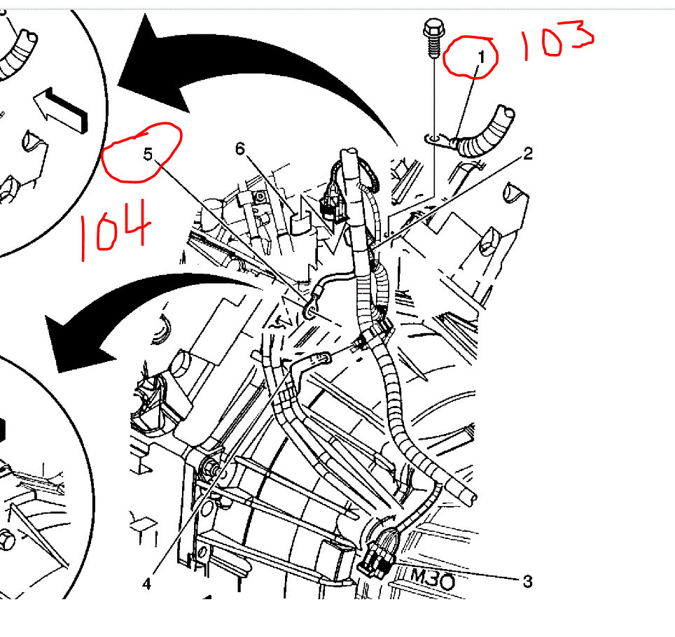

Those codes all are associated with the throttle actuator control module (TAC). Now, there are a list of checks for these codes, but to start, I suggest simply checking the wiring to the TAC module. It is under the hood. I attached a pic of it. I highlighted the connector and circled the module. I want you to unplug it to confirm there is no damage to the connector and no corrosion causing a bad connection.
Before you unplug the module or plug it back in, make sure the battery is disconnected.
Do this and let me know what you find. Also, let me know if you are comfortable following diagnostic flow charts.
ROBERTBARNES62
  • 83 POSTS
I have unplugged and inspected the wires and nothing seems to be broke or damaged. Please provide what I should do next. As far as flow charts never followed one but would open to try if it will allow me to get it fixed faster. Lol
ROBERTBARNES62
  • 83 POSTS
Got up this morning and started to check grounds and all connections to tax module, pedal and throttle body. Still getting the reduced engine power message. When I cleared the codes and re-scanned it now only brings up p0120 and p2135 codes.

The throttle body is grounded through the ECM. After tracing through about 10 pages of schematics (LOL), the primary ground for the ECM is at the right front of the engine. See attached picture.

ROBERTBARNES62
  • 83 POSTS
I read that there is a GM service bulletin saying to check g103 and g104 when having TPS problems. can you tell me where those grounds are please?
  • 110,194 POSTS
Both are behind the engine. I attached a pic so you can locate them. I indicated which is 103 and 104.
Let me know if this helps.
ROBERTBARNES62
  • 83 POSTS
What uses these grounds?
