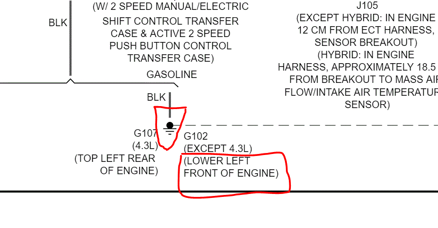

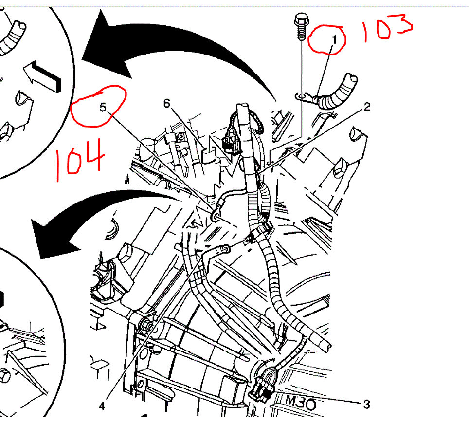

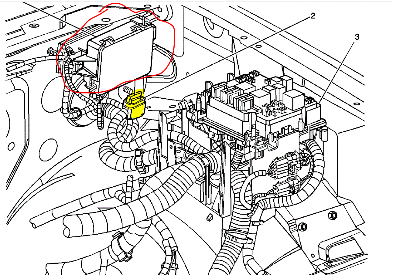

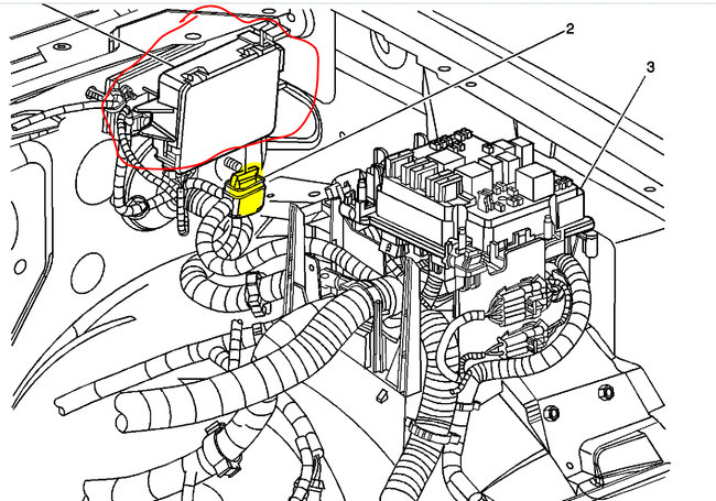

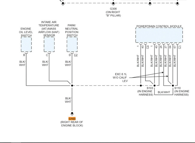

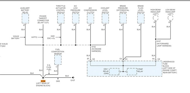

I attached two pics below from the grounding schematic. Let me know if it helps.

Yes, check engine light is on, and I believe the code it throws is P1516.

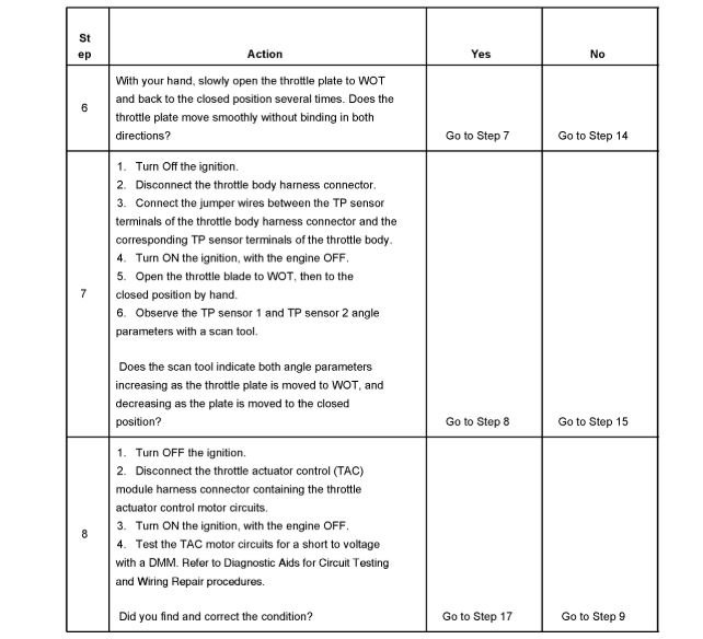

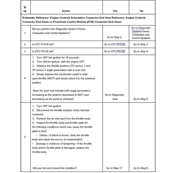

1516
CIRCUIT DESCRIPTION
The predicted throttle position (TP), based on accelerator pedal position (APP) and other limiting factors, is compared to the actual throttle position. The two values should be within a calibrated range of each other. Both the powertrain control module (PCM) and the throttle actuator control (TAC) module redundantly monitor the predicted and actual throttle position. This DTC sets if the PCM detects an out of range condition between the predicted and actual throttle position.
CONDITIONS FOR RUNNING THE DTC
- DTC P1518 is not set.
- The ignition switch is in the crank or run position.
- The ignition voltage is more than 5.23 volts.
- The TAC system is not in the battery saver mode.
CONDITIONS FOR SETTING THE DTC
- The TAC module detects that the predicted and the actual throttle positions are not within a calibrated range of each other.
- The PCM and the TAC cannot determine the throttle position.
- Both of the TP sensors are invalid.
- All of the above conditions are met for more than 1 second.

TEST DESCRIPTION
Steps 1-5
imageZoom/Print
Steps 6-8
imageZoom/Print

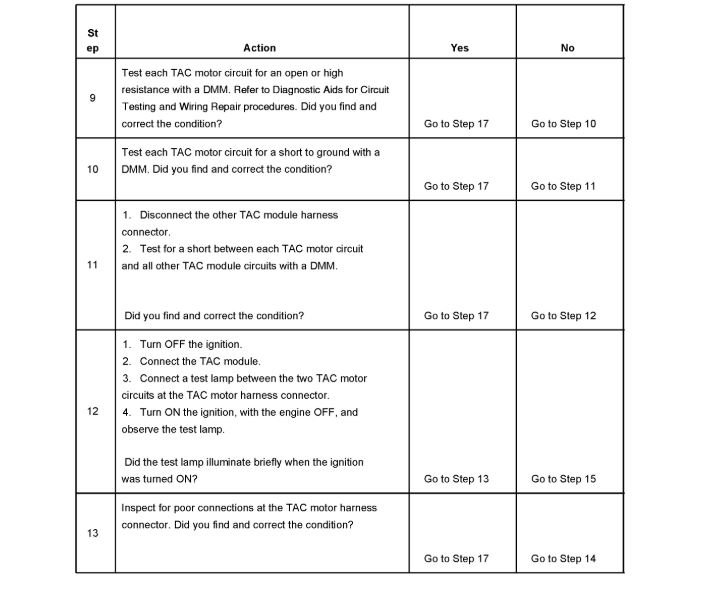

Steps 9-13
imageZoom/Print

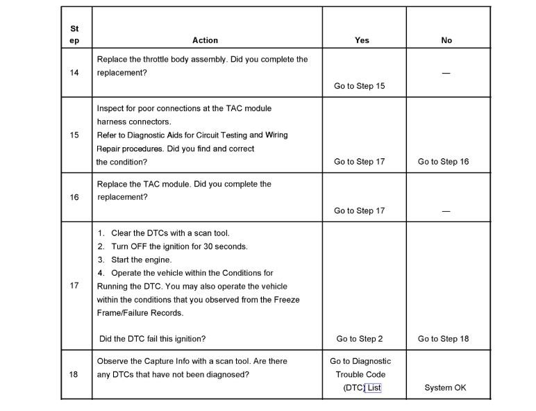

Steps 14-18
imageZoom/Print
The numbers below refer to the step numbers on the diagnostic table.
7. If the TP indicated angle does not follow the movement of the throttle blade and no TP sensor DTCs are set, there is a mechanical condition with the throttle shaft or the TP sensor.
18. Locating and repairing an individual condition may correct more than 1 DTC.

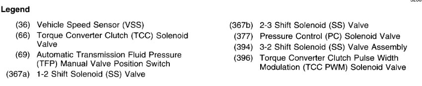

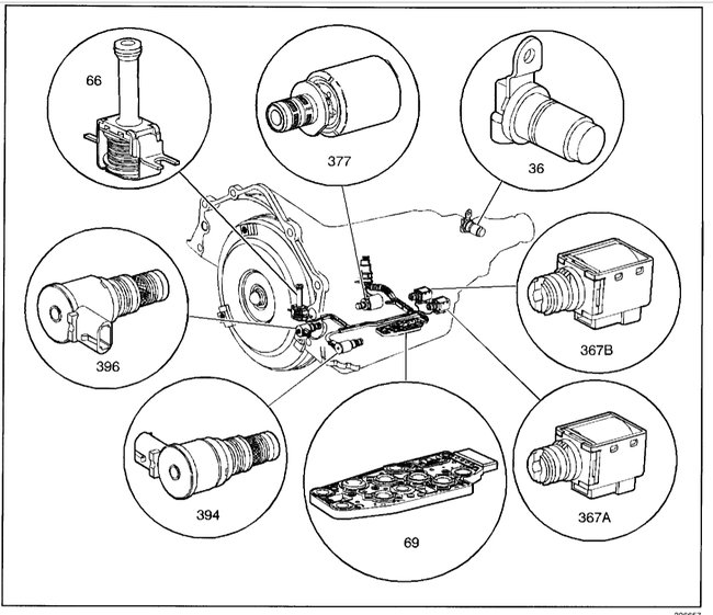

I believe transmission is stuck in limp mode. Takes off in second or third. No overdrive. sixty five mph 3,000 rpm's. Reverse is fine. Can be manually shifted down to first or second. But will only go into second. Funny thing is when truck is cold it shifts out. But with a hard second gear shift. It is push button four wheel drive and it is not working. Do not know why. Brake light switch is out also. Where do I start? Please help 2carpros. Speedometer works, tachometer works.
Sep 10, 2020 at 6:00 AM (Merged)
  • 55,402 POSTS
It sounds like you have a first gear solenoid not working but we should start by running the codes to see whats come up.
Here is a guide to help you get the transmission pan off to change the solenoid:
Check out the diagrams (below). Please run this test and get back to us.
