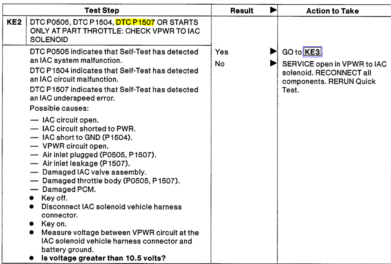

I forgot to mention that I have a P1507 code displayed.

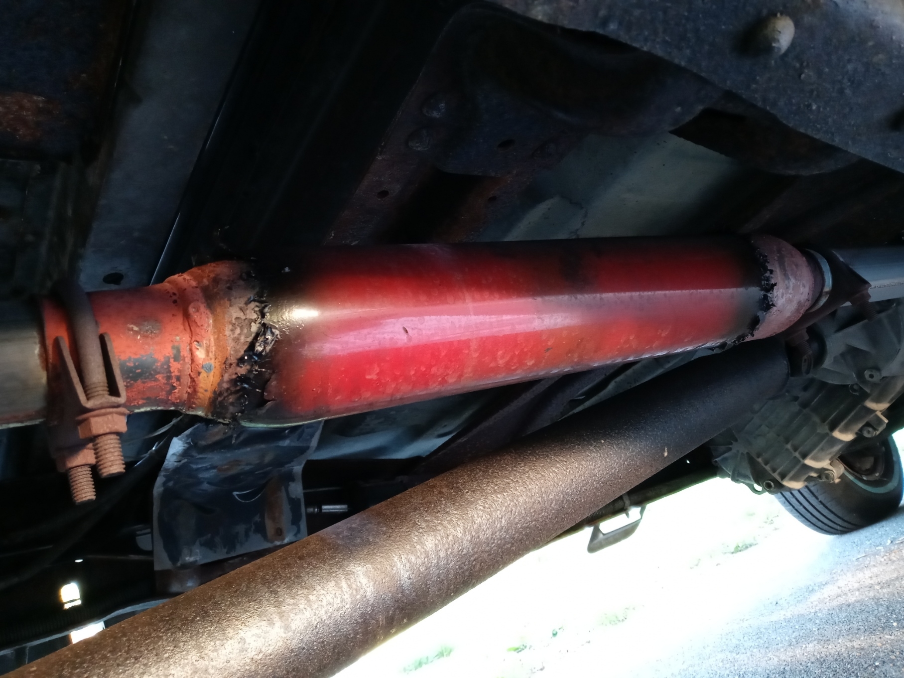

I was doing a visual inspection and found that the overheat was reaching the cheap muffler I installed. This is beyond the two catalytic converters. Where do I look to solve this problem?
Jun 15, 2021 at 11:40 AM
  • 110,248 POSTS
Wow, that is a concern. Let's start with a few basics. Recheck engine timing to make sure it isn't off. Also, if you have a live data scan tool, let me know what the short-term fuel trims are. If the timing is correct, either it is running extremely lean or rich. One other thought. If you remove the oxygen sensor before the converter, does the problem change?

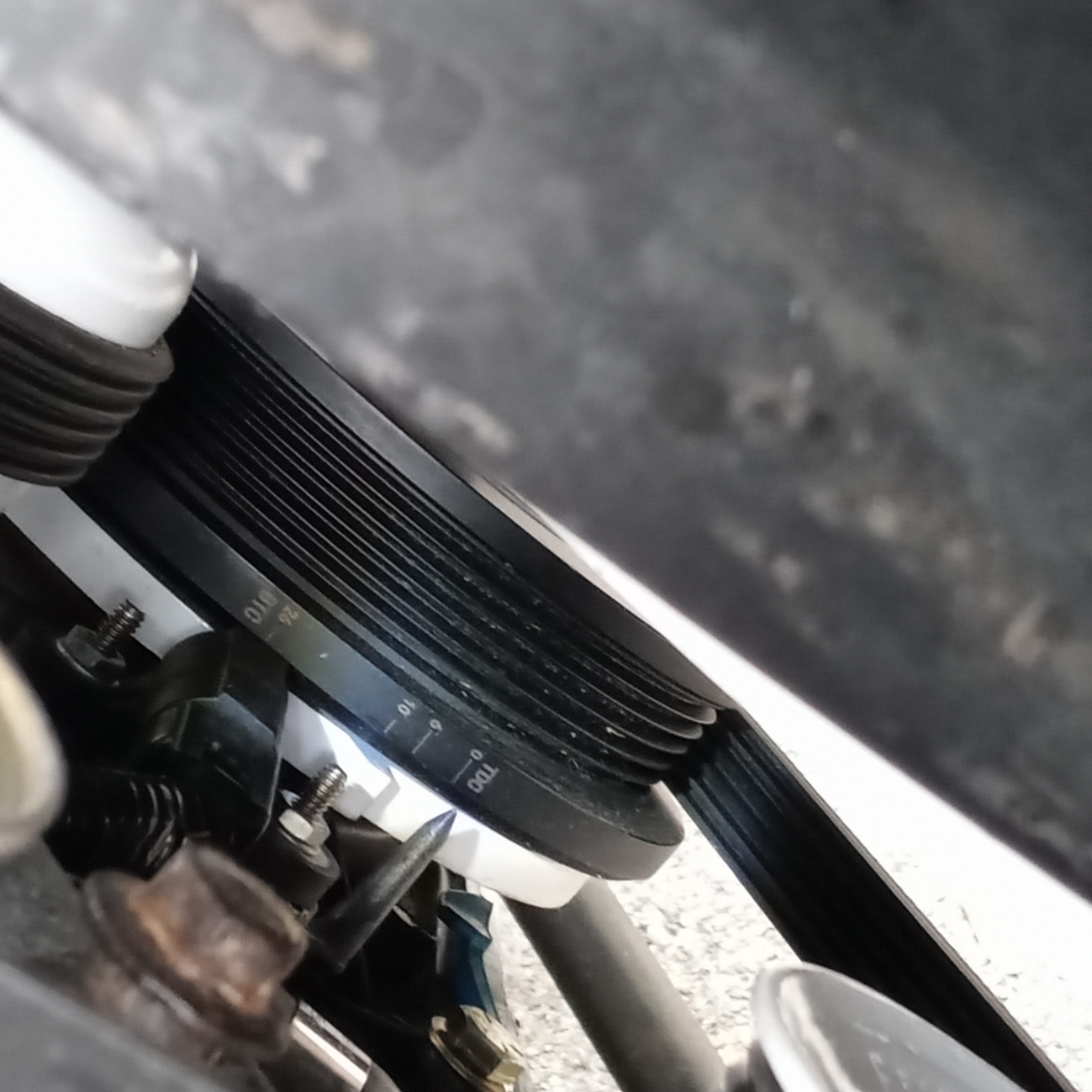

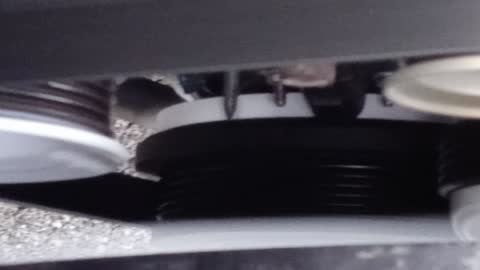

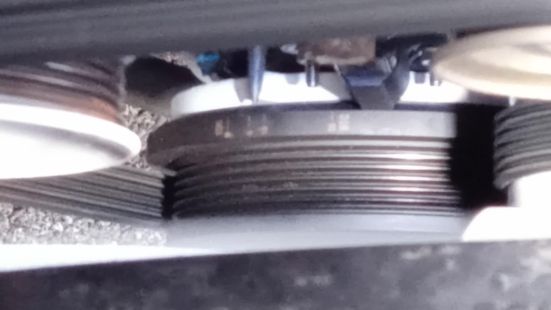

This is the timing...

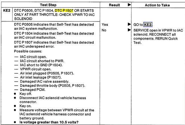

Are there any misfires? Have you checked the timing? Also, it could be dumping fuel. The code you gave me, P1507, is related to the idle air control valve. It could be choking the engine not allowing enough air which in turn would cause a rich fuel mixture.
I attached the diagnostics below specific to the code. Take a look through them and let me know if you are comfortable doing them
Let me know if that helps. In my mind, if the converter is good and fuel pressure us good, something is causing it to dump fuel or the timing is retarded.

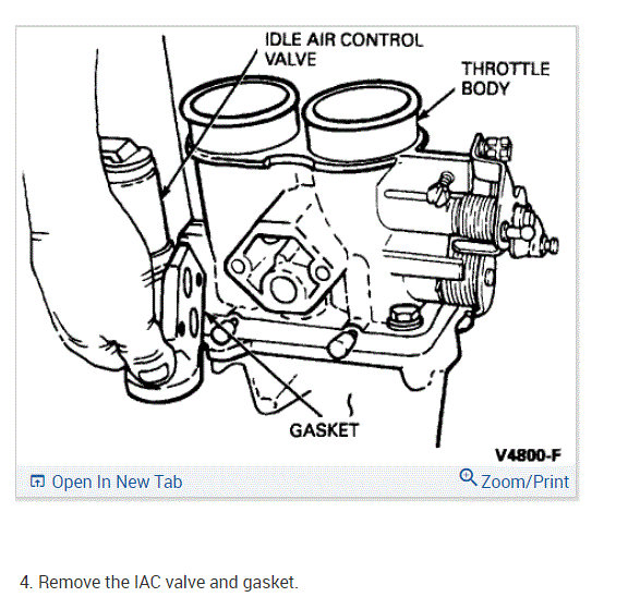

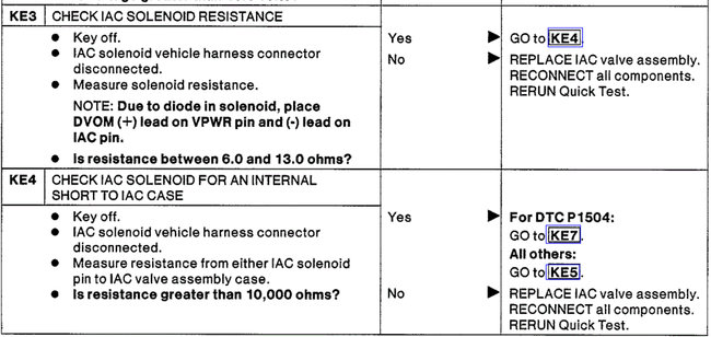

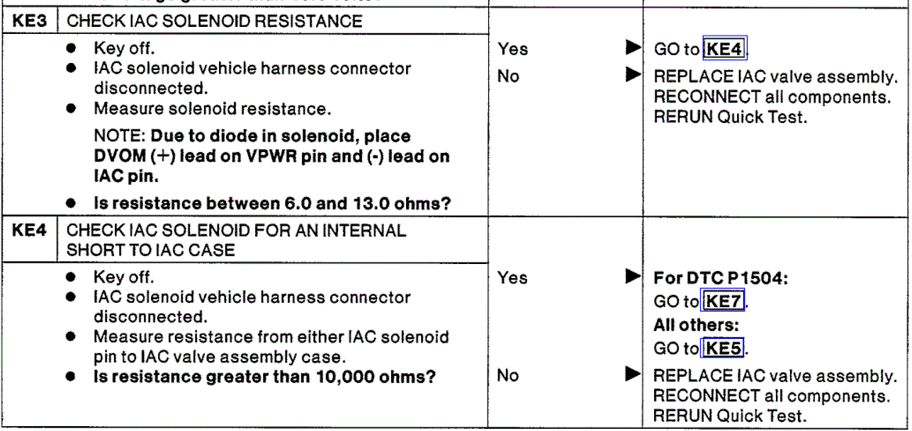

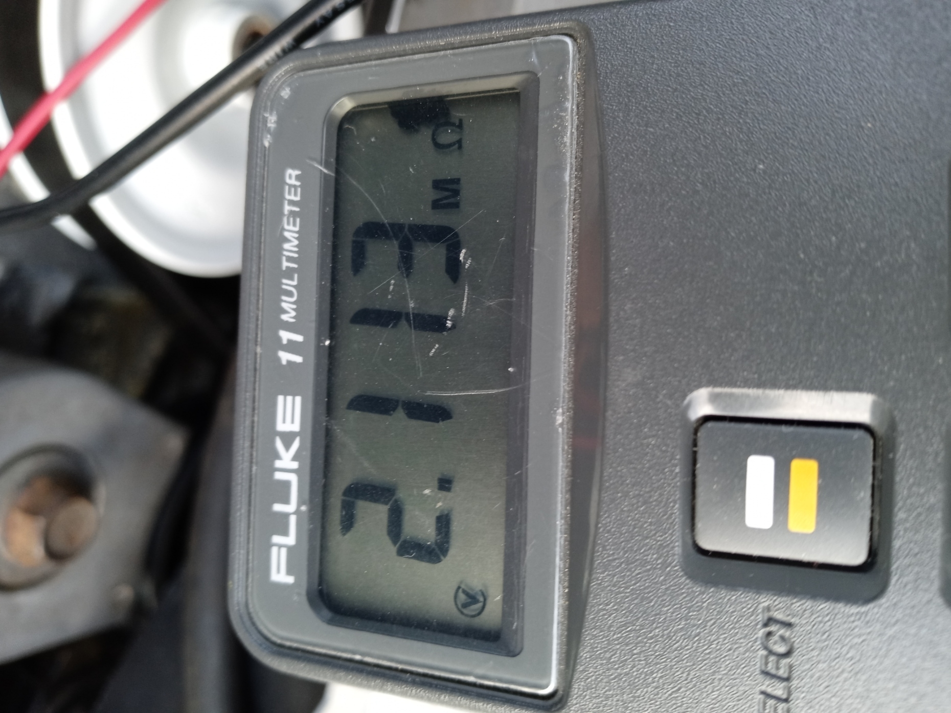

The voltage is 12.3v and the resistance is 2.11m ohm.
Jun 18, 2021 at 9:09 AM
  • 110,248 POSTS

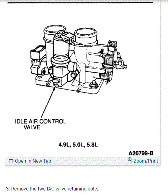

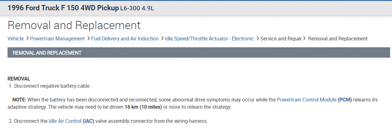

If you are getting 2.11 m ohms, the IAC is bad. The flow chart indicated it should be between 6 and 13 ohms. Have you tried replacing it?
Here is a link that shows how it's done in general. You can use this as a guide.
https://www.2carpros.com/articles/how-to-replace-an-idle-speed-control-motor-iac
The directions specific to your vehicle are attached below.

Okay, the IAC has 9.4 ohms across the pins. I was doing it wrong. What is next to check?

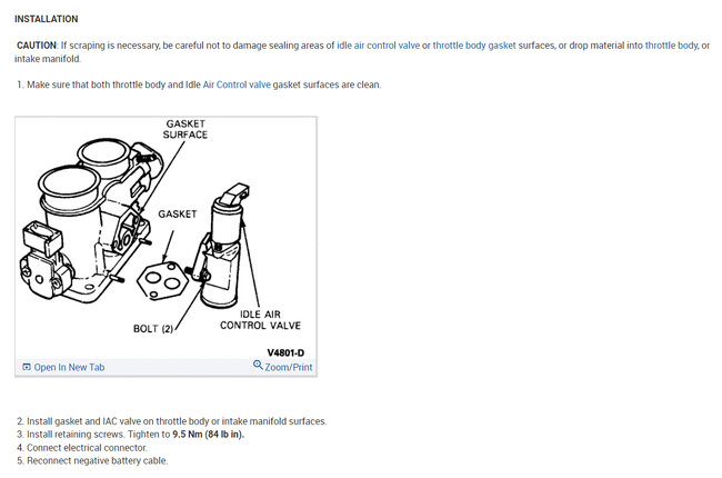

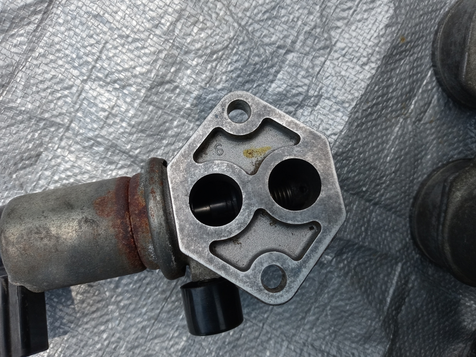

That sounds a lot better. What I would do next is remove it and inspect where it mounts on the throttle body. It isn't uncommon for carbon and dirt to build up and restrict airflow. Keep in mind that I am basing this on the code you provided.
Take a look through this link and let me know if it helps:
https://www.2carpros.com/articles/idle-air-control-valve-service

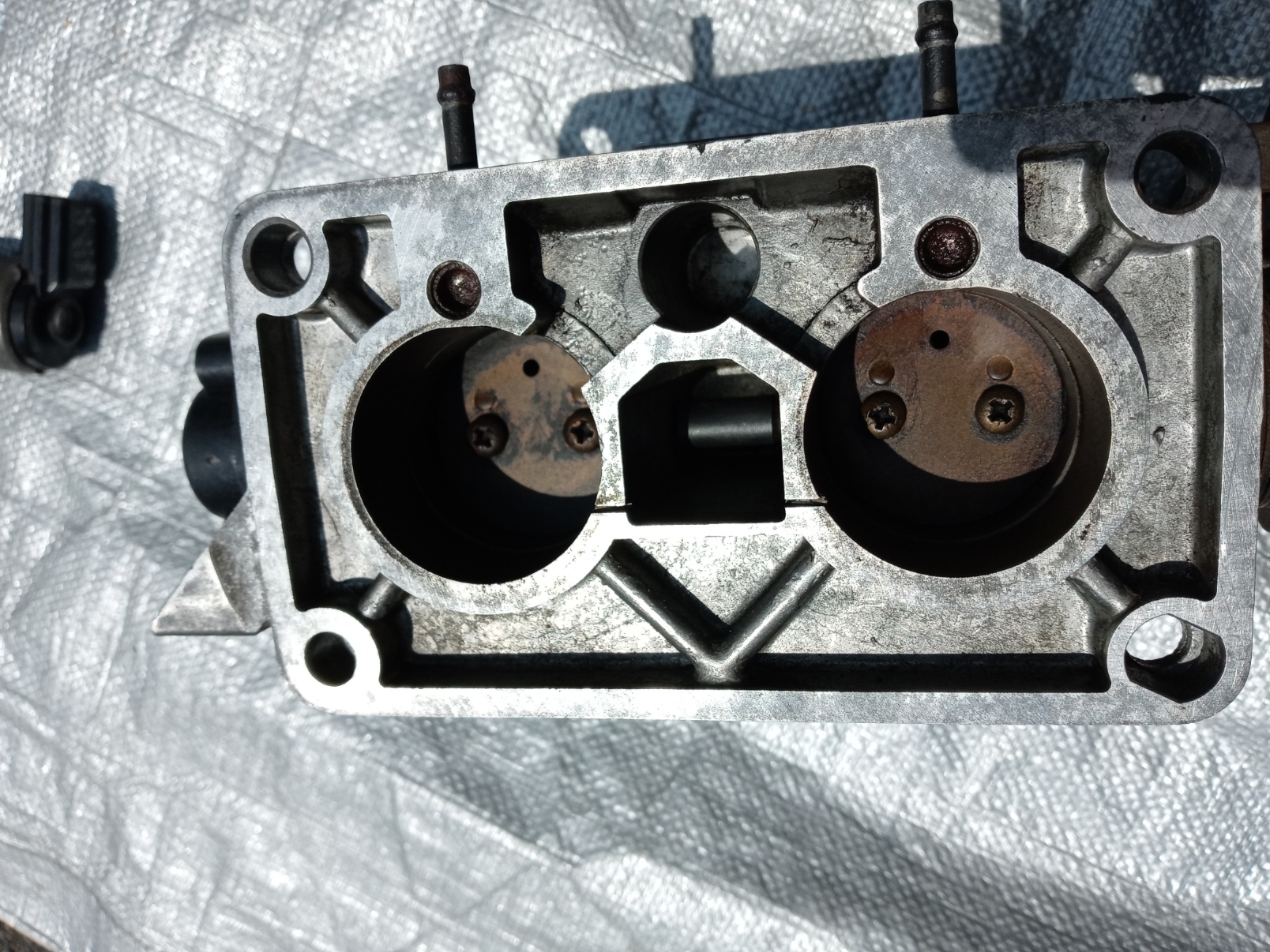

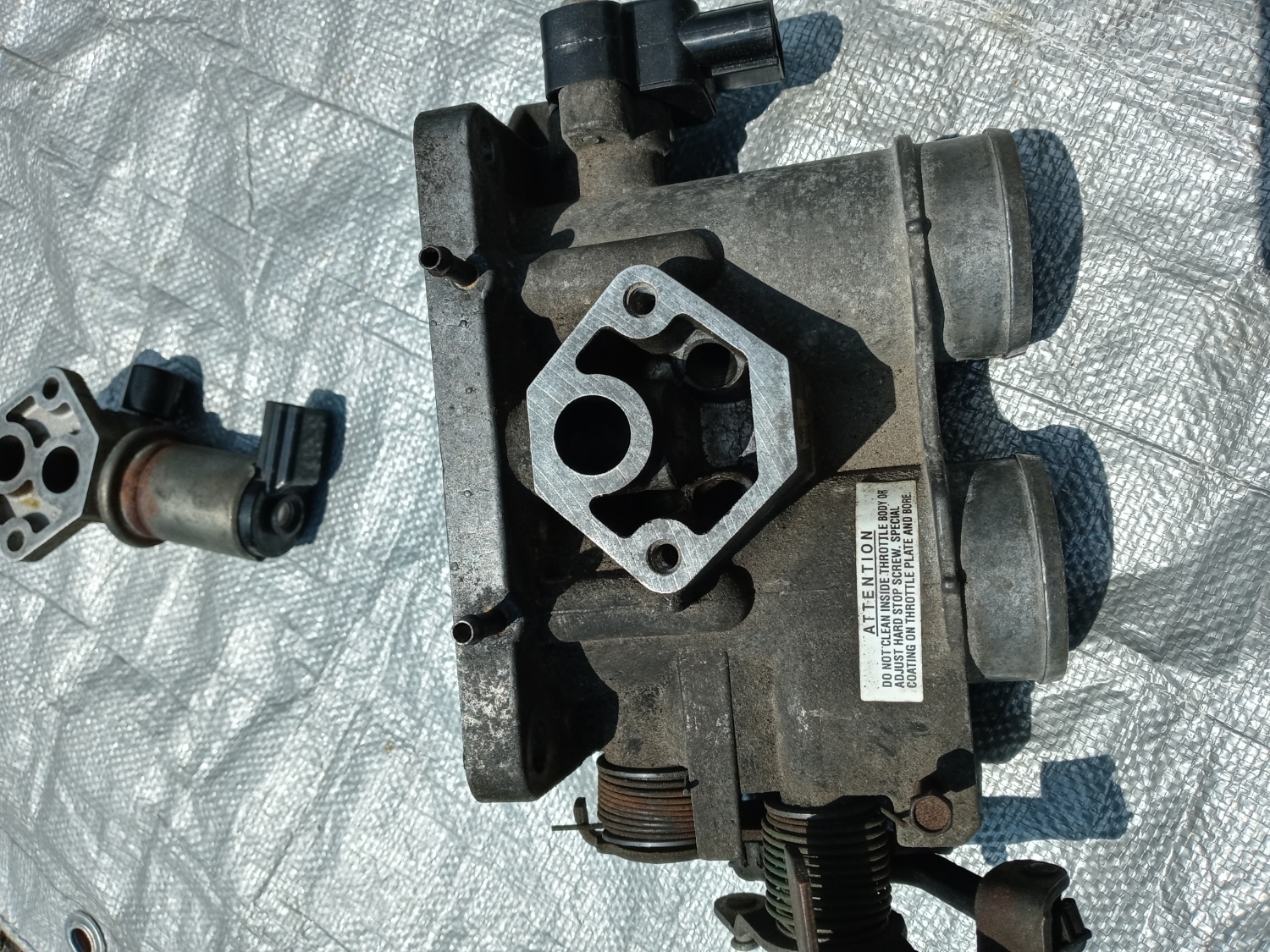

Okay, this is where am at: I removed the IAC and the throttle body and found no noticeable accumulation of carbon deposit. Blew air through all the orifices and did not find any obstructions. Put it all back together. Disconnected the air filter. Turned the vehicle on, turns right on, no problem. The STFT starts at 36% but in less than a minute, they lower to the single digits but not zero or negative. It idles really rough. The check engine light has not turned back on.

Has the check engine light turned off (is the code gone for the IAC)?
I rewatched your video of the timing. In the video, I don't see the marks. Also, I'm hearing a strange noise (not a knocking) but something that sounds like it's hitting?
It's a video so I may be totally wrong. But, have you noticed it?
The fuel trims (in a perfect world) you want at 0. Up to 10% positive or neg are normal. The cold start +38% isn't out of the ordinary. So, I'm to the point that I'm thinking it isn't a fuel-related issue.
I think we need to start over. We are missing something.
Are there engine vacuum leaks? Any possibility of internal timing issues when it was put together? Any chance of the exhaust being plugged?

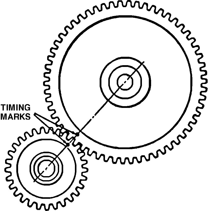

The timing you mentioned is correct. However, that is where the distributor is set. That can be adjusted. The timing chain, if not perfect, can't be adjusted externally.
Take a look at the pic below. Is that how you had the timing marks aligned?
Let me know. Also, I listened again to the video of the engine running. Do you have good oil pressure? Is the sound coming from the top end? Did you do anything as far as the valve lifters?

-The timing illustrated in the picture is exactly how I set my timing.

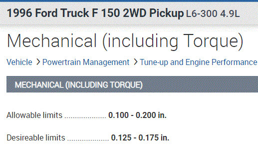

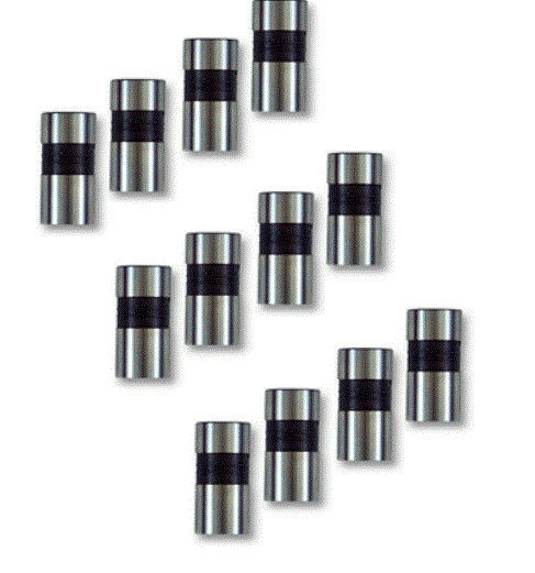

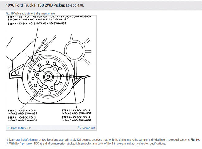

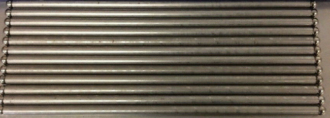

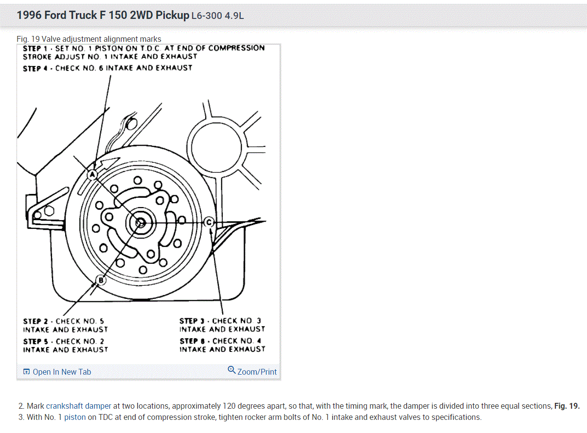

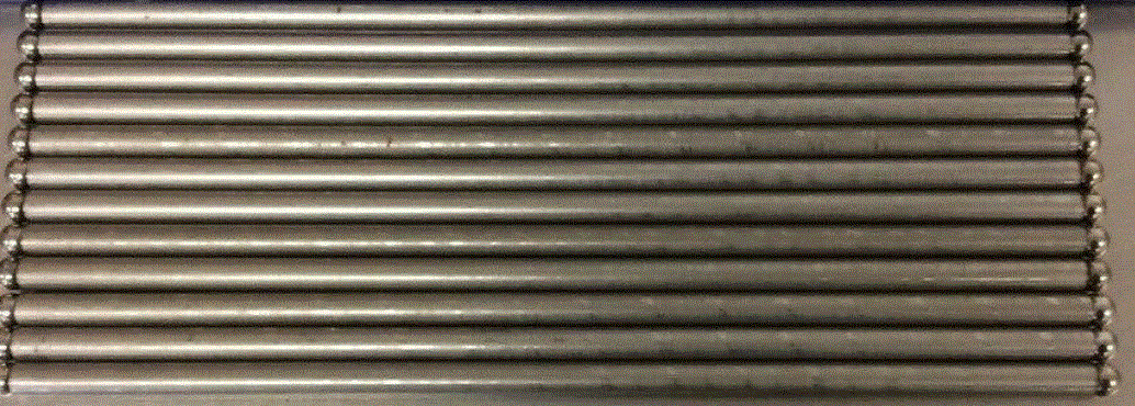

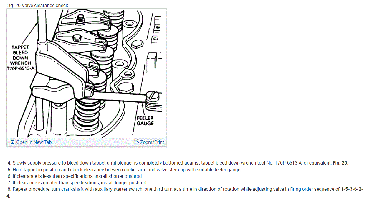

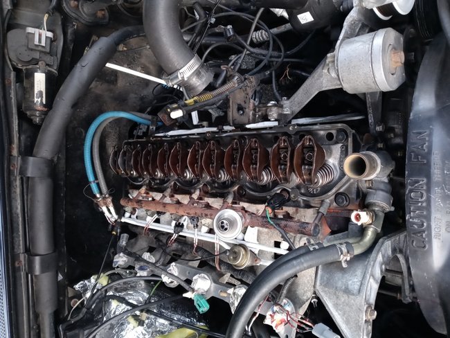

You have lifters and pushrods. Neither are in the head. When you adjusted the valve lash, how was it done? We may have hit on something here. If they are too tight, once the engine warms up and expands, the valves may be staying open too long or not full seating. There could be unburned fuel getting into the cylinders on an exhaust stroke. Did you check valve lash?
If you didn't, that needs to be done. Also, if you used the original pushrods, they needed to be reinstalled in the same location as they were removed from as well as the lifters. Adjustment is done by using shorter and longer pushrods.

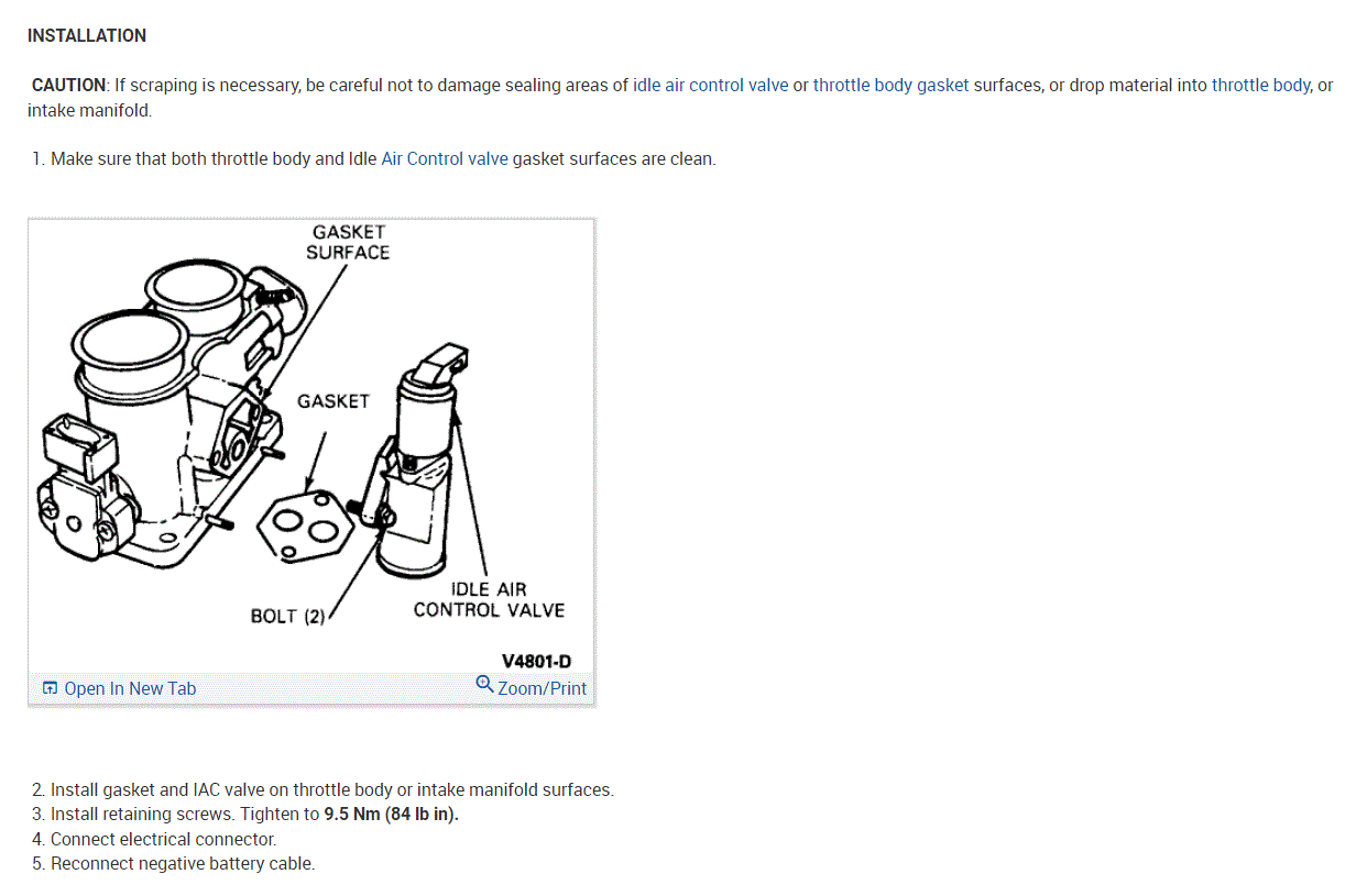

Starting with pic 3 below are the directions for valve adjustment. You may have already done this or this may be the problem. Finally, I think I know what is happening. I suspect you have pushrods that are too long. They are causing the valves to hang open slightly. and fuel is getting into the cylinder on an exhaust stroke. It's a theory at this time, but I have a feeling this is the issue.
Let me know if you already did this.
Jun 23, 2021 at 2:34 PM
WHITESHIRTSAMMY
  • 60 POSTS
I saw the valve adjustment in the repair manual but since I was working on my driveway ( I don't have a garage) I was anxious to put it back together. I ordered all standard parts and assume they would fit correctly the first time.
I skipped the valve adjustment part.
Sorry, I confused the rocker arm with the lifter. All I did to the cylinder head was transfer over the rocker arm and torque them to spec.

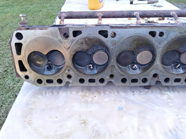

Hello, I am back on this. I took the head off to inspect for valve damage since I overheated the engine exhaust, a few times. I don't see any damage but I don't have a trained eye. How can I verify that all the valves are seating correctly?

Since the engine didn't overheat, it should be fine. Take a bright flashlight and shine it on each valve in the head. See if there is any light going through. You will see it if there is an issue. You will be able to see it in the inlet/exhaust ports on the head.
Let me know what you find.
Sep 5, 2021 at 11:42 AM
WHITESHIRTSAMMY
  • 60 POSTS
Checked all the valves via exhaust/intake, no light passes. But if the air is not escaping through the valve where then.
What can i check?

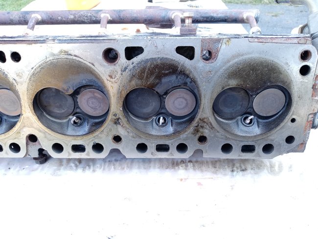

Okay, so, I got a new head gasket, reinstalled the cylinder head, and torqued it down. I am still having the same problem. I cannot build pressure in the #1 cylinder. Initially, I thought it was leaking thru the gauge, so I took it out and installed the spark plug; still, same.
It must be leaking through the valve.

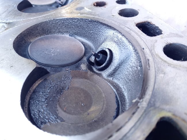

My apologies. I am not using the correct terminology.
I am not getting compression on the number one cylinder after reinstalling the cylinder head with a new head gasket and spark plug fully installed. When I manually turn the crankshaft, I hear air escaping from somewhere.
That last picture is of the number one cylinder before I reinstalled the cylinder head.

Okay, if you hear air escaping, try this. Either it will be going through the intake, exhaust, or if the rings are bad enough, through the crankcase which is unlikely.
Remove the inlet air tube between the throttle body and air filter box. See if you can hear it there. If nothing, then remove the oil fill cap to see if it sounds like it is coming from there. If not, then the exhaust is left.
Is there any compression being produced by cylinder 1?
Let me know
