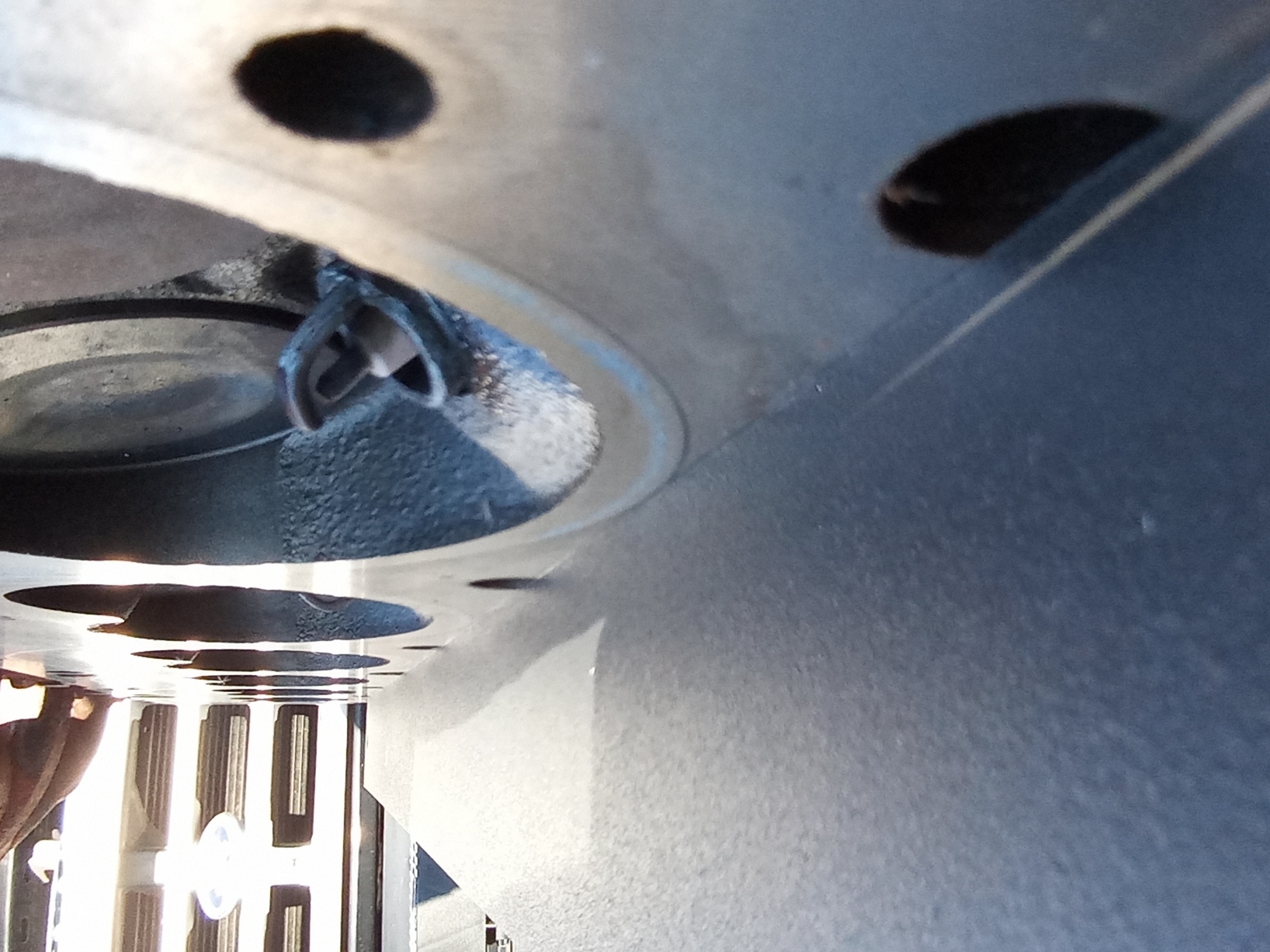

How quickly are you turning the crank? I always allow the compression to hit 5 times minimum turning the engine with the starter motor. However, if it drops to 0 when you stop, something is certainly leaking. You had the head redone, correct?
I'm sorry. This would be so much easier if I was there. When you indicate new things, it causes new thoughts to come to mind.
So, if the cylinder walls were in good shape, the first thing I can think of a valve isn't properly seating, the block or head is warped, or for some reason beyond my knowledge, something caused the compression rights to totally fail.

I am turning the crank with a wrench. I cannot get much of a spin on it. 20PSI sounds reasonable.

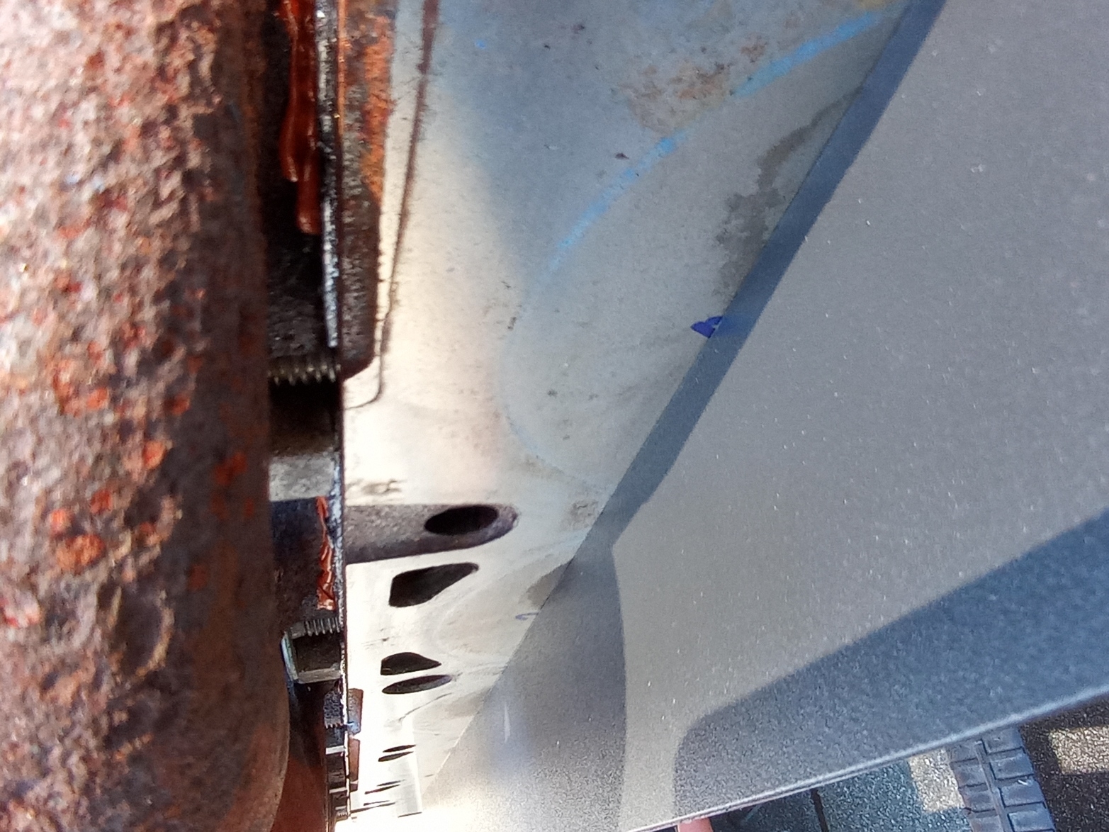

I am going to take the cylinder head back off this weekend, so we can take another look at it. I will send pictures.

Sounds good. Make sure everything is straight on the block and head. Something isn't making sense. Also, check if there is any evidence where the head gasket isn't compressed as much.
Before you actually remove the head, check compression the same way on the other cylinders to compare.

I am confused. Cannot find anything out of tolerance.

Either the compression is going through a valve, the compression rings are bad, or there is a crack somewhere. Compression should be over 100. Will the people that redid the head check it for you? Have you tried a wet compression test? If the rings are bad, compression will increase.
