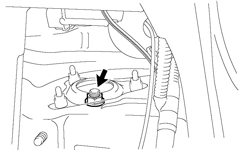

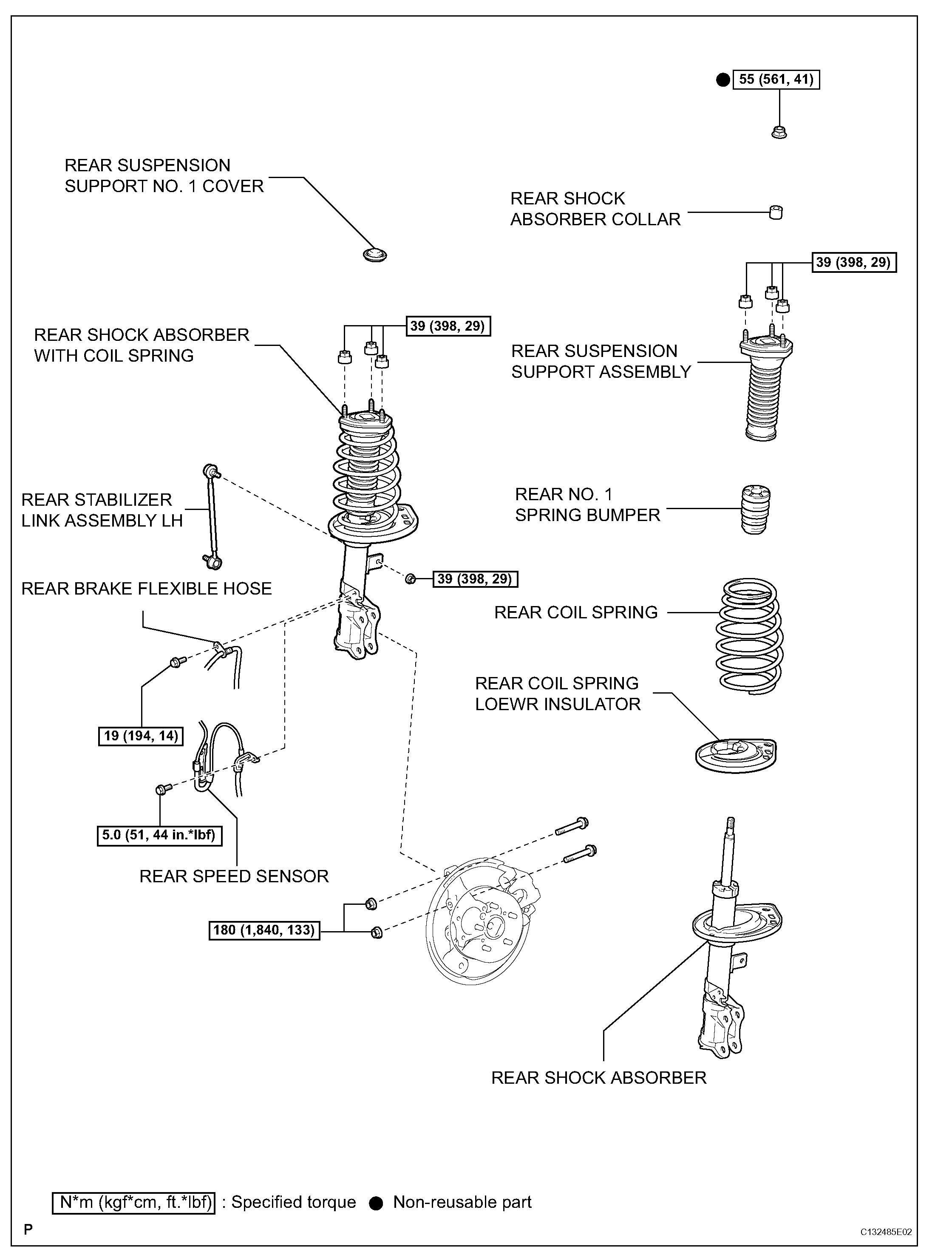

If you plan to replace the shock / coil (strut assembly), I would simply purchase a strut assembly. That will include the mounts. As far as the sway bar links, they will need to be removed to replace the strut assembly. I know a lot of people that purchase the entire strut assembly from Rockauto.com. I guess the price is really good on the entire assemblies.
If you decide to replace the entire unit, here are the directions. I can tell you the rear seatback needs to be removed to access the top bolts.
Here are the directions. The attached pics correlate with the directions. Note: The directions include taking the strut assembly apart just to replace parts. If you get the entire assembly, you can skip that part.
_____________________________
See pic 1
Removal

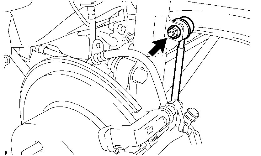

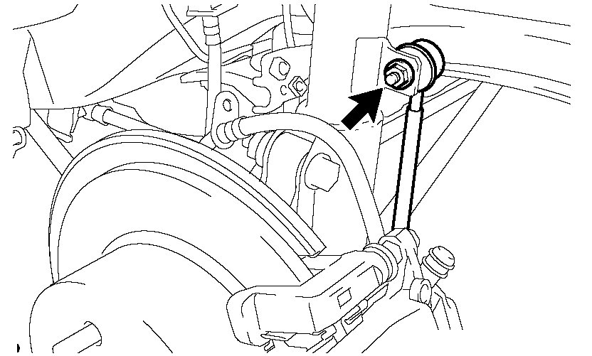

18. SEPARATE REAR STABILIZER LINK ASSEMBLY LH
(a) Remove the nut and separate the rear stabilizer link assembly from the front shock absorber LH.
HINT: If the ball joint turns together with the nut, use a hexagon wrench (5 mm) to hold the stud.

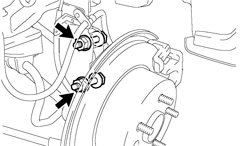

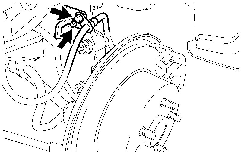

19. SEPARATE REAR SPEED SENSOR
(a) Remove the 2 bolts, and disconnect the rear brake flexible hose and rear speed sensor from the rear shock absorber with coil spring and rear axle carrier.
NOTICE: Be sure to remove the rear speed sensor from the rear shock absorber with coil spring.

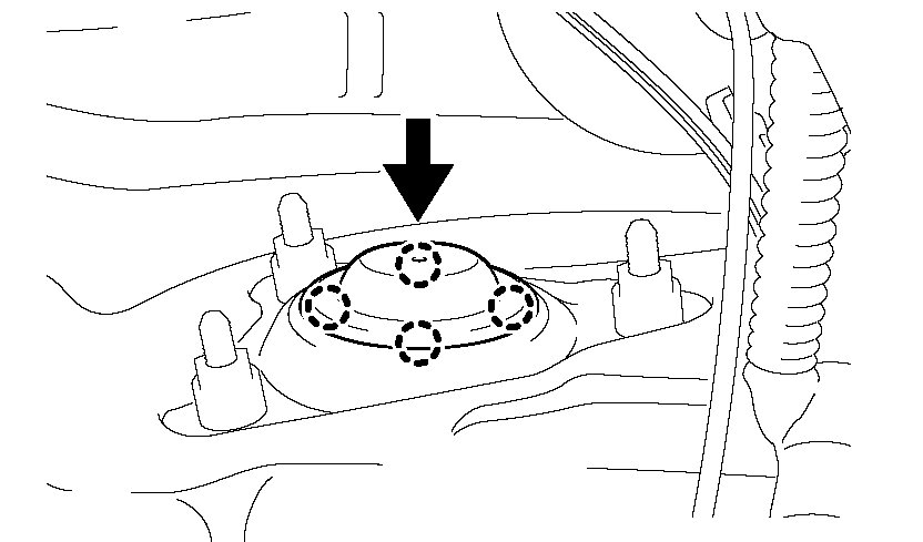

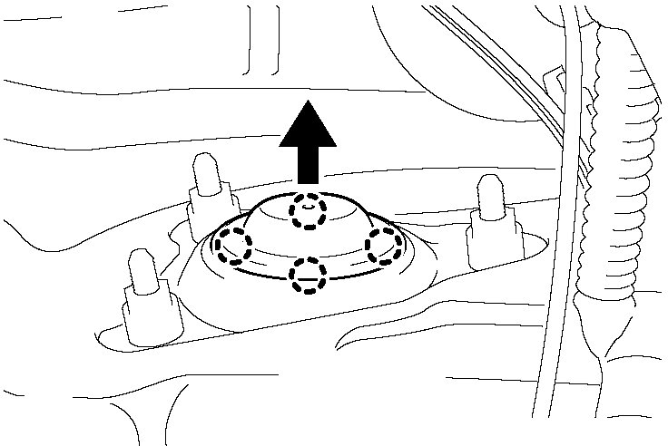

20. REMOVE REAR SUSPENSION SUPPORT NO. 1 COVER
(a) Remove the 4 claws and the rear suspension support No. 1 cover.
pic 5

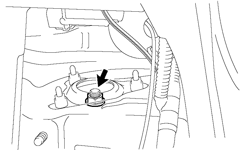

21. REMOVE REAR SHOCK ABSORBER WITH COIL SPRING
(a) Loosen the lock nut of the rear shock absorber with coil spring.
NOTICE:
^ Do not remove the lock nut.
^ Only loosen the nut when disassembling the rear shock absorber with coil spring.

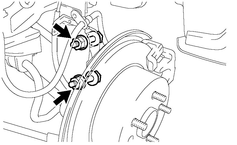

(b) Remove the 2 nuts and 2 bolts on the lower side of the rear shock absorber with coil spring.
NOTICE:
^ When removing the nuts, keep the bolts from rotating.
^ Keep one bolt inserted to secure the hub and disc rotor.
pic 7

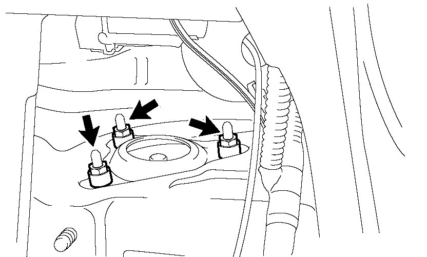

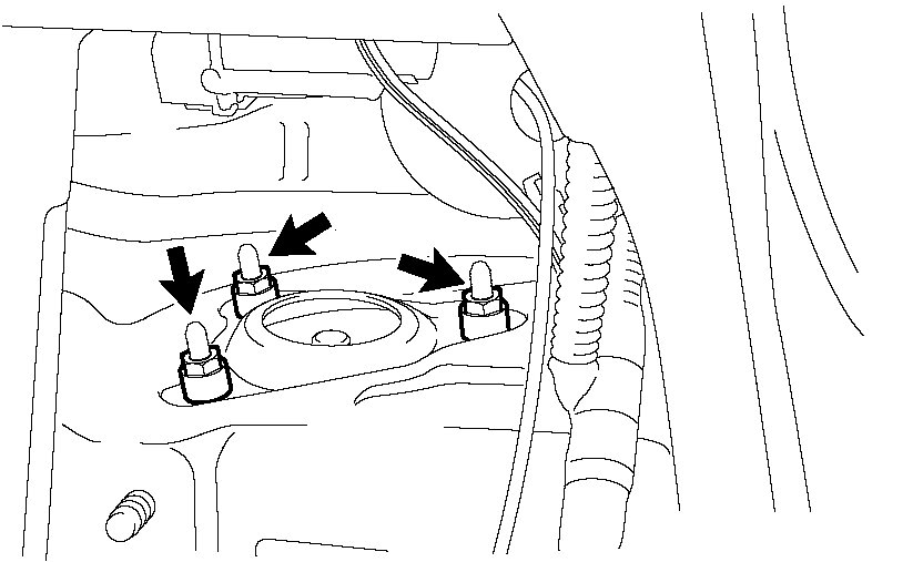

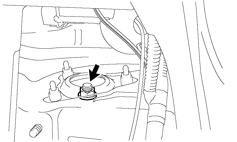

(c) Remove the 3 nuts on the upper side of the rear shock absorber with coil spring.
(d) Lower the rear axle carrier, and remove the 2 bolts on the lower side of the rear shock absorber with coil spring.
NOTICE: Make sure that the rear speed sensor is disconnected from the rear shock absorber with coil spring.

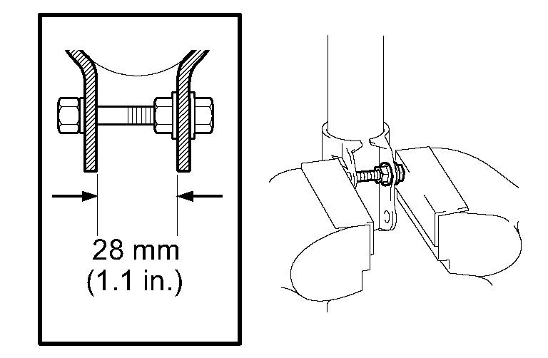

1. FIX REAR SHOCK ABSORBER WITH COIL SPRING
(a) As shown in the illustration, secure the rear shock absorber with coil spring in a vise using aluminum plates by closing the vise onto the double nutted bolt affixed to the bracket at the bottom of the absorber.

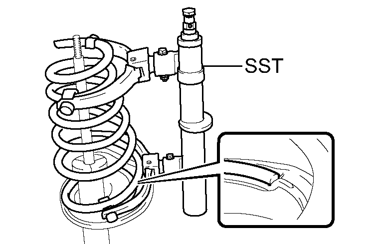

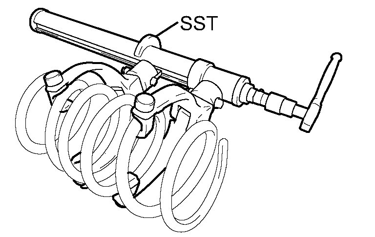

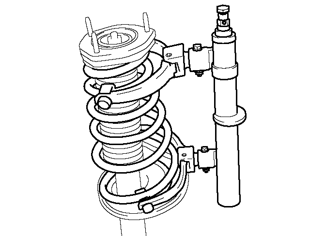

(a) Using SST, compress the rear coil spring.
SST 09727-30021 (09727-00010, 09727-00021, 09727-00031)
NOTICE: Do not use an impact wrench.
HINT: If the front coil spring is compressed at an angle, using 2 SST will make the work easier.
(b) Remove the nut, rear shock absorber collar and rear suspension support assembly.
(c) Remove the rear coil spring, rear No. 1 spring bumper, and rear coil spring lower insulator.

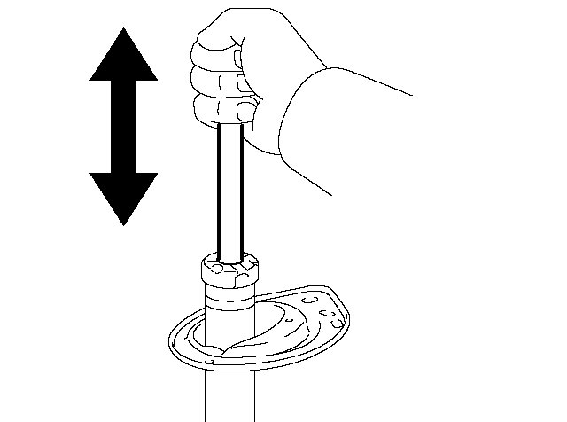

1. INSPECT REAR SHOCK ABSORBER
(a) Compress and extend the shock absorber rod 4 or more times.
Standard: There is no abnormal resistance or sound and operation resistance is normal.
HINT: If there is any abnormality, replace the rear shock absorber with a new one.

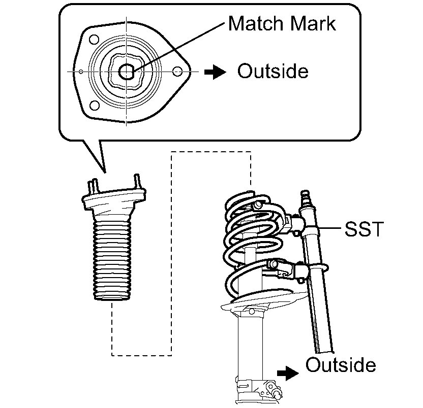

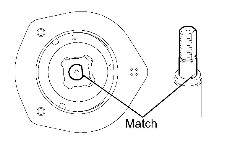

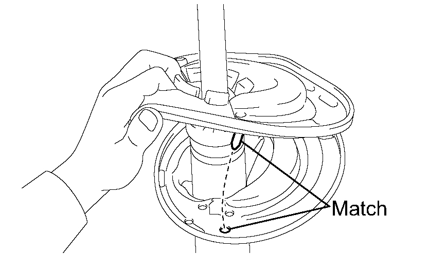

(e) Install the rear suspension support assembly.
NOTICE: Align the notches of the piston rod and the rear suspension support assembly as shown in the illustration before installing the rear suspension support assembly.

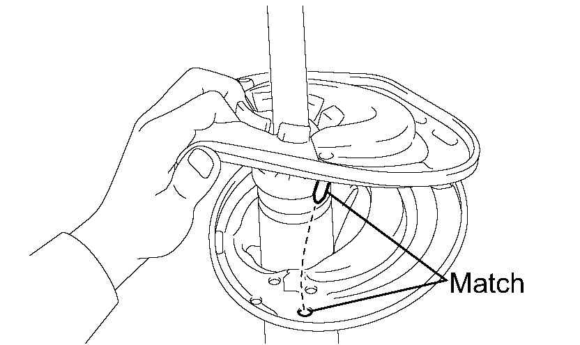

pic 15
(f) Align the notches of the shock absorber with the notch of the rear suspension support assembly so that the notches face the outside of the vehicle.
(g) Install the rear shock absorber collar.
(h) Loosely tighten a new lock nut to the rear suspension piston rod.

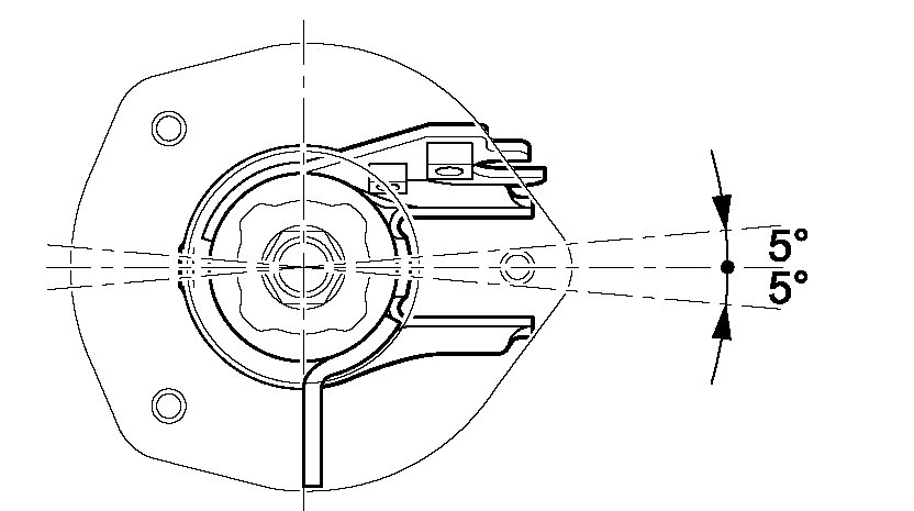

pic 16
(i) Release the spring while adjusting the rear suspension support assembly to the position shown in the illustration, and remove the SST from the rear coil spring.
HINT: When lining up the rear suspension support assembly's stud bolts at the middle point between the two sides of the bracket, the maximum permissible degree of error is ± 5°.

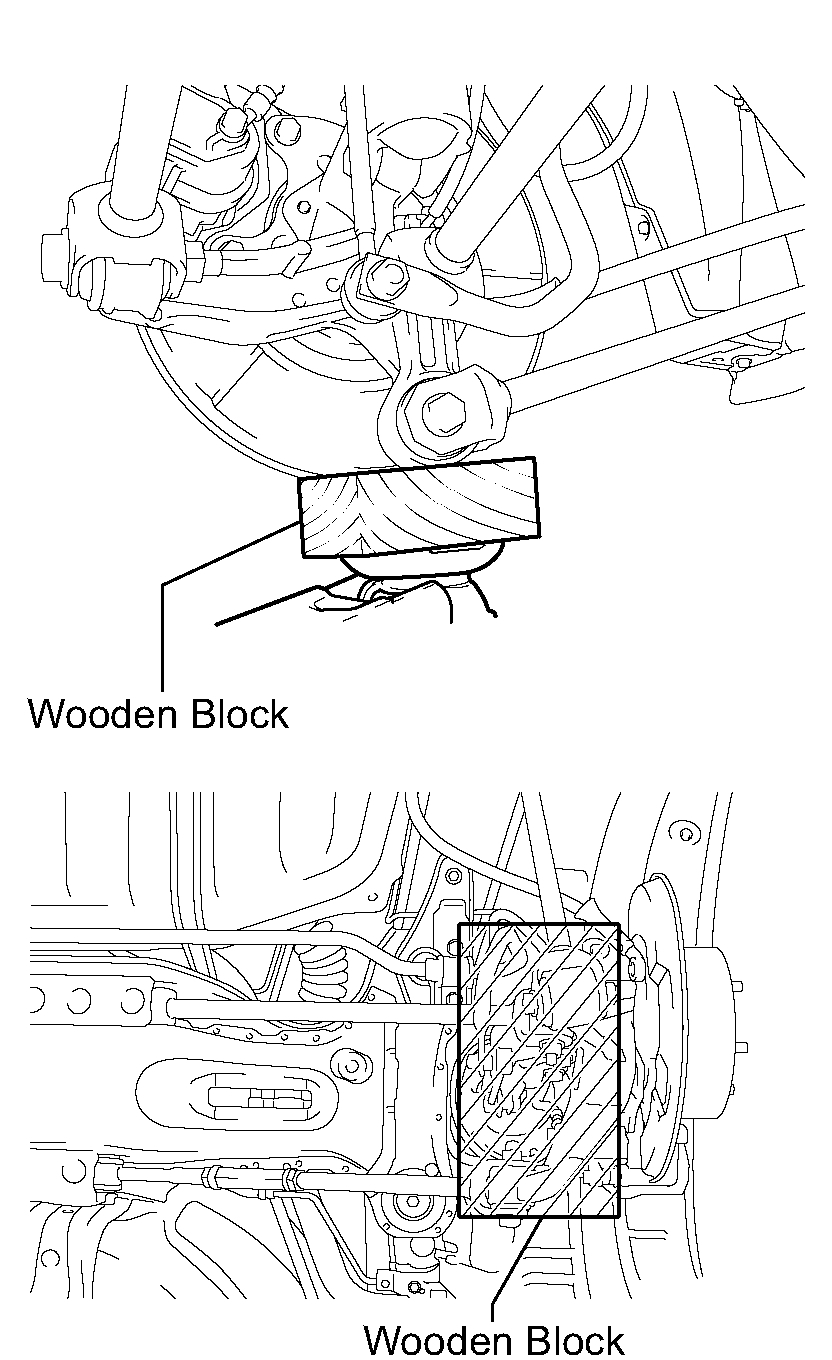

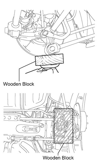

(b) Slowly jack up the vehicle using a wooden block and install the rear shock absorber with coil spring (upper side) to the vehicle.

(c) Install the 3 nuts to the upper side of the rear shock absorber with coil spring.
Torque: 39 Nm (398 kgf-cm, 29 ft. lbs.)

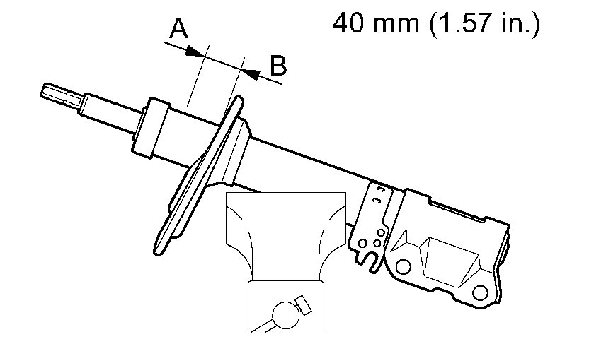

1. DISPOSE OF REAR SHOCK ABSORBER
(a) Fully extend the shock absorber piston rod.
(b) Using a drill, make a hole in the cylinder between A and B as shown in the illustration to discharge the gas inside.
CAUTION:
^ Be careful when drilling because shards of metal may fly about. Always use the proper safety equipment.

I think by "preloaded" you mean preassembled.. A common trade name for that is "Quick Struts". Those have been around for a number of years and provide a lot of benefits to car owners and mechanics.
Replacing just the struts requires the coil springs to be transferred to the new ones, and that requires them to be compressed to be removed. The act of doing that is fairly dangerous as a spring could slip out of the tool. I've seen one take out an 8-foot overhead light fixture, and one got away from me and shot across the shop, out the door, and through the parking lot.
A second problem refers to the upper strut mounts you mentioned. Those don't see a lot of wear on the rear, but they have to be able to rotate freely on the front struts. Those mounts are holding up all the weight on that corner of the car, and they rotate with the steering system. A binding upper mount can cause "memory steer" where the steering wheel stays where you put it instead of returning to center on its own. A common problem we have is most of the deterioration that can occur can't be seen until after the inspection, after the repair estimate is written and approved, and after the struts are removed and disassembled, then we have to find you and tell you more parts are needed than was first realized. There's also other hardware, namely bump stops, or cushions, that often can't be seen until we try to transfer them to the new struts and find they're crumbling or even missing. All of that is addressed when you replace strut as an entire assembly.
An alignment is needed when replacing front struts and on some car models when replacing the rear struts. Besides simply setting two or three main alignment angles, even though the numbers on the alignment computer look good, there can still be bad tire wear patterns and less-than-ideal handling if the geometric relationship of the steering and suspension parts aren't correct. That has to do with sagged coil springs. No conscientious mechanic will align a car with sagged suspension unless he is allowed to correct that first. That is where the new coil springs come in. You get those as part of the Quick Strut assembly.
Replacing struts as an assembly can take as little as a half hour on many car models. That's less than half the time it takes to disassemble them and transfer all the hardware to a pair of new struts. You'll pay only slightly more for the complete assembly, but you'll pay a lot less for labor. A competent do-it-yourselfer can even replace struts this way, and get a better job than just replacing the struts.
