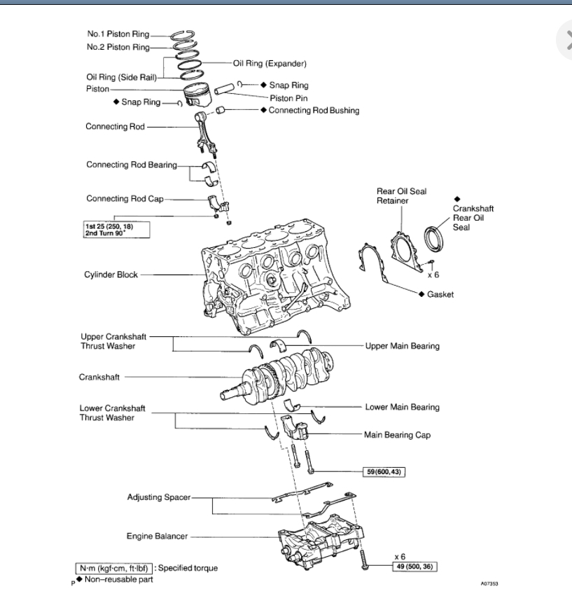

rear main seal replacement
1999 TOYOTA CAMRY
158,000 MILES • 1.4L • 4 CYL • 2WD • AUTOMATIC
MITRAVINDA
oil leaking.
Oct 2, 2020 at 8:36 AM

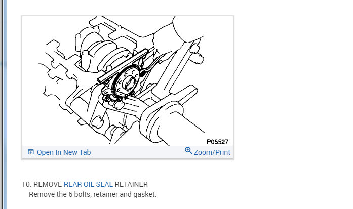

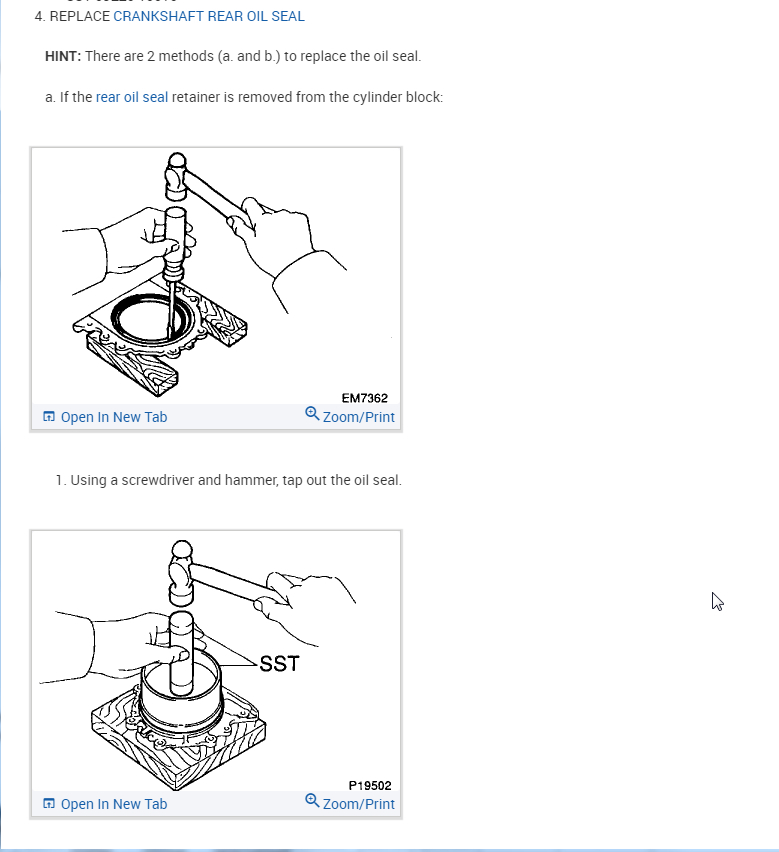

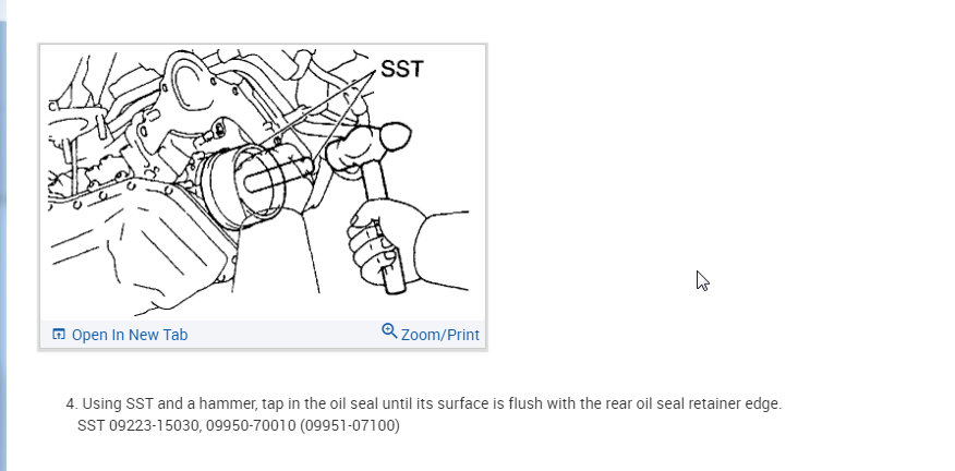

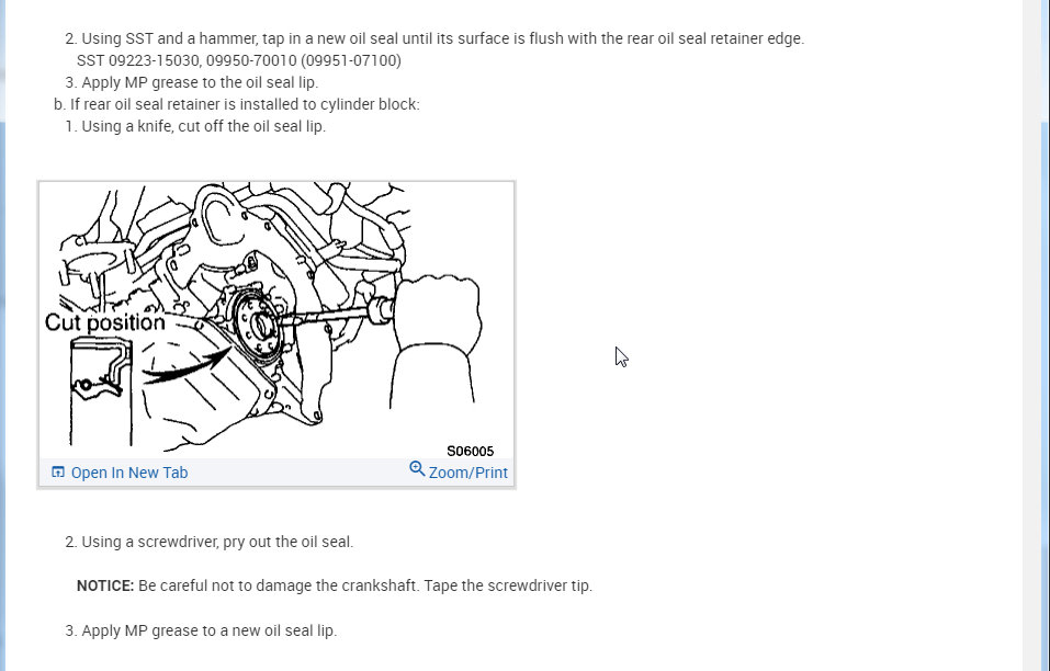

I am attaching the information from the manual on this. They go through this by removing the engine. You do not need to do this but you do need to remove the transmission.
Here is a guide that helps this in more general terms:
https://www.2carpros.com/articles/front-main-seal-replacement
Review this material and let us know what questions you have.
