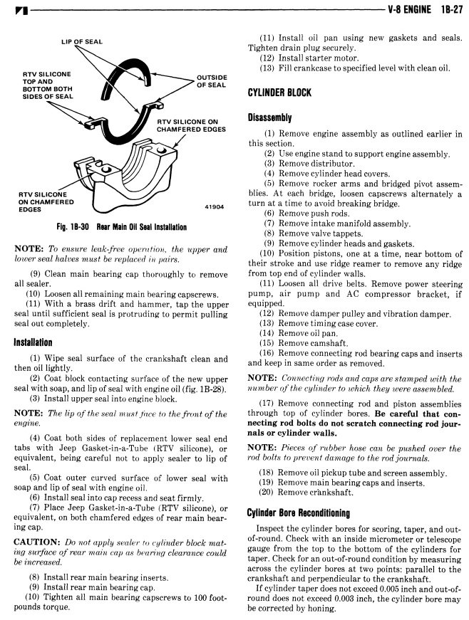

Here's the AMC Jeep manuals recommendations.
Adhere to the RTV application locations in their pic and also in the reading.
Return with good news!

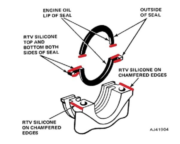

I don't know your mechanics abilities on the Jeep, he may have his own way of doing things (or not)
It's hard to say if the silicone was installed in the correct locations around the seal, there could have been misunderstandings with the manual's illustration.
Below I have traced in red the locations for the silicone to "dam" away escaping oil. Installing the seal "Dry" will not prevent leakages.
Other possible issues might be that the "Half moon" segment of the seal is being installed 180 degrees out from the way it should be--it's nearly impossible to get the other half of the seal wrong with the way it is made.
It is possible that the end of the crank could be damaged or worn, but even with some wear and a properly installed seal slight leaking might be tolerated, however if it is really excessively leaking, another crank might be in order

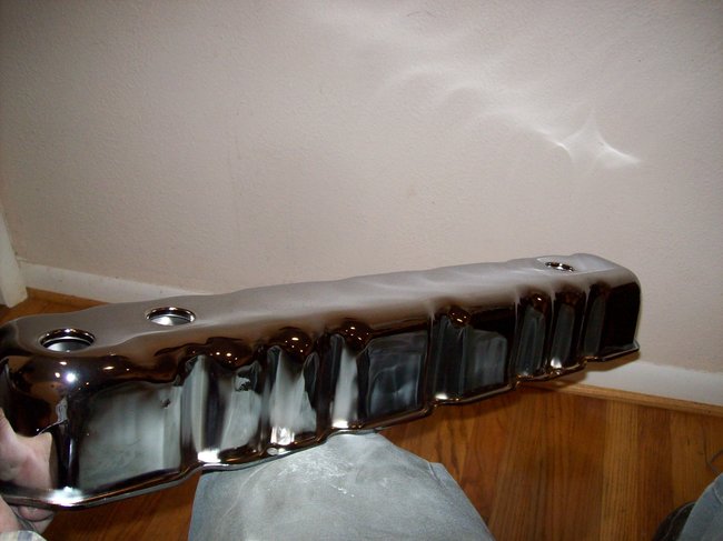

Here's wasted funds on a really pretty valve cover.
Nearly all of the rocker arms smack/scrape on the side.
$30.00 and chromed was too tempting to let slip away. I kept it to show folks!
