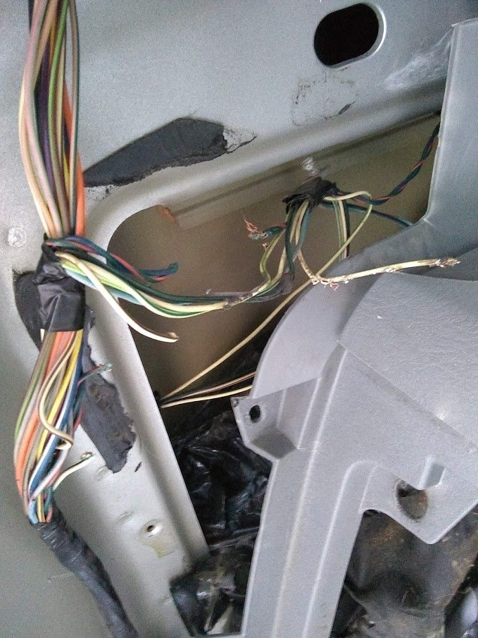

My rear driver's side turn signal/brake light went out the other night. I replaced the bulb, but it still didn't work (the old bulb was definitely bad). What is odd is that both rear tail lights are out. Rear passenger turn signal/brake light works fine, as do the front head lights, turn signals and parking lights. License plate and reverse lights come on also. Any help would be greatly appreciated.

Little update:
After taking a light tester to the connector, I found that there was no juice. Started following the wires and found that a rat had gotten in the jack storage compartment somehow and chewed up a light blue wire. Not sure if that wire is the taillights or brake/turn signal. I'll splice it tomorrow and go from there.

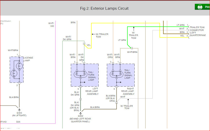

Hello, I'm Danny.
I'm attaching a wiring diagram for the rear tail/turn signal circuit. It shows as a green wire.Let me know what happens after you splice reconnect. Here is a tutorial for you about wiring if needed:
Hope this helps and thanks for using 2CarPros.

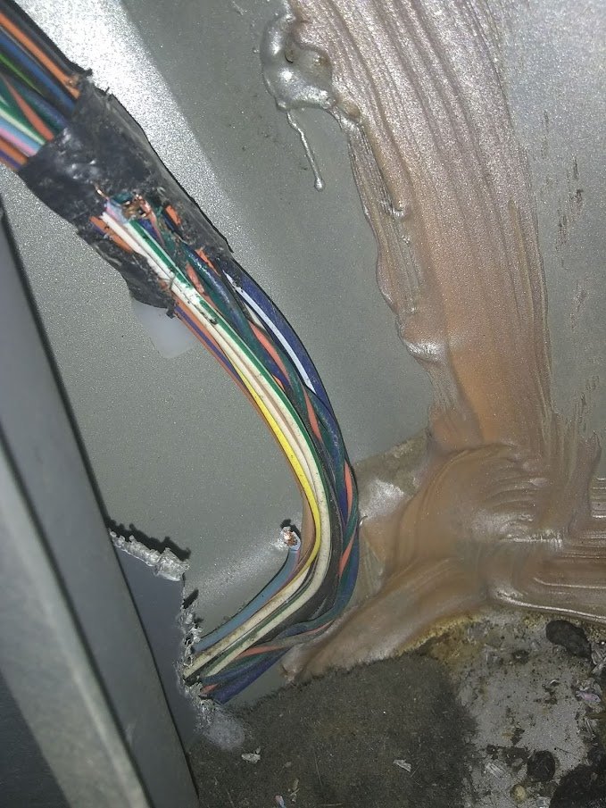

I wonder why the wire color is different. Here's a picture of the damaged wire (there may be more, I haven't gotten too deep into it yet).
Jan 7, 2019 at 8:04 AM
FJGRIMES
  • 5 POSTS
Well hmm, if I zoom in real close, it looks like a green wire might be damaged, too. The light blue wire is missing a 4 or 5 inch section, so there's no question there.
Jan 7, 2019 at 8:07 AM

Thanks, Danny. After digging deeper, that was the tip of the iceberg. There were several other wires behind the wall panel that had been severed by the little bugger. Overall, I think there were nine different wires and 13 or 14 different splices that I had to do (some were chewed up in multiple places far apart from each other).
After I did all the patches and the connections were made everything was back to normal. I think it took about four hours overall and a little cursing, but beats paying the repair bill.
