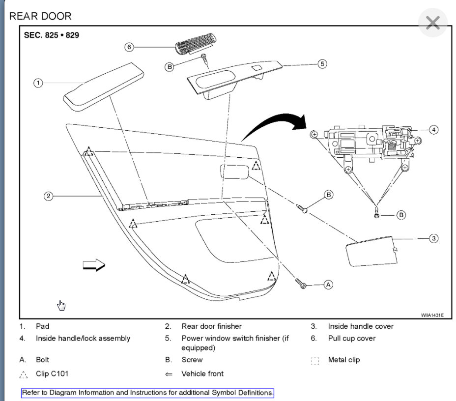

the interior door handle will not work to open the door. the exterior handle does work to open the door. what is the problem? thanks
Oct 12, 2020 at 6:29 PM

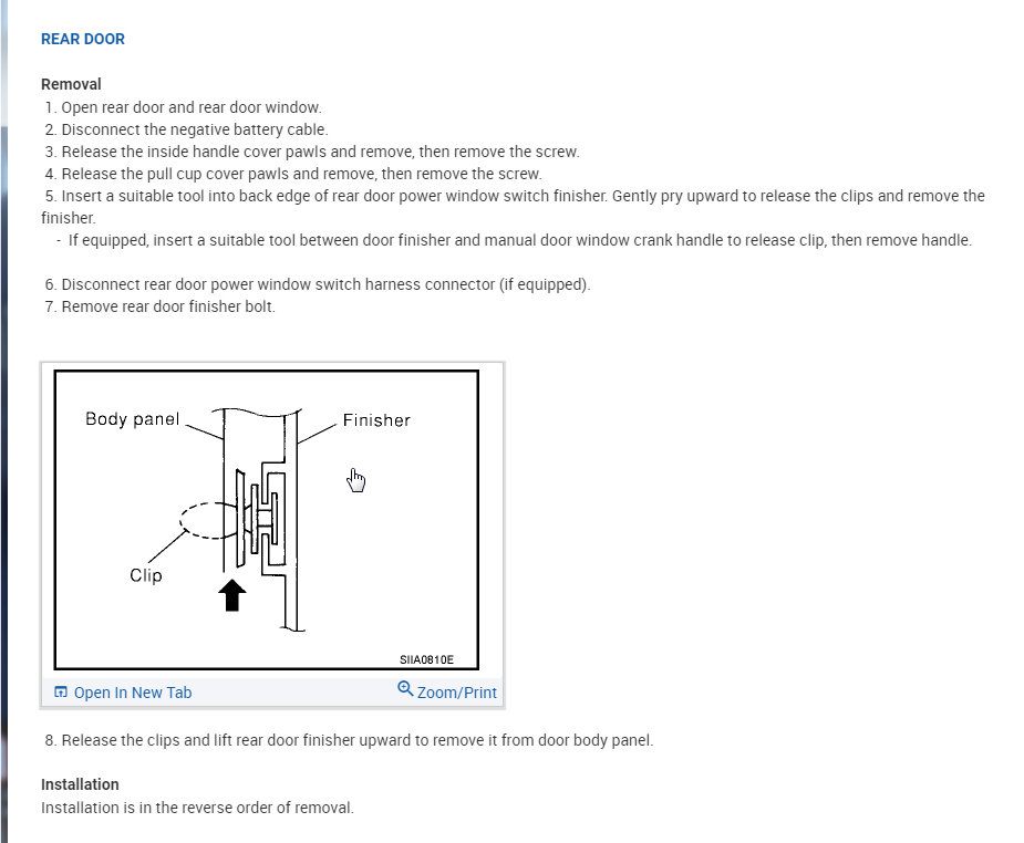

More then likely the cable or rod that connects the door handle to the latch has come off or broken. We need to remove the door panel to test the handle and see if the rod is moving the latch. Here is the process on how to remove the panel so that you can see what is going on.
Also, here is a guide that will help in more general terms:
https://www.2carpros.com/articles/door-panel-removal
Let me know what you find and we can go from there. Thanks
