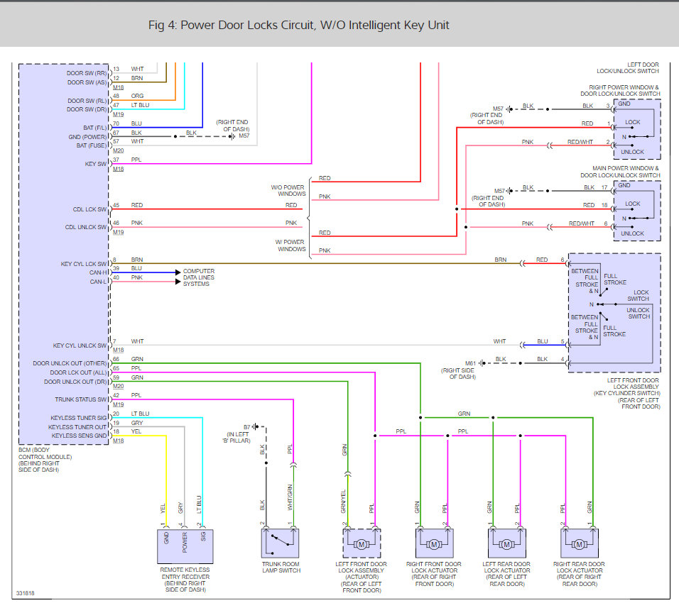

The driver side door lock quit work with the key fob but works with the key. Now all of a sudden the driver side rear door lock is doing the same thing. Could this be the actuators or is there a fuse that controls these?

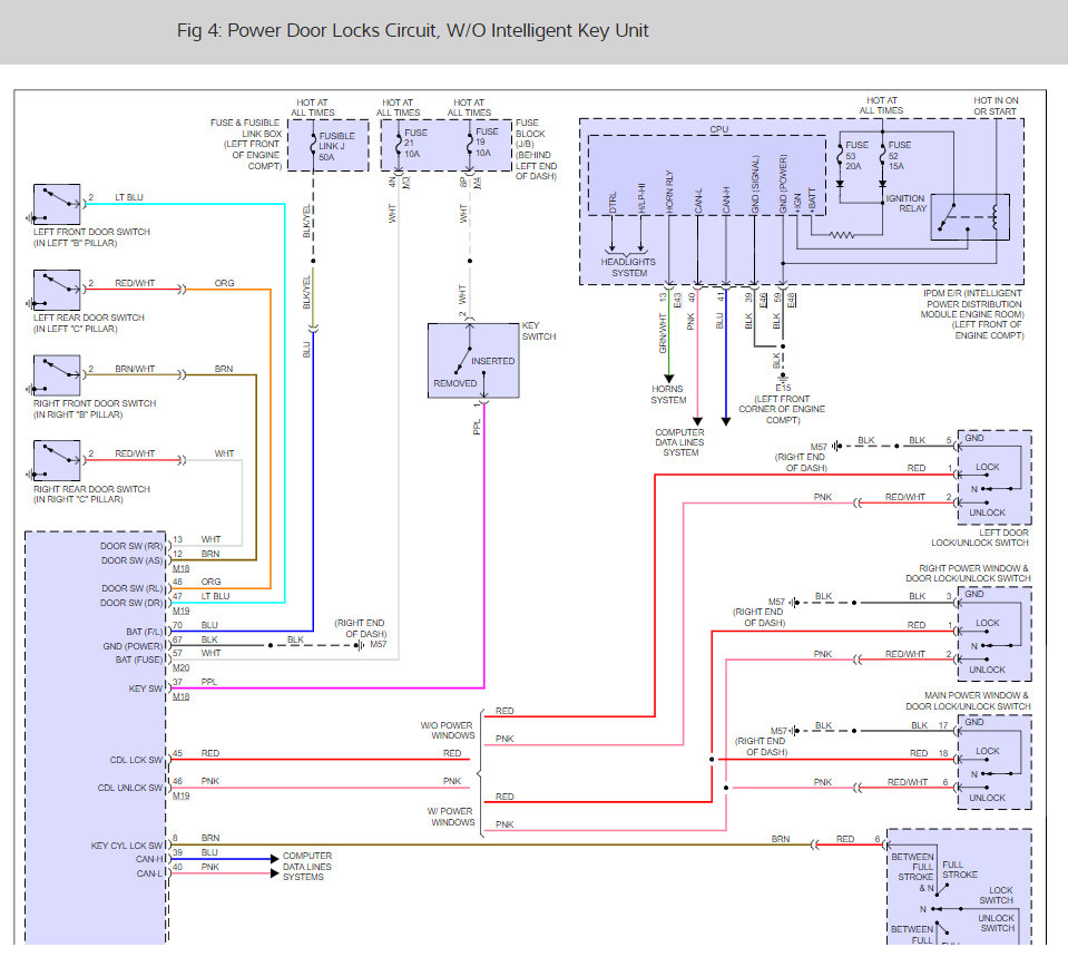

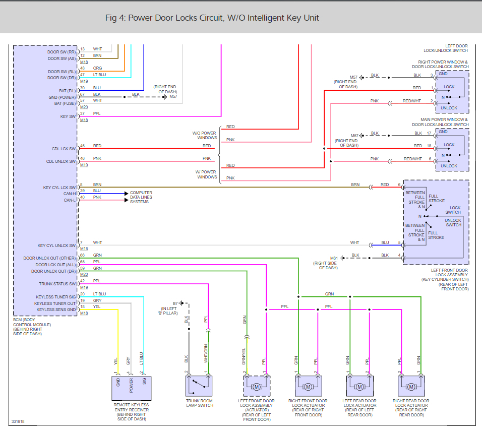

The best way to check this problem is to use a test light which you can then tell if the actuators are getting a power signal.
Here are some guides and a wiring diagram so you can run some easy tests to confirm the actuator or BCM failure.
and
