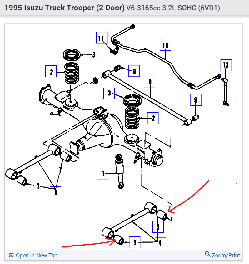

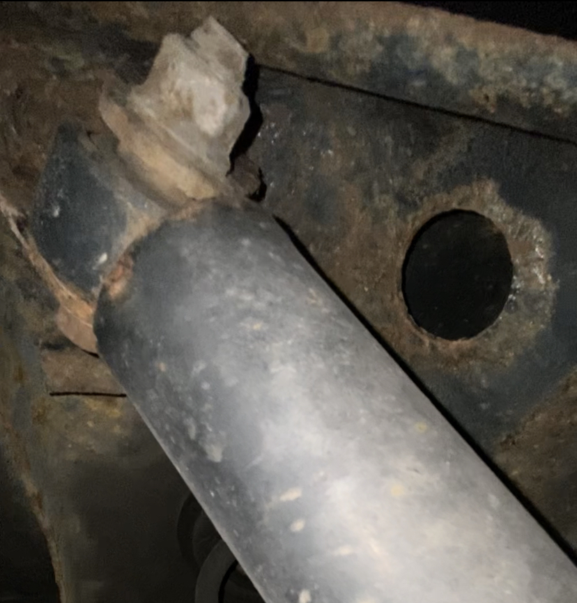

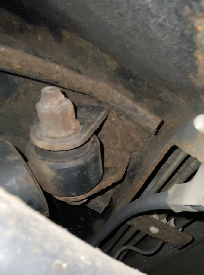

When I floor it from a complete stop the rear differential clunks or shudders until I let off the gas and then it is fine when I ease into the gas. I suspect the pinion shaft and ring gear, but I have zero knowledge of the differential. I want to repair this myself. Any help is greatly appreciated.
Sep 18, 2023 at 7:39 AM
  • 54,832 POSTS

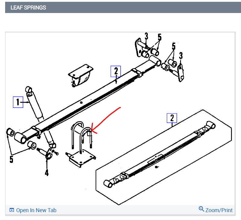

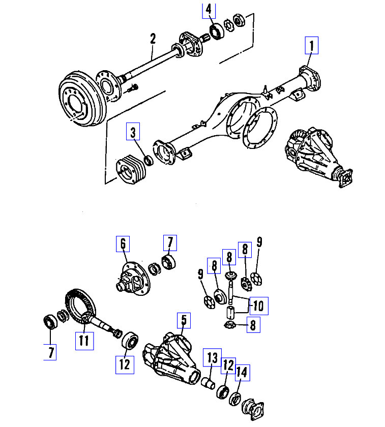

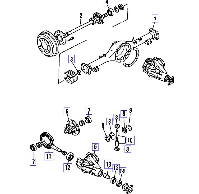

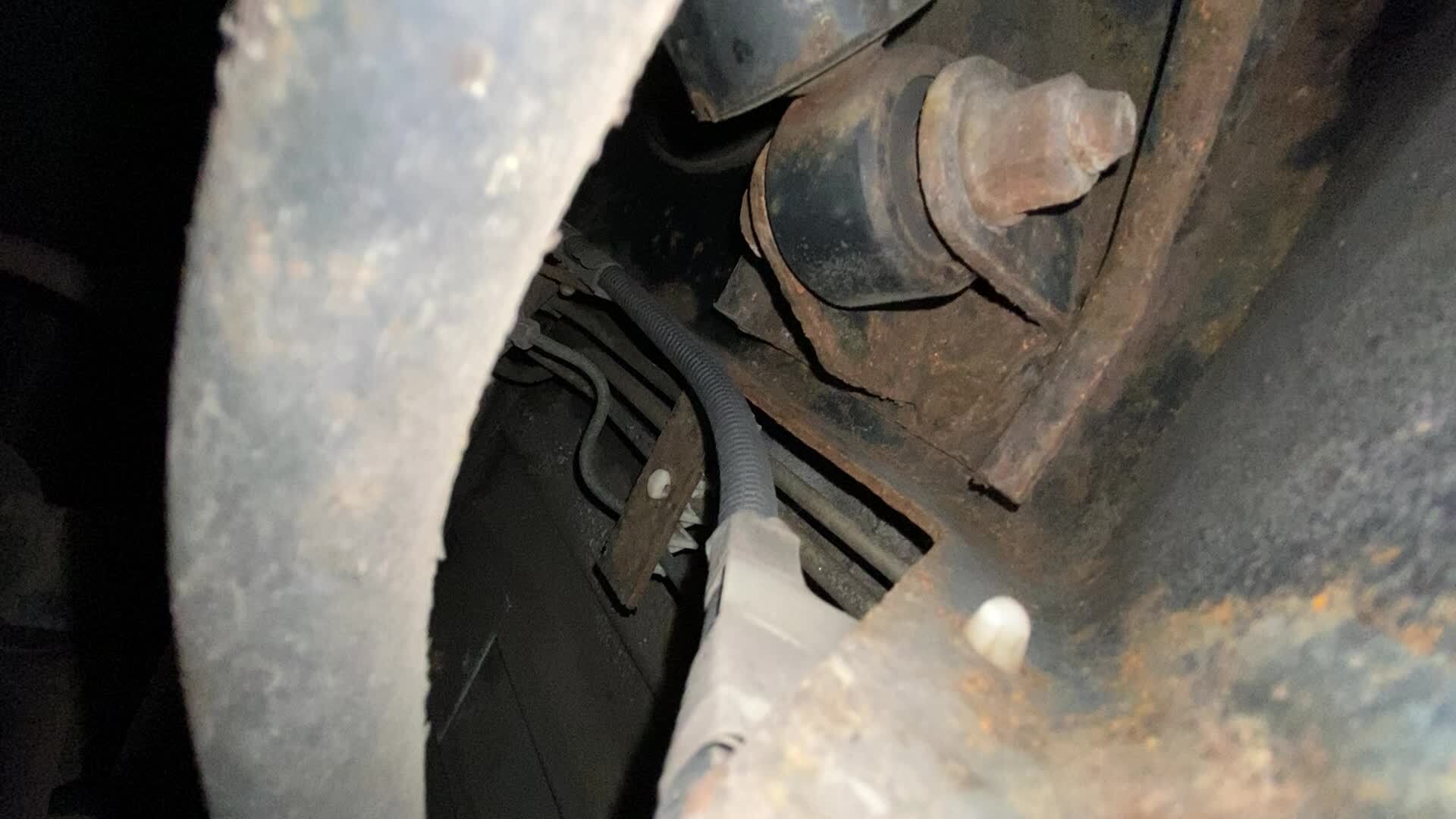

No problem, the first thing I would do is check the U bolts that hold the differential to the leaf springs. If you have coil springs, check the bushings in the trailing arms. Here are the exploded views of the differential and both suspension types so you can see what I am talking about. Check out the images (below). Let us know what happens and please upload pictures or videos of the problem so we can see what's going on.

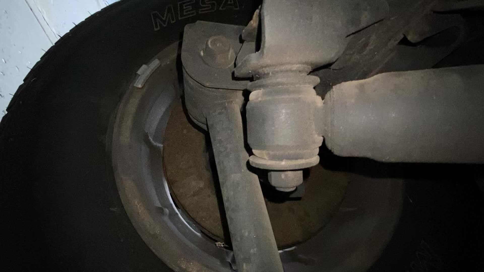

I added some photos and video via my iPhone. Did they not load?

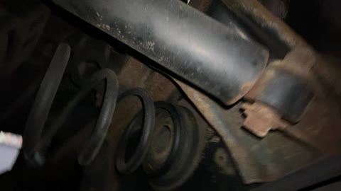

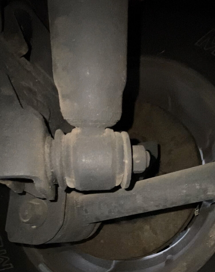

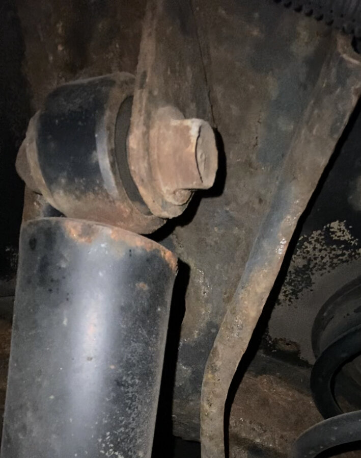

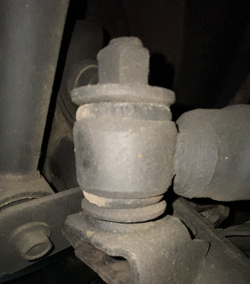

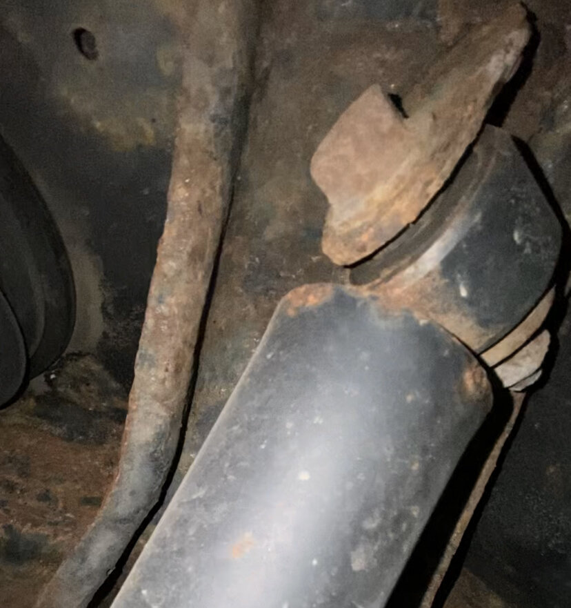

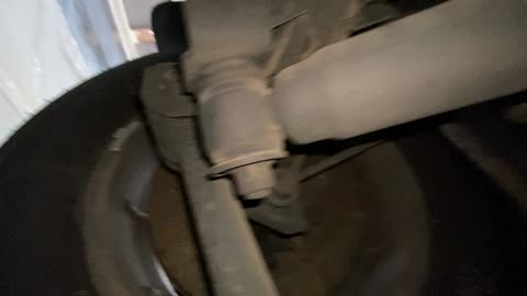

Apparently, they did not load from my iPhone yesterday. I have coil springs and have attached photos and video of the trailing arms on both sides. Although they are old and cracked a little bit, I don't think they would make the kind of sound/vibration/chatter I am talking about.
I attempted to get a video from the inside of the car hoping to reproduce the sound at least and could only get it to do it for a brief second. It was raining when I tried it, and the differential would "chatter" briefly and then the tires would spin on the slick surface due to the rain. I don't know what to think about that. I am stumped.

I accidentally loaded 2 videos of the same side. Here is the other side.

Thanks for the images and video. Yep, those bushing look okay. I had a thought; the noise could be a dry driveshaft slip yoke. Please check out this video to see what I am talking about:

Oh man, that is wild. It sounds like you have a ring or pinion gear that is no good. I would remove the rear differential pumpkin-third member for inspection. Thanks for the video. a noise description would have been tough for this problem. Here is how to remove the unit which means the drive axles need to be removed as well. Check out the images (below). Let us know what happens and please upload pictures or videos of the problem so we can see what's going on.

When removing the ring and pinion and housing will I also need to remove item 2 in the sketch provided? Also, my vehicle has disk brakes and the sketch appears to be drum brakes. Will that make a difference?

So, I went to a junk yard over the weekend and pulled a pinion and ring gear housing from a junked 1994 Trooper. I tried to pull one from a 2000 model Trooper and realized it was a little bigger than mine and the housing didn't look like it would fit. But I wanted to see if it was the same method to pull the housing as the 1994 model, so I kept at it to try to remove the housing.
1994 model removing item "2" from the exploded sketch you provided was only necessary on the passenger side.
2000 model removing item "2" was necessary on both sides of vehicle.
Another thing I noticed on the 2000 model and didn't notice on the 1994 model is that it had both drum and disk brakes on the same wheel. The disk brakes housed the drum brakes. That is the weirdest thing I've ever seen. Okay maybe not the weirdest thing I've ever seen.

The disc or drum brake should not matter as long as the gear ratio and size are the same, did you get the old 3rd member out and is it damaged?
