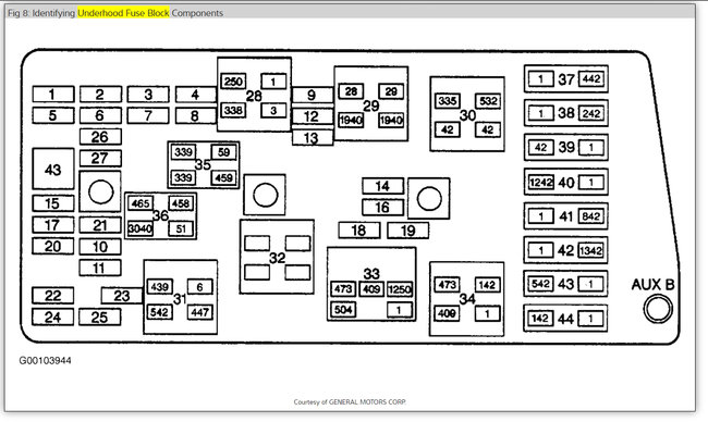

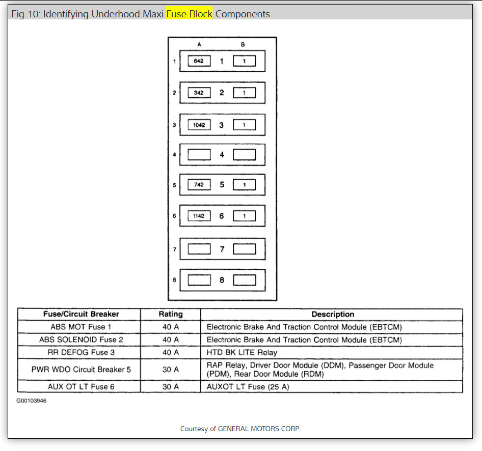

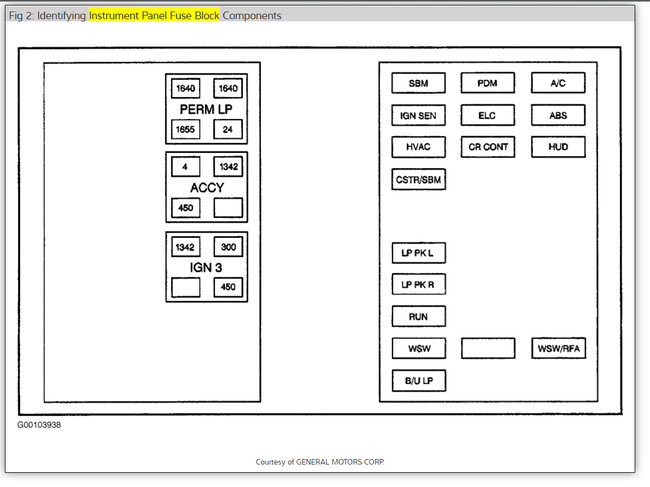

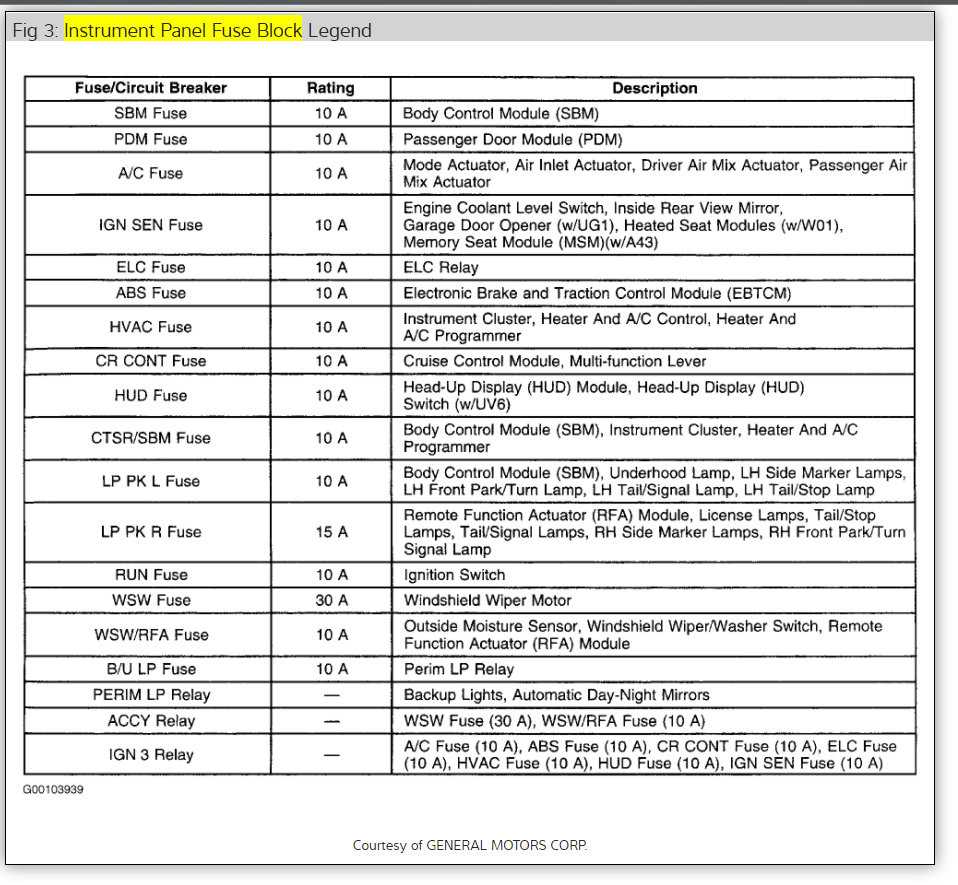

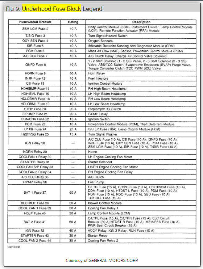

Electrical problems can be frustrating but please hang in there. Lets try replacing the perm LP relay in the behind the glove box relay panel. Here is the location. Check out the diagrams (below). Let us know what happens and please upload pictures or videos of the problem.
Wednesday, January 6th, 2021 AT 11:25 AM
RJC42005
  • 18 POSTS

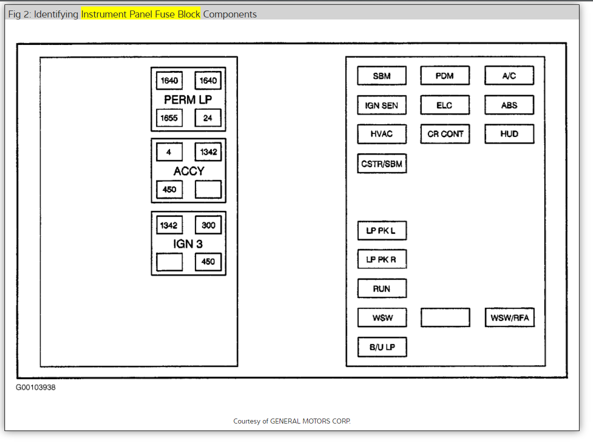

None of the posted diagrams say which one is the one behind the glove compartment.
Wednesday, January 6th, 2021 AT 11:32 AM
RJC42005
  • 18 POSTS
And looking through all the diagrams, I don't see anything that says "PERM ID"?
Wednesday, January 6th, 2021 AT 11:34 AM
KEN L
  • MASTER CERTIFIED MECHANIC
  • 48,363 POSTS
Sorry, its "perm LP" in the first diagram.
Thursday, January 7th, 2021 AT 11:22 AM
