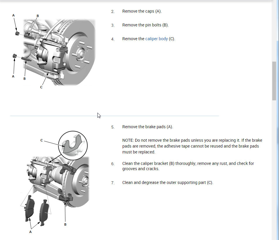

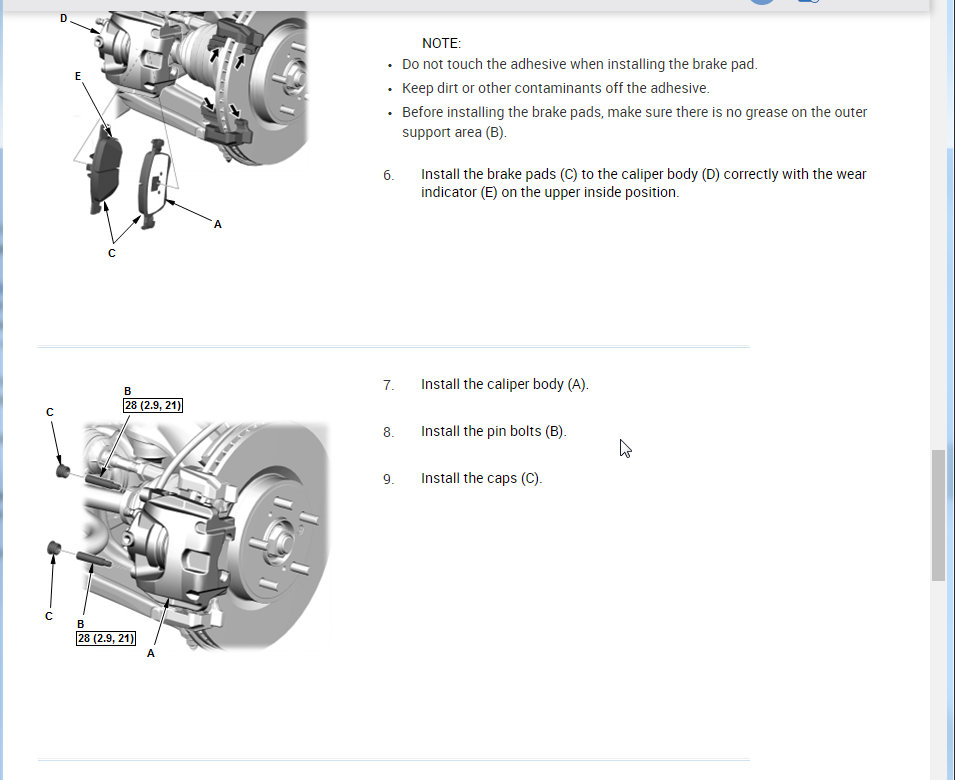

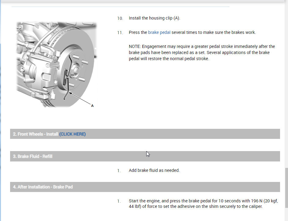

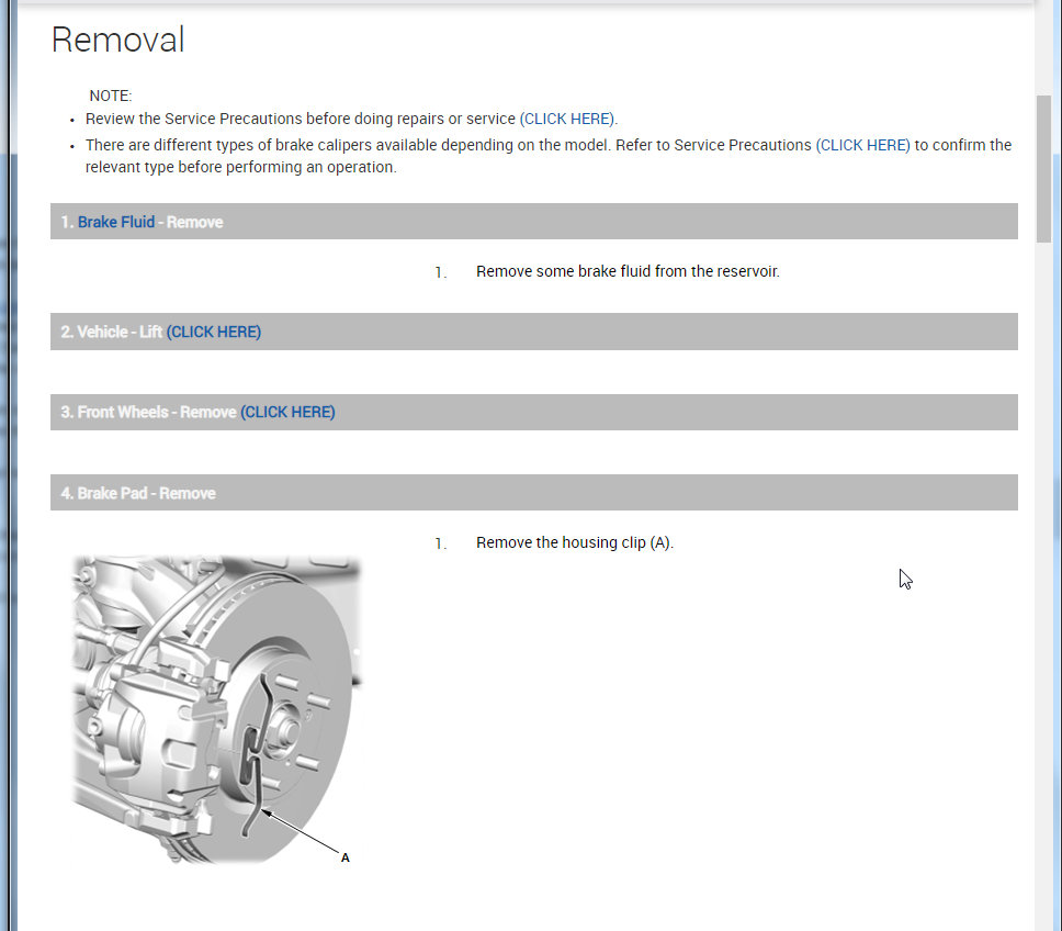

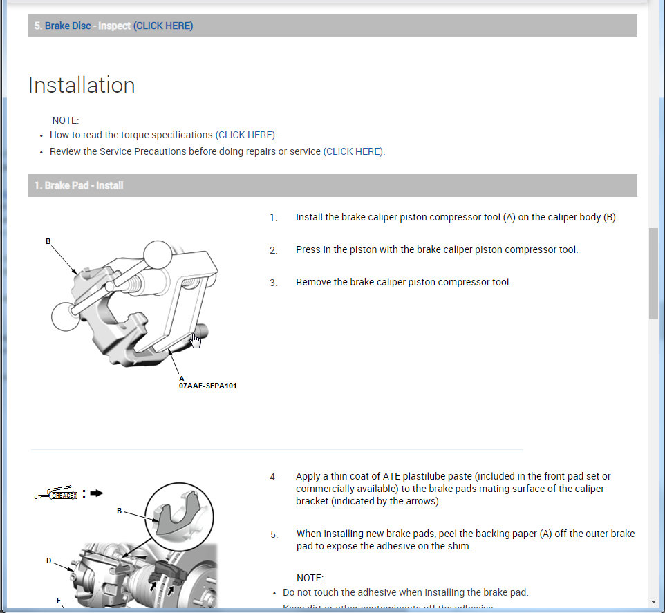

My brakes will sometime screech. Thought it was dirt so I used a power washer but it continued doing it the next day. It’s an on and off type of thing. It’ll start screeching the moment I hit a bump, pot hole, or train tracks. It’s only on the driver side. Should I replace the pads and disks can you help?

I think that would be the most likely correction. Here is a guide that will help with this:
Plus here is a video on a Civic which is pretty similar.
https://www.youtube.com/watch?v=_HrWXRdD2ug
Below is the process from the manual that will help with getting them replaced.
