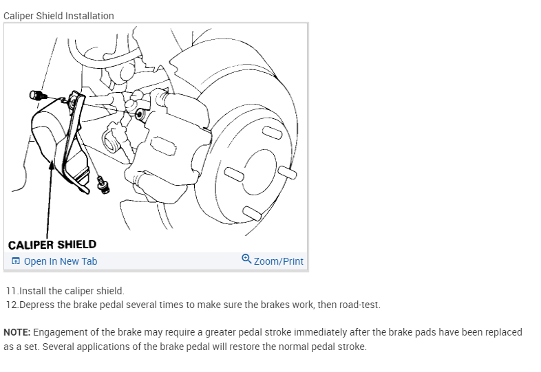

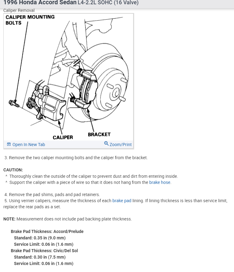

The read pads can be replaced easily in reasonably short period of time depending on your comfort level, using simple hand tools.
Here is a helpful guide:
https://www.2carpros.com/articles/how-to-replace-rear-brake-pads-and-rotors
