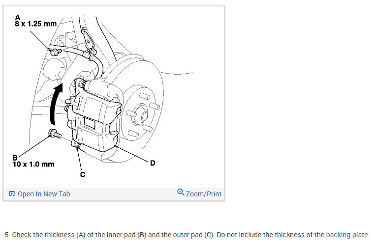

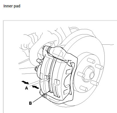

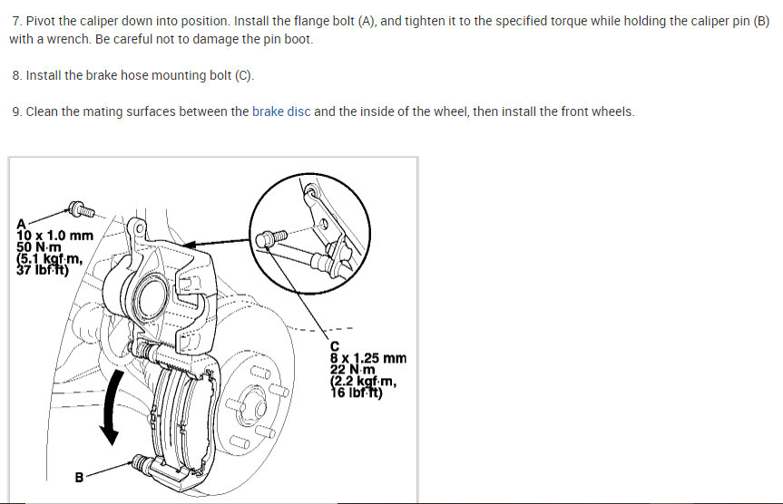

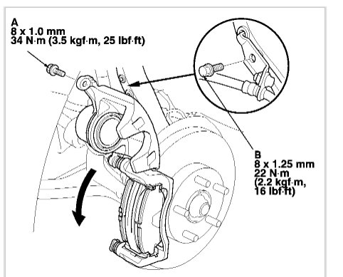

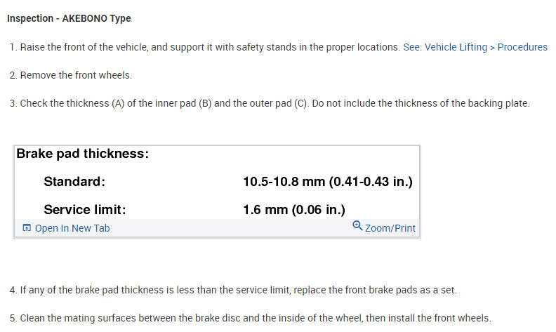

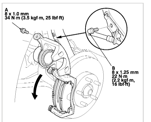

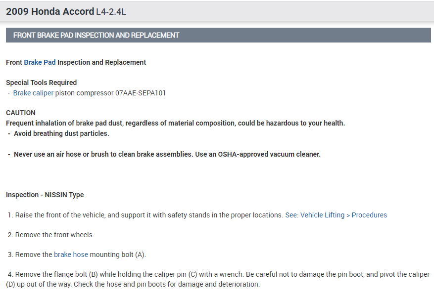

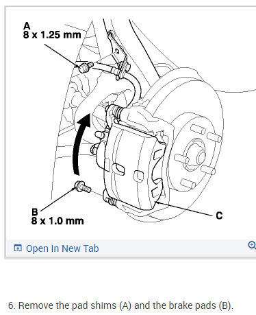

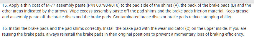

Dear Sirs, I Purchased a new 2009 Honda Accord last year that has a vibration in the steering wheel and seat when stopping. Can you help?
Mar 26, 2010 at 2:11 AM
DANNY L
  • 5,648 POSTS
Hello, I'm Danny.

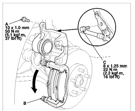

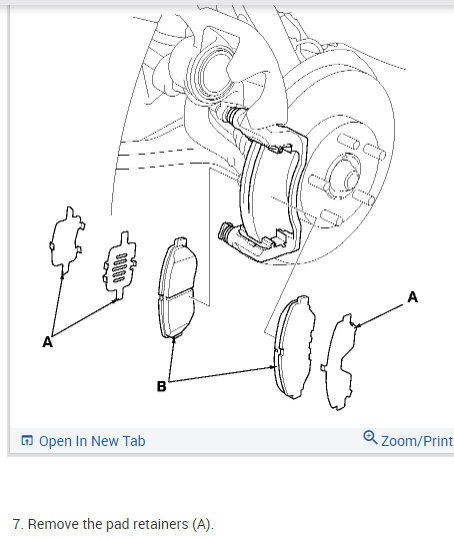

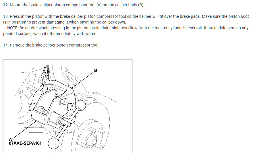

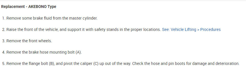

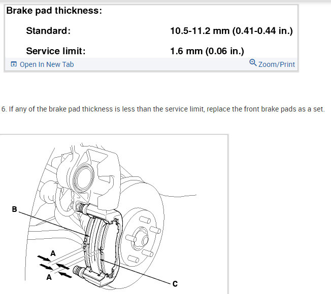

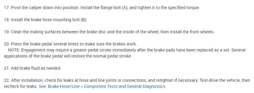

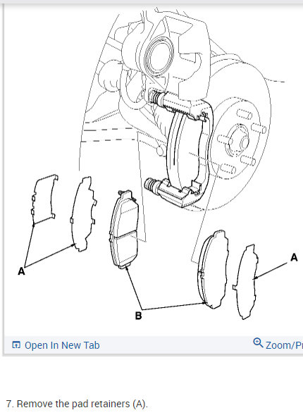

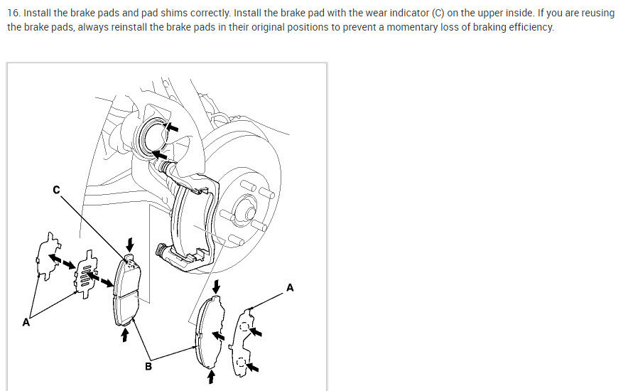

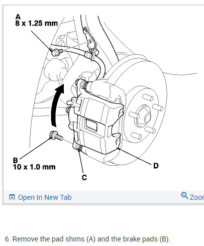

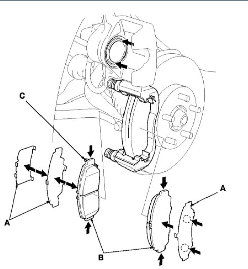

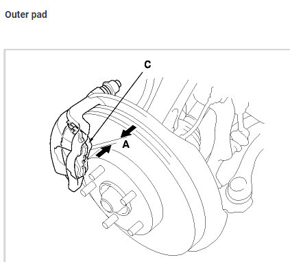

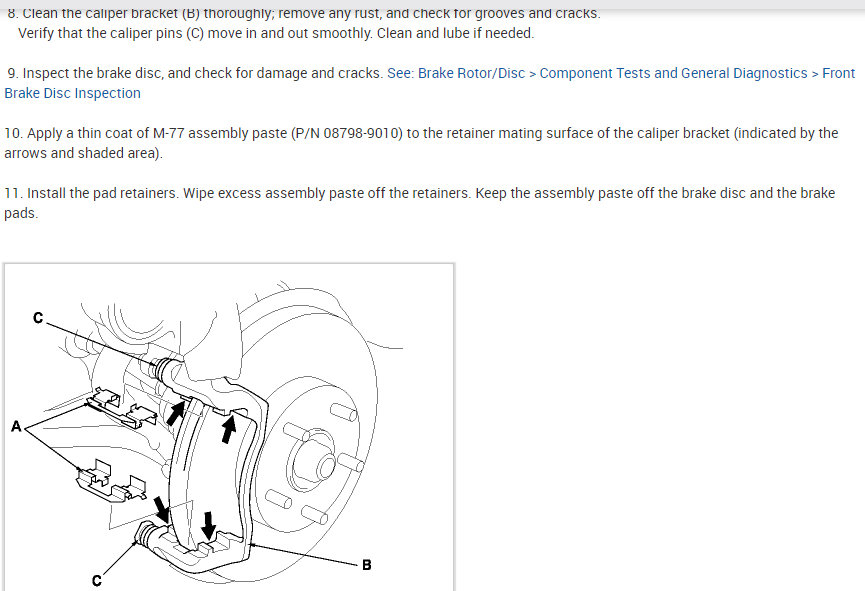

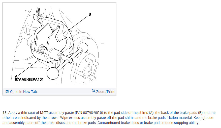

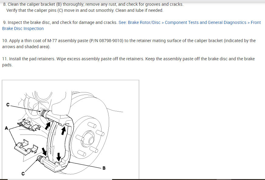

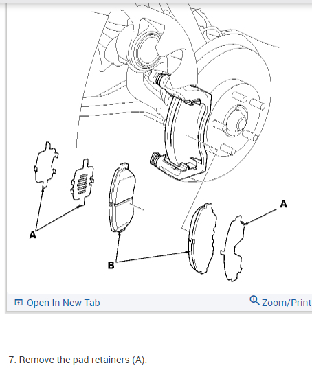

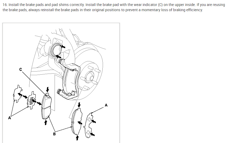

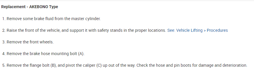

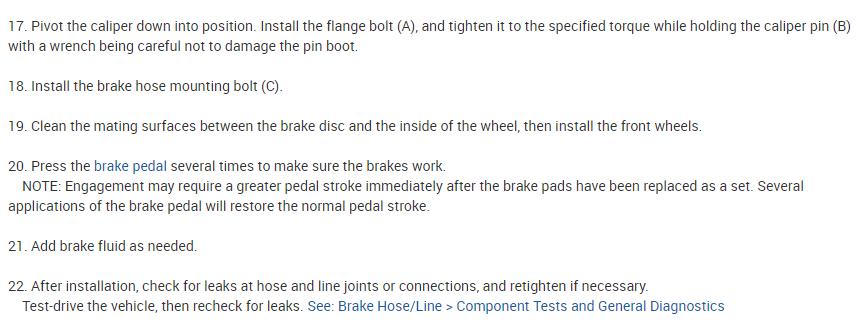

Here is the information you requested. This is a tutorial for you to view on how to change front brake pads:
I've attached picture steps below on how to change the front brake pads on your Accord. Hope this helps and thanks for using 2CarPros
